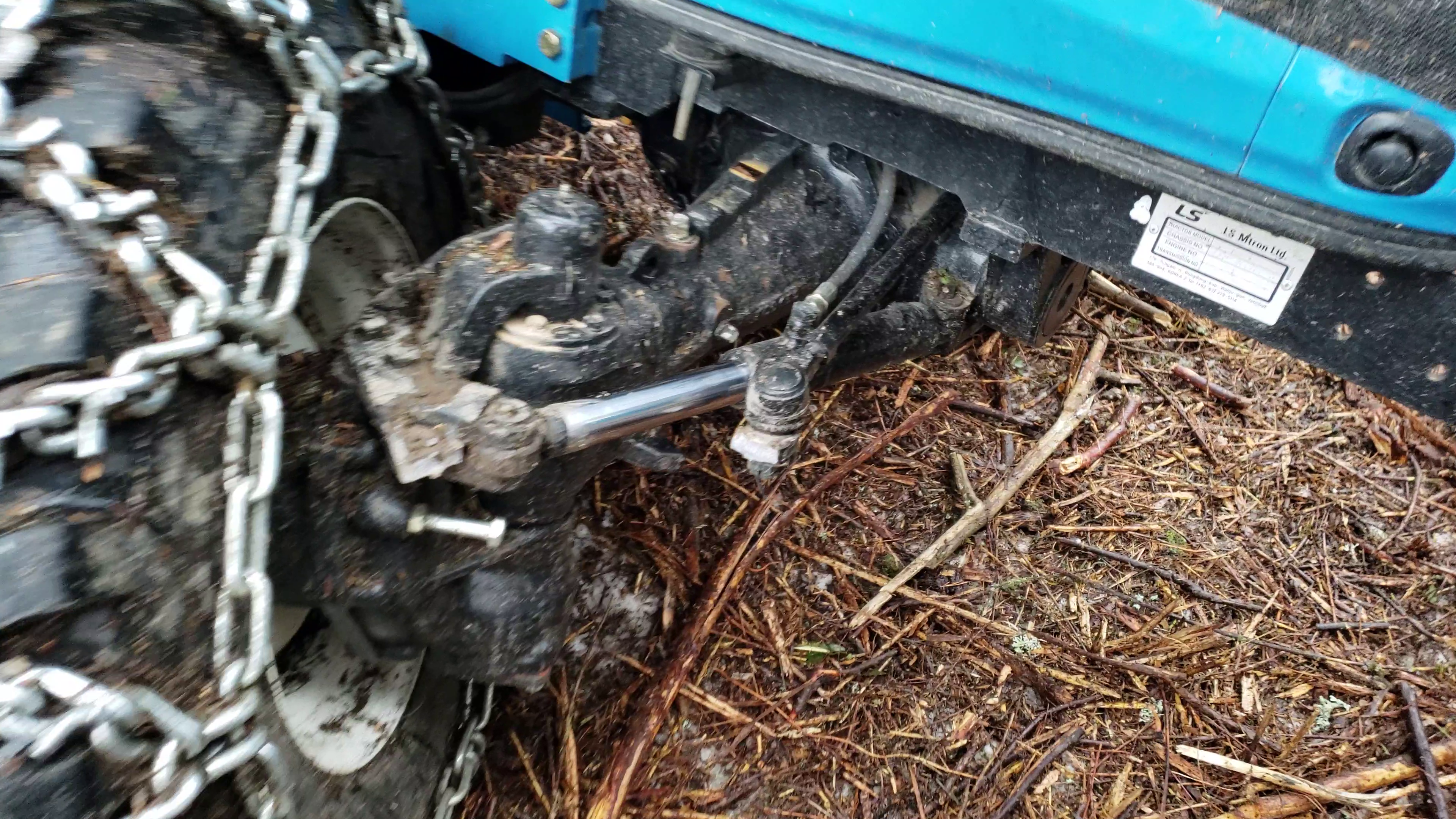

Well I did it. It finally happened. For those of you who do not follow my Youtube videos or know about my steering issues, look here:
https://www.tractorbynet.com/forums...ew-tractor-new-videos.html?highlight=steering
I was out helping my neighbor clear some thick brush on very uneven hill side. This winter, it has been extremely warm and little snow, so we thought it was a good time to get out and make this project happen. The ground is mostly frozen, but there is some snow and mud in places. My tractor steering angle has been fixed with longer stop bolts. I left about an inch or so of clearance from the loader brackets. Well, with chains on, that inch is almost nonexistent, especially while turning over rough terrain.
Well, the tire got bound up and before I could stop something made a SNAP! The right-hand steering arm snapped at just about the tie rod hooks in. The hydraulic pressure pushed both tires out since they were not connected anymore. This obviously brought work to a stop.
Being a Saturday, the LS dealership was closed. I jumped on the interwebs to see what this arm will cost. I found a New Holland replacement part from Messicks for about $250 shipped. I just about ordered it, after all, I am not a fan of leaving my tractor on a hill side broken down on someone else's property. I need this part yesterday! However, I decided to wait until I spoke with my LS Dealer. I called him first thing this morning and he quoted me $130 shipped... but it's under warranty so no cost to me! YAY!!
It should be an easy repair. I just need to pop off the old one, check the bearing and seals (The dealer got those for me too) and install the new one. Add a bunch of grease and away we go. The only issue I am seeing is getting the tire back into place. I am thinking that I crack the hydraulic hose on the steering cylinder to bleed off pressure and use a ratchet strap (if needed) to pull it back over to the tie rod. Oh! I do the warranty work, forgot to mention that.
The parts should be here in about 5 days. When they get here, I will make the repairs and film everything. So watch here and my YouTube Channel for updates!

To align the wheels back up you are correct, just crack the hydraulic line open and you can push the wheels back into alignment. I broke my tie rod bracket and used a ratchet strap to keep the wheels straight so I could move it and load on a trailer.

Thats what I figured. That steering cylinder is kinda odd. It only has a supply line, no return. I assume it is because of the tie rod, the cylinder must have some way to return the oil when the other side pushes out. I figure if I'm able to bleed off the pressure though the fitting, force it over to alignment, it should be okay. Might loose a bit of oil, but thats nothing. Slightly concerned about introducing air, but that should work its way out too, I hope.

Well, here it is! A new video up showing the damage and repair job.

The parts took two weeks to get here due to some weird storm in the mid-west apparently. The dealer told me when we ordered them that the parts only take about 4-5 business days to arrive. Oh well. But during that time, a storm of our own came though and dropped about 6in of snow on us. During the winter, the tractor is my primary means of plowing (secondary and what I used last winter before the tractor was my 4-wheeler, which died and needs to be replaced this spring.) My wife drives a little two-wheel drive POS "SUV" that cannot make it up the driveway when there is the slightest bit of snow or ice. So, she has been parking and walking the 100 or so yards up the driveway. Once, she even slid down and 'backed' into a snow bank and broke her tail light!

Anyway, I was able to replace the arm without much trouble. I did a time lapse of the repair using my new GoPro. Unfortunately, I totally forgot it while filming. My plan was to show the new part as I assembled it, but it is rather straight forward. Let me know what you think and thanks for watchin!

Nice video. That's a pretty thick piece of cast and my thought was maybe it was just a bad cast??

Not sure exactly what happened. A commenter on the video pointed out it may be due to the longer steering bolt stops I put in. That the stop bolts are hitting with throw left in the steering cylinder that keeps pushing on the arm causing unnecessary wear and stress. This makes sense to a point. If hydraulic pressure is exerted on a tab or fitting that is being stopped by pressure from a bolt or something, over time something has to give.
However
Two thoughts come to mind about this. If this were true, then any adjustment of the stop bolts would break that tab. If you shorten the stop bolts, the cylinder would bottom out, not requiring the need of the stop bolts. If you lengthen them, then it would break the tab, and that design would be recalled or rejected.
The other thought I had is how the steering cylinder works. There must be a by-pass or something that allows fluid to return from the cylinder. This is why I had to crack the fitting and bleed off pressure to move the tire back into alignment. There is no return line on those cylinders. There is a push/pull type of thing going on. If the other cylinder was pushing against the tie rod (that broke) and the other cylinder that is not receiving fluid, and came up to the stop bolts, that bypass should initiate. This would put pressure against the stop bolt but not tons of force (if that makes sense) and everything should be able to withstand that pressure.
I guess there is a third reason too. When the arm broke, the steering cylinders pushed the tires way out, to where they were completely jammed up against the frame. Much tighter than they were with the old stop bolts. Keep in mind, the stop bolts were useless when this happened. If longer stop bolts were the cause, then any bolt (or even no bolt) would cause this to break. The steering cylinder has much farther to go. They were not bottomed out, least not that I was aware of. Just so tightly jammed up that they were impossible to move.
What are you thoughts on this?
I think it broke because I was (still am) wearing chains that articulated up during a turn and got bound up and snapped the arm before I could stop. OR faulty casting in the arm that just happened to break right there. OR it is something that I caused with the stop bolts. OR something else entirely??
Thoughts?

When you make a turn one cylinder is pressurized and the other returns to the tank. That is all done in your steering valve. Since these are single acting cylinders one needs the other to retract. When yours broke, if you turned the wheel both ways you pressurized both cylinders extending them until they reach their internal stop.

Exactly, what I was trying to say.
The more I think about this, the less I believe it was the steering stop bolts that could have caused this malfunction.

I think I broke mine on my xr4046 by bumping the right wheel, while turning, into a dirt pile. There were no stops on the right side, so it pulled the tie rod against the flange on the left side, against the stop and broke the flange. That is just my guess. It broke twice in the first 50 hours. The dealer installed a new housing on the right side that had the provisions for stops and installed stops on the right side. I have over 300 hours now with out any more flange failures.
