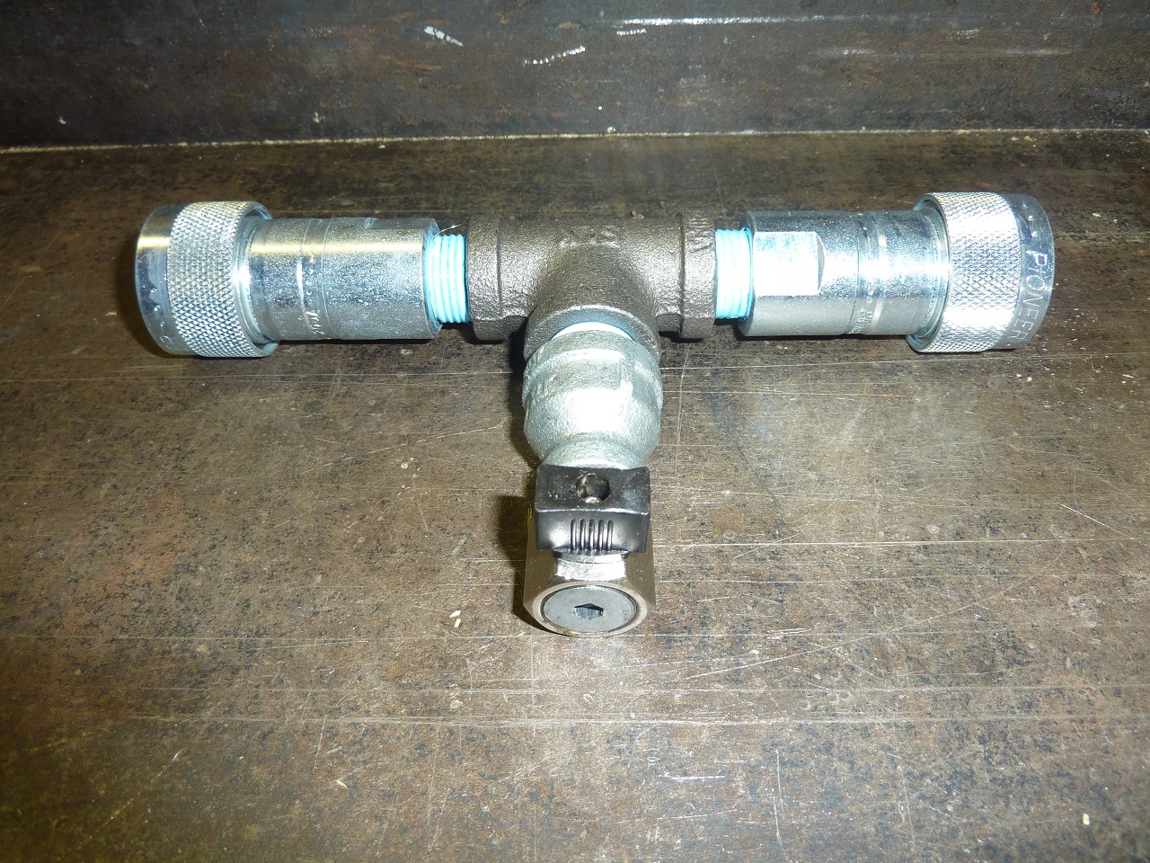

I connect a home made manifold to the hoses of my backhoe and other hydraulic implements when not in use.
Any pressure buildup is easily eliminated by opening the valve. The expelled oil is easy to collect without making a mess.

In post 9 the tee and an adapter look to me like normal pipe fittings. If they are, not rated for the pressure of a hyd system.
   / Reconnect Hydraulic Line to Backhoe #13
True, but the manifold is designed to hold the QDs when the lines are depressurized & keep them that way. So there should be little to no pressure on those plumbing fittings.
