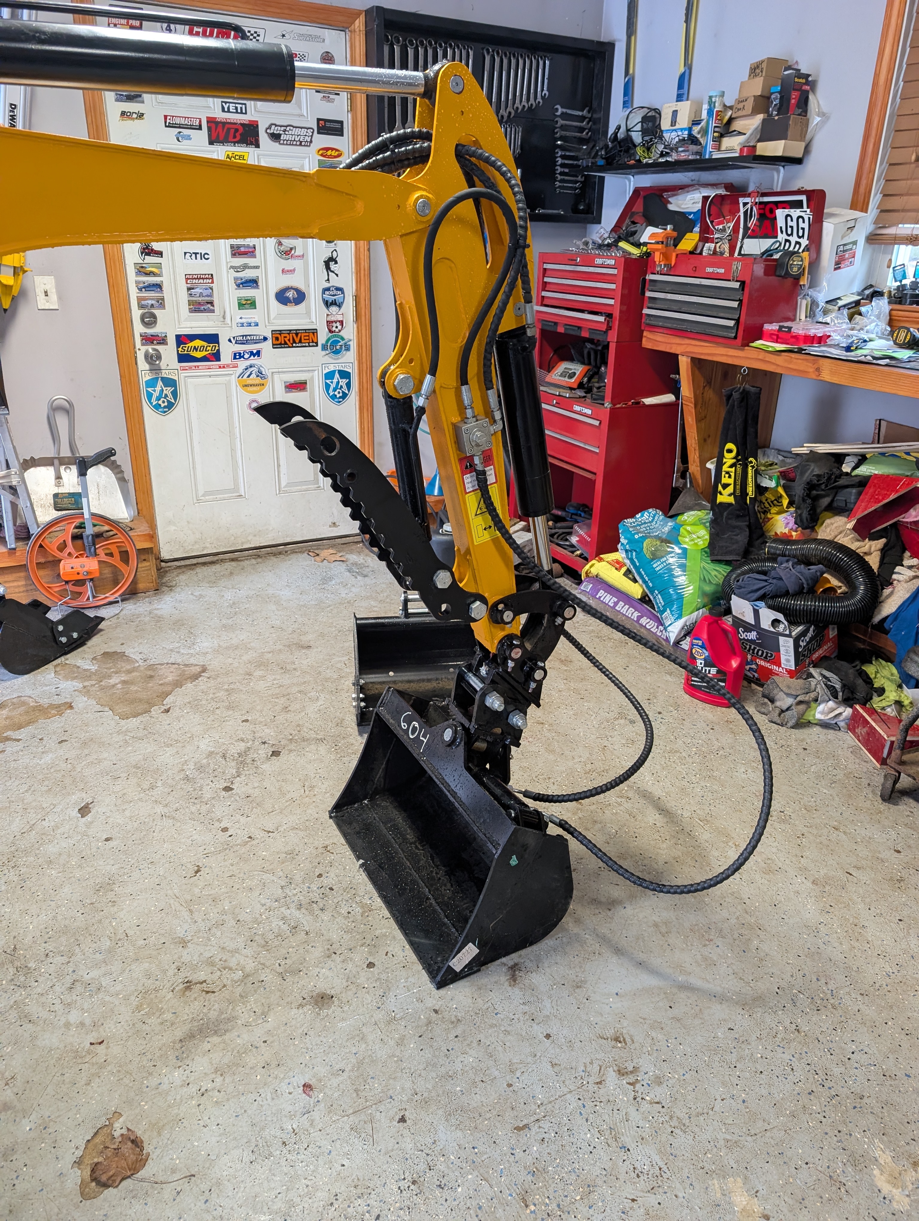

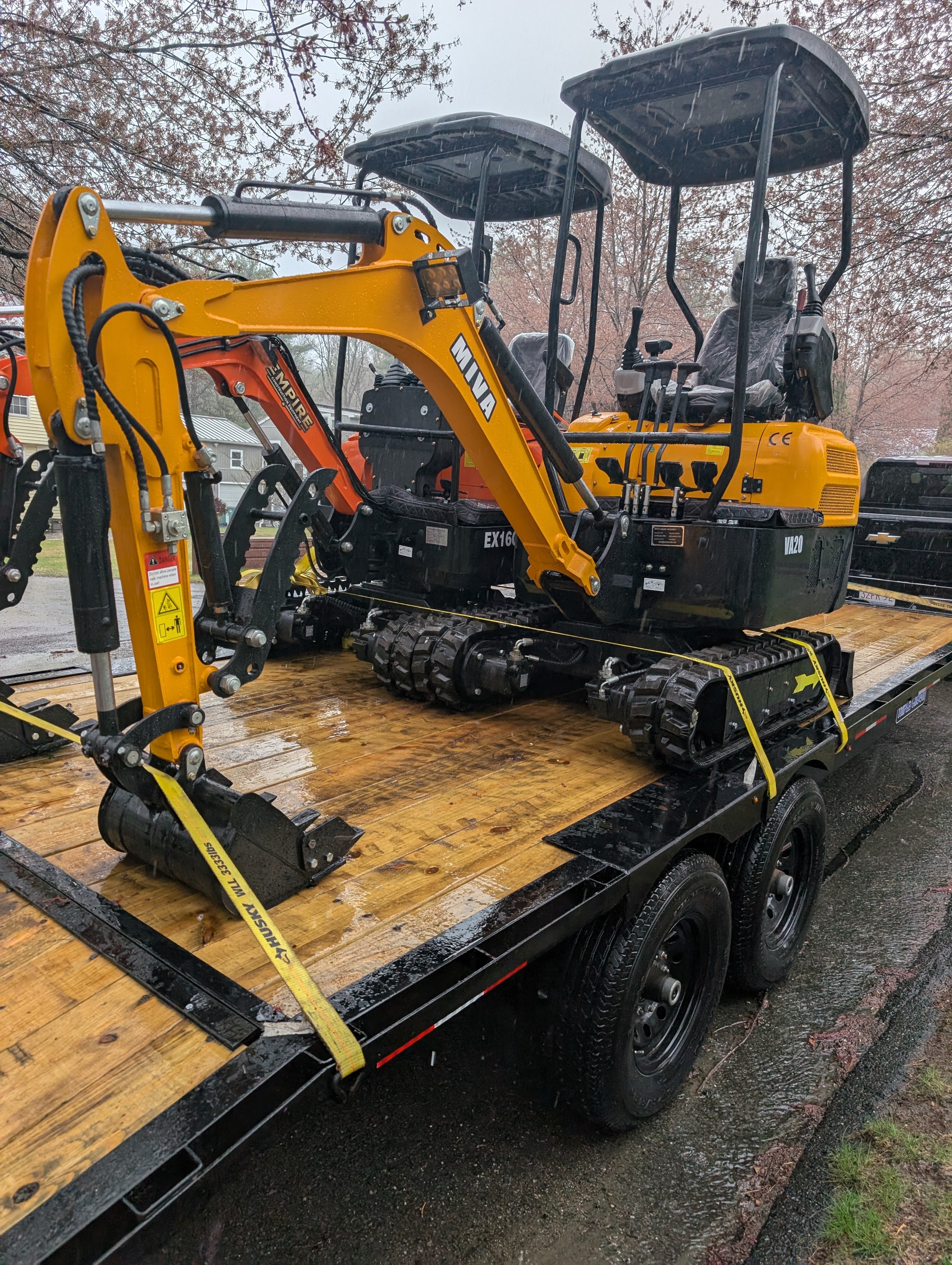

So I found a Miva VA 20 which seems to me is almost the same as the Terrors. 2 Ton, piolet controls, hydraulic thumb was able to get a 24" tilt bucket which I had coming with Typhon order also the Kubota D902. I'm into it for $14,3 delivered to my door.
Found it from a dealer in MA Empire Construction. Worked it out last Wednesday and he delivered it this past Saturday.

Congrats on the new digger!
I don't know that brand but a cursory look at the pictures, it looks like a good unit. My only comment is it would be good to figure out the articulation needs of the tilt bucket and find a way to tie back those hoses so they are not as likely to get caught on something.
   / “Terror” Chinese excavator #25
Nice machine - it looks pretty much like the Hightop HT20 model. I used bungee cords to tie to the boom - also point the 90's up on the bucket. I found the bucket moved too fast with the foot pedal so I throttled the valve back to about half, made it slower and more controllable.

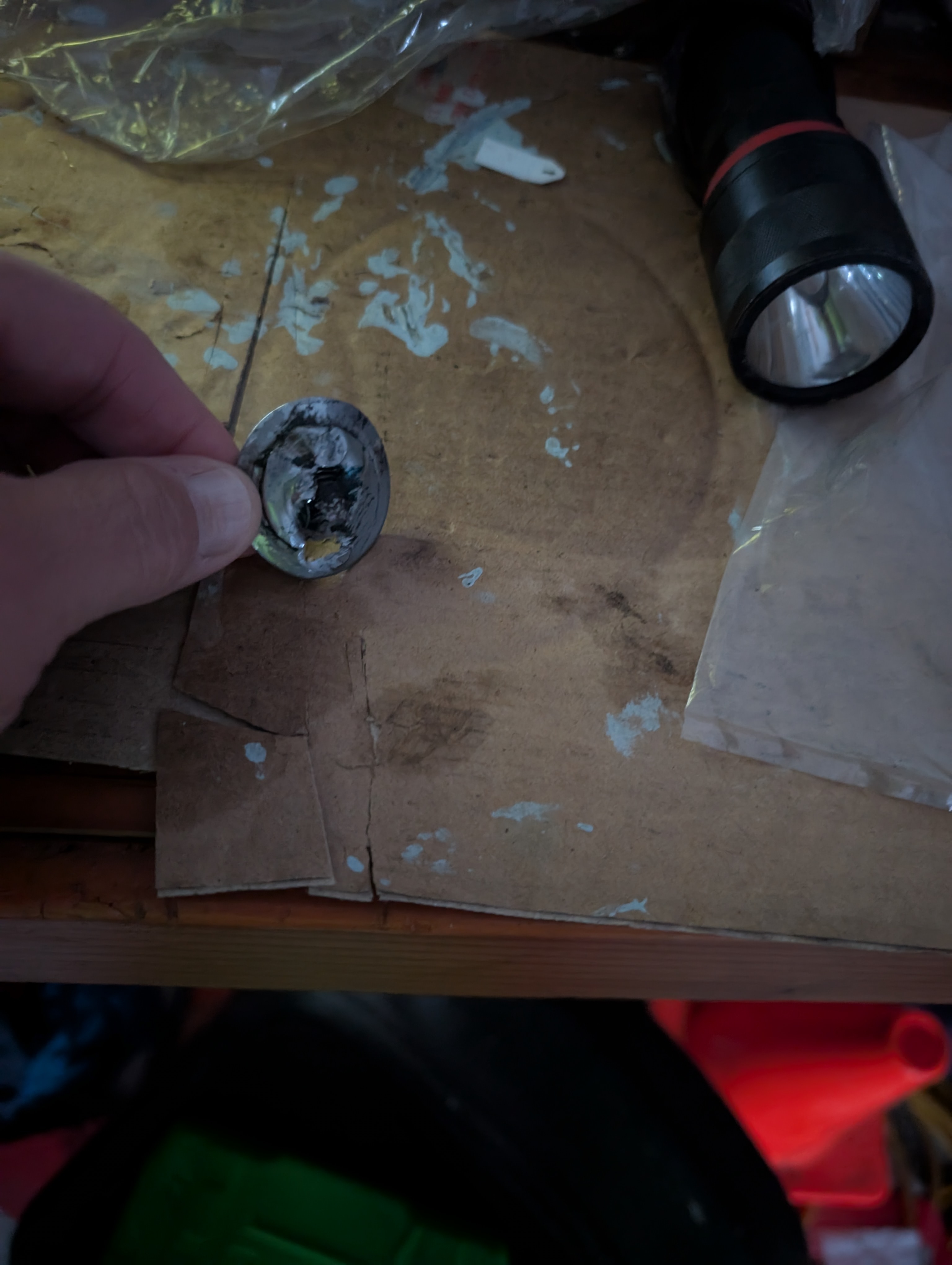

Anybody recognize this bolt with large washer. While swinging with the Miva VA 20 I heard a metal crunching noise and then went away can't seem to figure out what it was. Then when loading on trailer at the end of the day I found this bolt on the trailer bed.

ML88 - hard to tell from those pics - what does the other side look like? Seems to be the head of a bolt that sheared off. I would start but looking at the swivel mounting bolts - they could have loosened and sheared off one of them.
The swivel motor is bolted from the top with large allen head screws, so they would not fall out. Were you swinging with the boom or the swivel motor I presume the swivel motor, and if a bolt came out of that bottom plate it could get sheared off I suppose.
Also your signature lists a Typhon Terror XVII but you were running a MIVA 20? They appear to be similar

Hi Carl NH I originally was getting the Typhon Terror XVII but with the teriffs interruptions I had to take a refund and ended up finding this Miva local. Thanks for the thoughts im going to try and locate the swivel mounting bolts and see.
