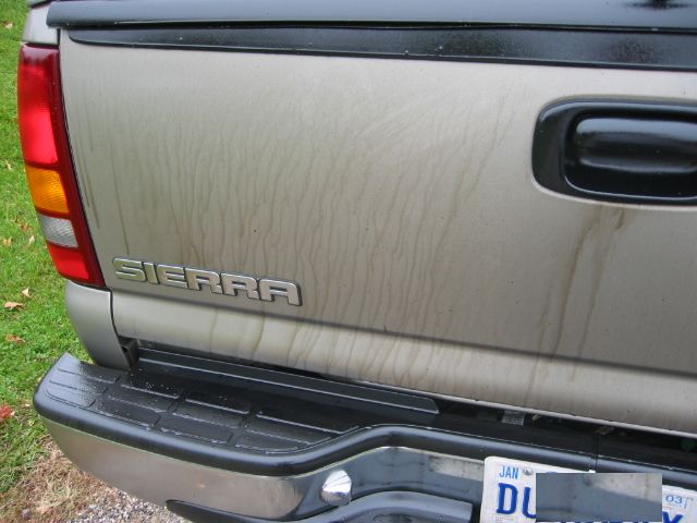

I too have been at the Diesel page since 2000, That said, from you reading there (or maybe not) you know it's coming (or maybe not). Just a matter of time and trash. The LB7 was doomed from the get go on many of the less than stellar OEM suppliers for the injectors. Just speaking from my personal experience and the testimony of 100s of others at the Diesel Page. That is a top notch forum for info, as you stated. Thus the injector issue is real.
Best of luck to your LB7 engine. When it dumps while out on the road, it's not a pretty sight. The spillage gets all in the wiring harnesses, all under the truck throughout the entire undercarriage and within days, you'll see the frame turn to a rust coated bare metal. The diesel eats all of the coating off. This machine is a 2001 LB7. I traded it at 58k on the second set. Got a 2002 LB7. Traded it at 98k and it was on it's 4th set. The real pain is not the failure, but finding reliable replacement parts. an experienced Duramax mechanic, GM's willingness to cooperate, and the many weeks / months (literally) of downtime while it's in the shop. Parts are slow and now hard to find. Happy dieseling... I wouldn't have another one if you paid me to take it. I bought an LBZ last year 2007. So far, so good. Mileage is like always in any of them that I have owned... ~15 MPG.

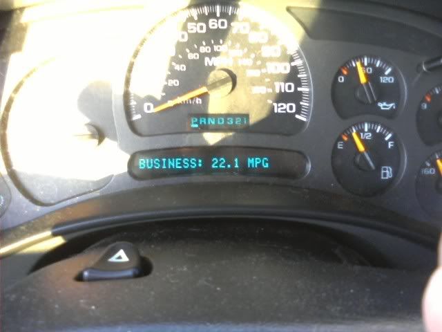

Just completed a trip from Chardon Oh to Salt Fork Oh. yesterday. The truck said 22.1 mpg, which is usualy not dead accurate, but in the ballpark. Normaly hand calculating shows the truck reading 2 to 5 tenthes better than actual. I have not gotten fuel yet, so have not had a chance to hand calculate it. I will fill it up tomorrow and post the results of hand calculation.
