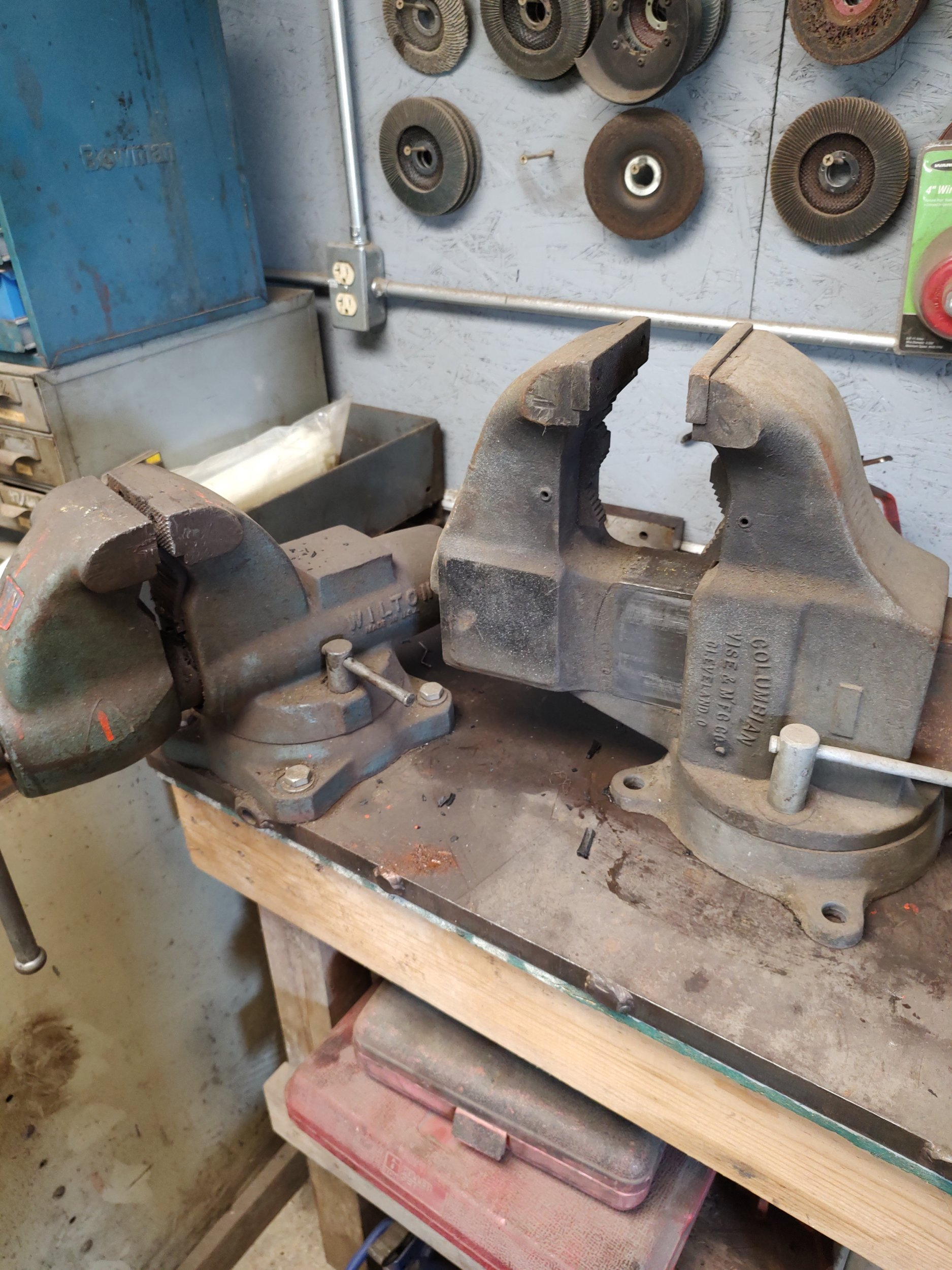

I have an old Columbian vise....5" jaws 8" opening. Here it is next to my Wilton bullet for scale.

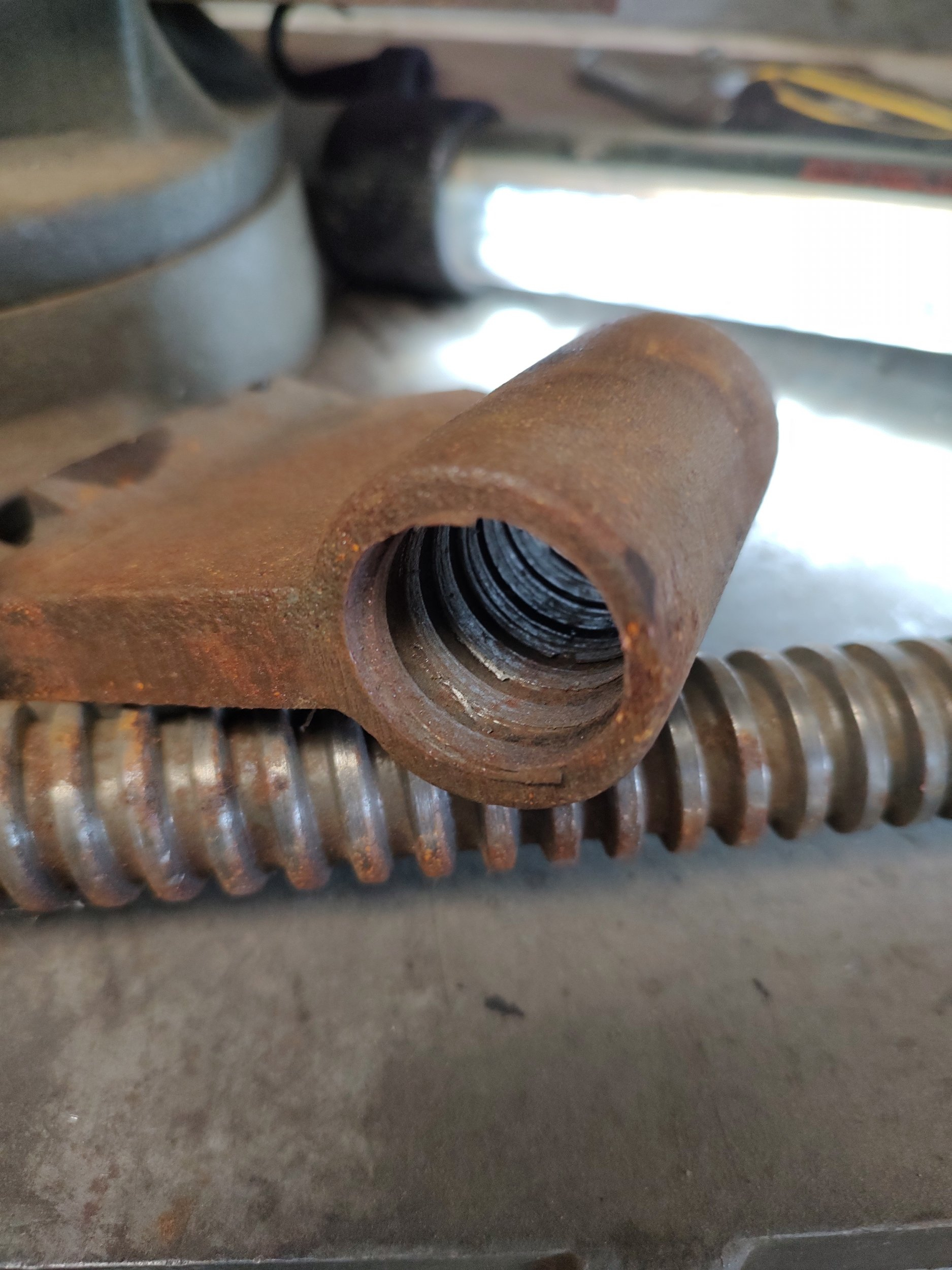

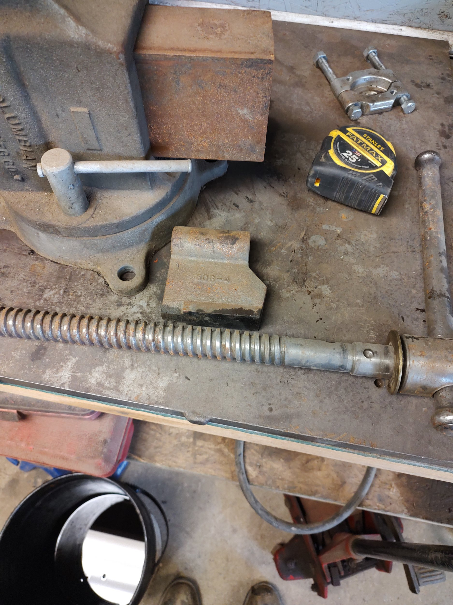

The issue is the cast piece that is threaded is stripped. But the screw is good. I have kicked around the idea of making a new screw and matching threaded block....but if I could find a tap to cut 1-1/8" x 3 acme threads....I only have to remake the block.
The part is stamped 506-4 and can't seem to just source a new on either.
Anyone got any ideas on a tap before I resort to making both a new rod and block

What is puzzling is I cannot even find a reference for 1-1/8 3tpi threads of any kind.
Usually you can find some info online for even old obsolete thread types and pitches. But. Coming up empty completely. For 1-1/8 acme....it seems 5 tpi is the common coarse thread.
I've measured and remeasured thinking I was overlooking something.
In all my years of wrenching, machining, etc....this is the ONLY thread I cannot find any info on.
Going through McMaster Carr, I can get a 3' stick of acme 1-1/8x5 thread rod and a coupling nut for about $70 for the pair.
Might do that and use the coupling nut to remake the anchor block

Nope, I am not sure of anything other than it's 1-1/8" diameter and 3 threads per inch.
Can't find any types of threads that match that dimension let alone find a tap for it

Just remake the anchor block with the coupling nut. Especially since you need to make a new one anyway, no matter what thread is in it. It's pretty obvious that the original thread was a special. In my years of machining I have had many jobs that used non standard threads. Threads like .250-96 and .250-80. Those are some fine threads for such a large diameter. I have a drawer filled with special taps that I had made for me. Turning a 1 1/8-3 acme tap through steel or cast iron would be tough to do anyway. That's a big and coarse tap. You could also single point the thread. It wouldn't be that hard to do if a narrow tool was used. Just set the compound parallel to the ways on the lathe, thread out to the major diameter, and then start over but advance the tool a little bit. Do this a few times until the thread is the proper width. I have used this method before. It is slow but works. I have even done it in CNC lathes, but it is much faster that way.

Without measuring the screw, we really don't know if it is an 29deg acme, a 29deg brown & sharp, or a modified acme etc. We would need root, crest, angle, and thread depth measurements.
