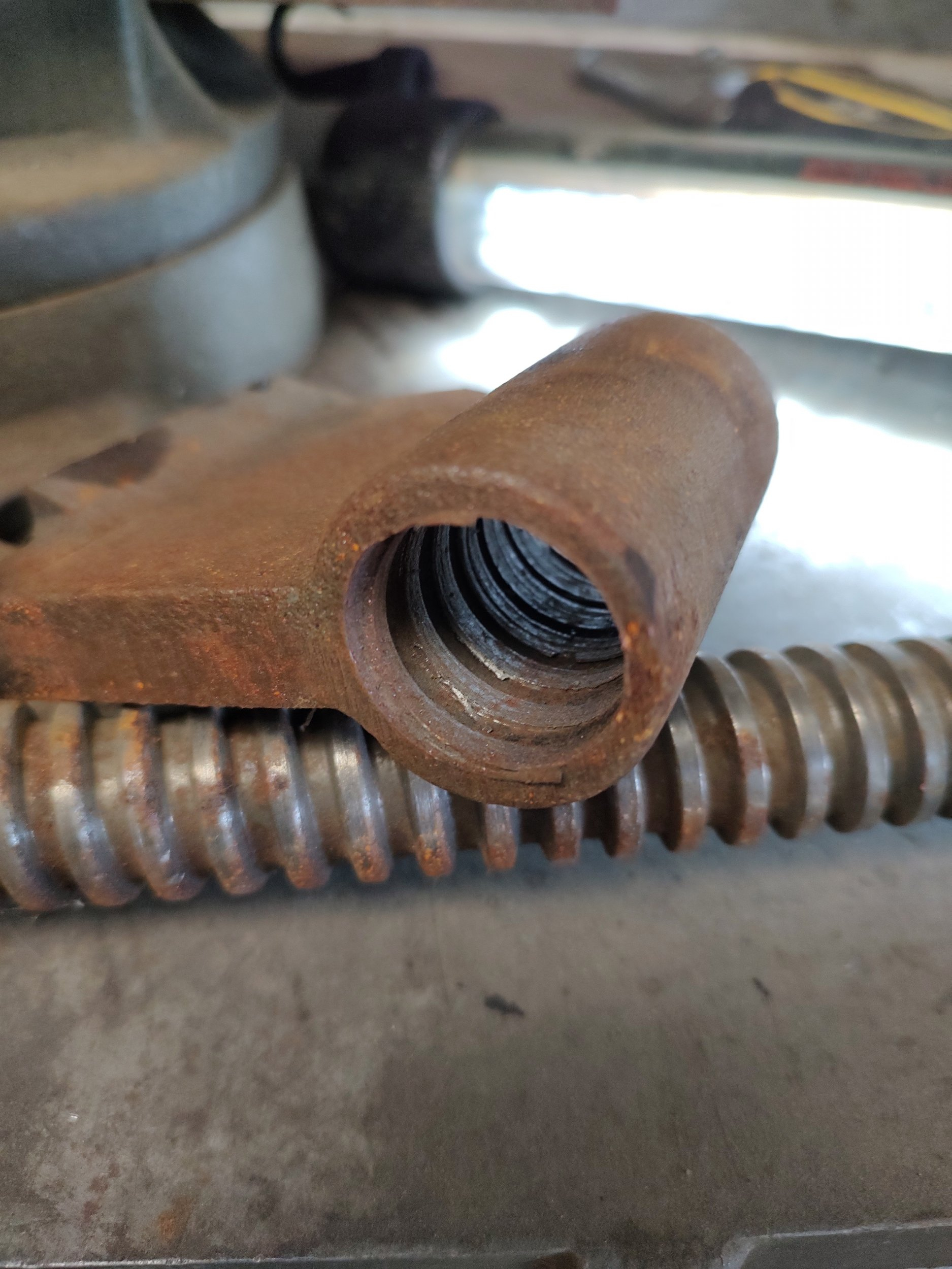

Can't seem to find a tap. Fairly certain the thread is acme. Don't know if I posted this a few years ago or not....but this project has been on back burner and I am back to tackling it again.

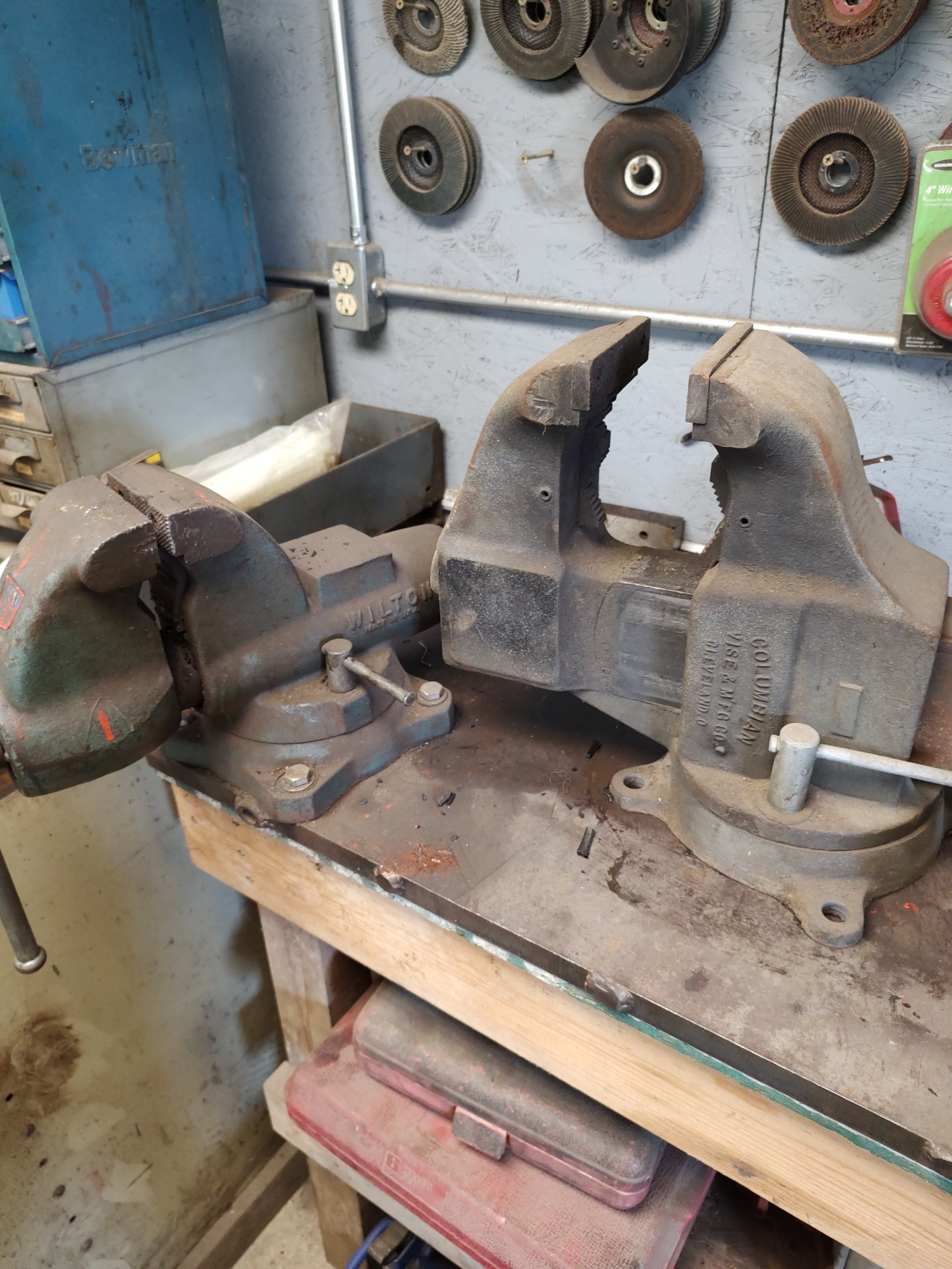

I have an old Columbian vise....5" jaws 8" opening. Here it is next to my Wilton bullet for scale.

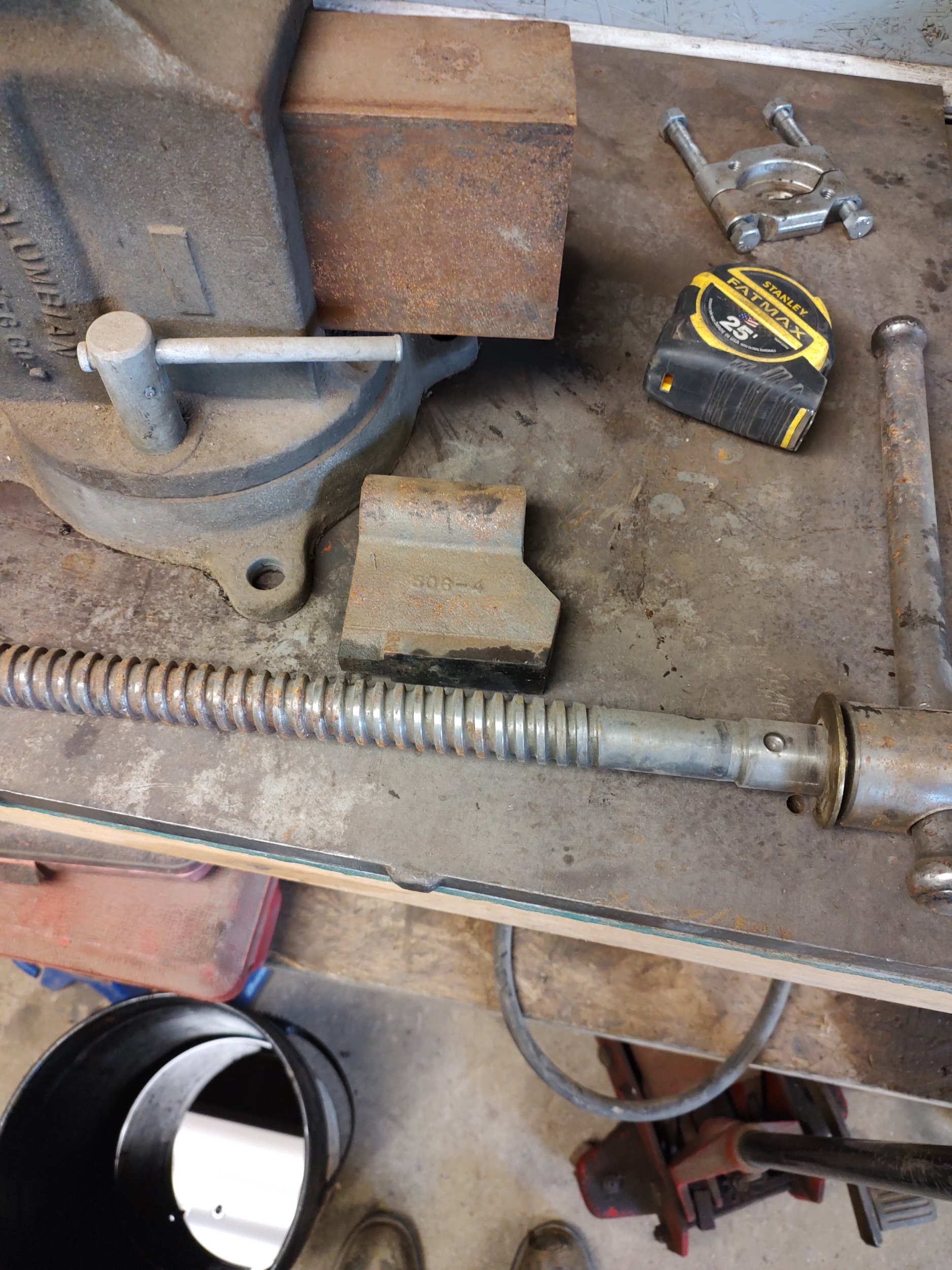

The issue is the cast piece that is threaded is stripped. But the screw is good. I have kicked around the idea of making a new screw and matching threaded block....but if I could find a tap to cut 1-1/8" x 3 acme threads....I only have to remake the block.
The part is stamped 506-4 and can't seem to just source a new on either.
Anyone got any ideas on a tap before I resort to making both a new rod and block

if it were mine...I would make the screw and nut both. but use brass for the nut. not cast. and I would cut a square thread on the lathe for both. much stronger. acmes cut very hard cause of the side angles. gotta take very small cuts....sometimes cutting 3 times without advancing the depth because of tool spring back.

No, the screw doesn't look good. But the easier part would be the female part made up of a tube that is threaded and then the heel welded on. And why would you need to go with the same threads again? Remake the screw with standard course threads and the heel likewise. And grease 'em once in a while. It'll last longer than you will be around.
But seriously I don't think the vise is worth it if you have to hire the machine work.
