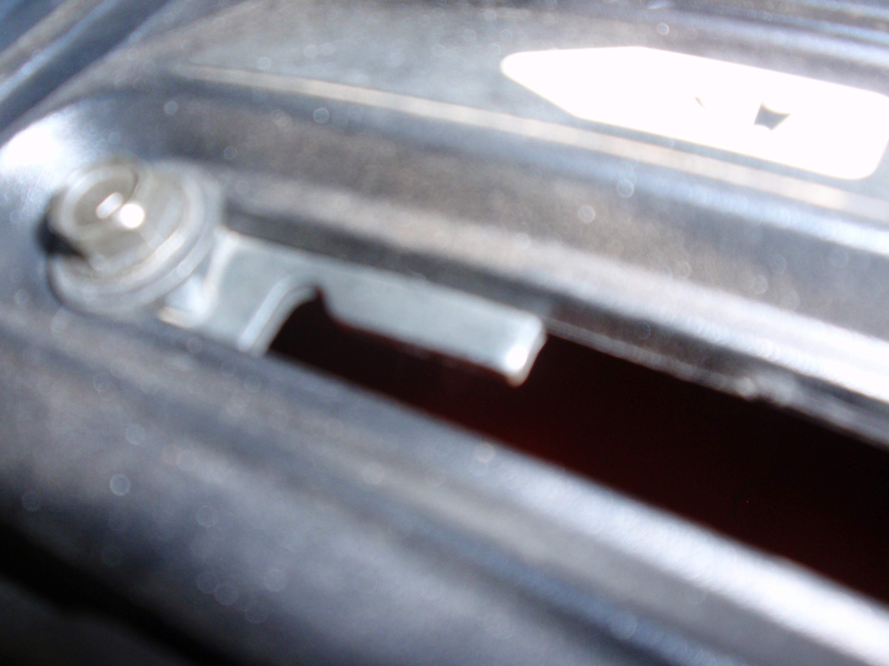

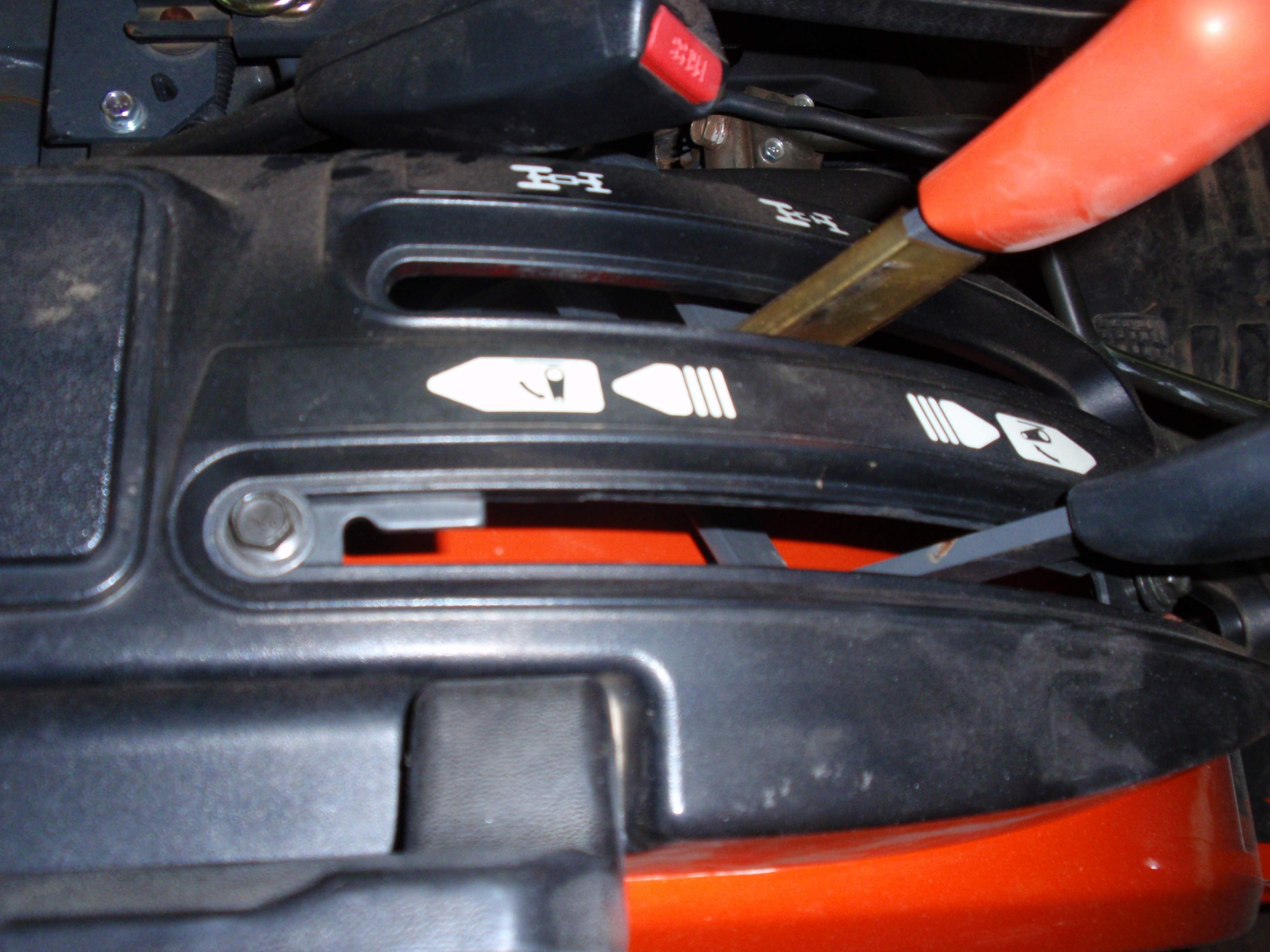

Here are a few more--

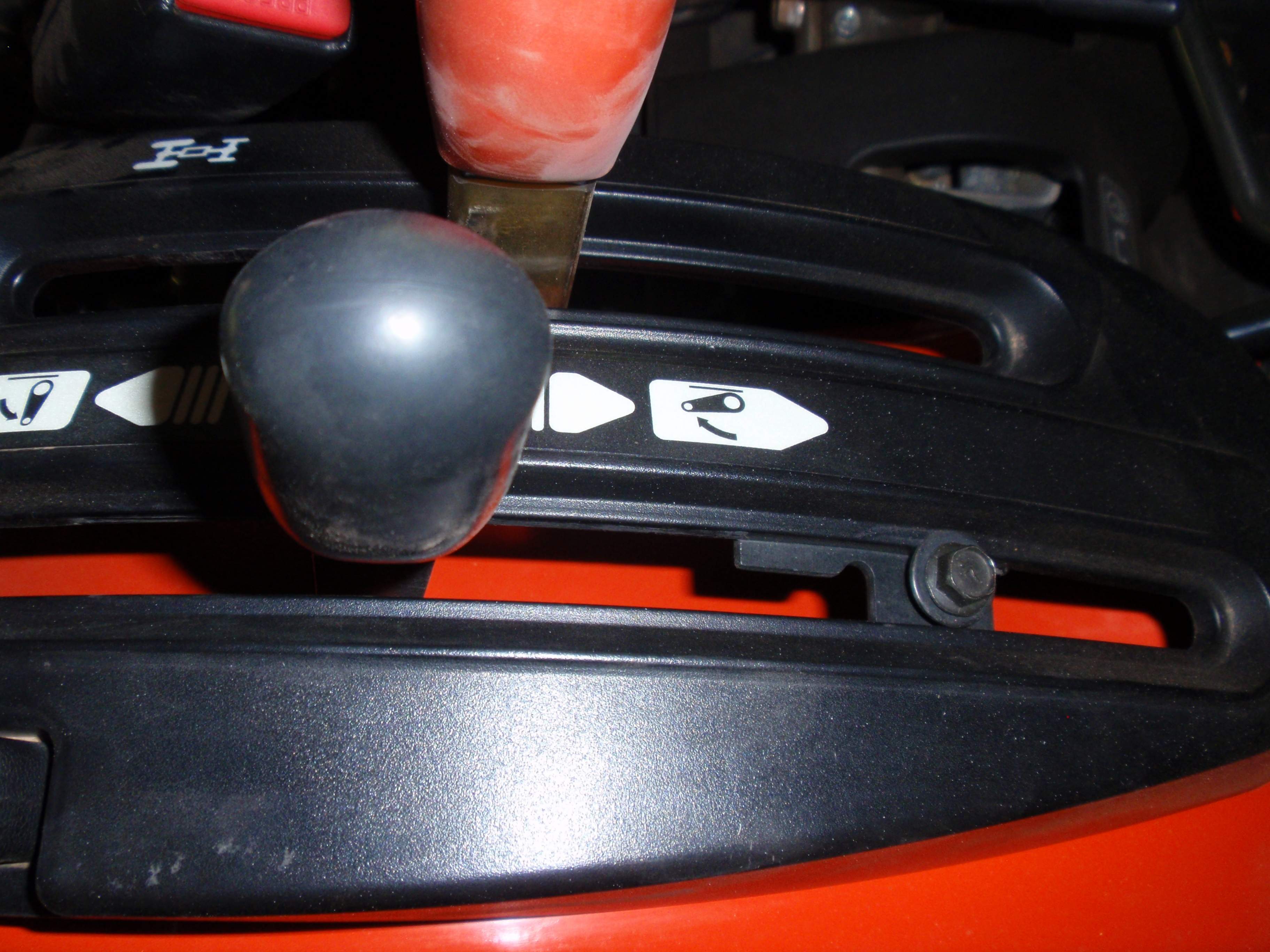

I have to admit I am a little perplexed at this point. :confused: In Giles pictures, particularly the one that shows the linkages. It looks to be the same as mine which is QI. For position control there has to be some sort of feedback from the 3pt arms to the control valve and I can't seem to find it in the picture. :confused: I see the upper and lower limit stops, but no hard linkage going back to the control valve.
My question now is to Giles, exactly how does you 3pt work for position control. If you pull your 3pt lift lever 1/2 of the way to raise does the 3pt arms only move 1/2 up and then stop or do they continue to raise all the way? :confused:
   / 1/4" Valve Haters---Read This
#36
I just went to the shop and operated the lift.
When I pull the lift leaver HALF WAY UP, the lift starts raising very slowely and continuous--moving the leaver just a small bit further causes the lift to raise rapidly.
If I have the tractor idling and the lift arms lowered to maximum I can quickly move the leaver up to the stop, and the lift will raise completely in less then 3 seconds.
As you can see from the photos, moving my lift leaver to me or away from me makes no difference.
The difference I have noticed in this Kubota, from other tractors I have owned, is that after the emplement is raised to the desired position, the lift leaver returns to neutral position. On all other tractors I have had experience with, the leaver stays in that position and moving it down results in the empliment lowering. Mine will lower only when the leaver is pushed down past the neutral position.
Is it possible that this tractor is supposed to have QI and it is not working:confused:
What has me confused is that I have read that pulling the leaver toward you and moving it will result in 1/4" of lift.
Am I assuming wrong?

When it is set properly you should be able to give the lever a quick 'bump' against the inner stops and it will only move a 1/4" at the lower link end. Also you can hold it against the inner stops and it will move slowly, or hold it against the outer portion of the stops and it will move quickly.
I think the "Bump" against the inner stops is the key here.....I just read the manual with my B2320 and they mention the inner stops as just "Slow Up" and "Slow Down" when held in place.....
So what I figure is the "Bump" momentarily is the 1/4" approx movement spoken of.....Yes/No?
What you describe here and according to what I can see in your pictures you have the QI (quarter inching) valve. Also what you describe about your old tractors is what is called position control. What is meant when we say move the handle towards you or away from you is to merly go around one set of stops to the other when you have the handle in the raise or lower position, it is not another hydrualic function of the handle. Fast and slow speed is the best way to describe it. The quarter inching part comes from setting the slow speed postion of the stops so that a bump or tap or quick (approximately 1 second) movement to the stop and back to neutral position will produce 1/4" movement in the 3pt arms or implement. See my picture on the 1st page of this thread and you can see where I labled the 2 stops. Depending on how your 3pt handle is on your tractor you may have to pull in towards you to make it hit the slow/QI stops or like mine I have to push out away from me to make it hit the fast stops. Looking at your pictures it looks like you may have to pull towards you to make your handle hit the slow/QI stops.
It looks like nothing has been done to your tractor and it looks like it is factory original, and unfortunately looks like it is QI (quarter inching).
I still wonder what would be involved with converting a QI to position control. Maybe we should start a thread about that and see if anyone has done it?
Let us know if you need more help setting up the 3pt control. :)
