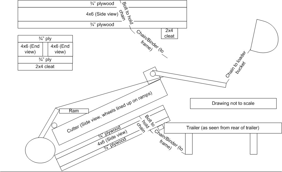

If you have a deckover and a tractor w/loader, back the mower on, then use the bucket to swing it sideways (via a hitch on the bucket or a chain). You should then be able to pull the PTO shaft and pull a couple of bolts to pivot the hitch to a vertical position
See http://manuals.deere.com/omview/OMW45017_19/?tM= for hitch installation directions.
Aaron Z
Had not thought of that. It may just work.

If your tractor has a loader, it might also be possible to mount a set of 4x6es as "side ramps" and pull the mower up sideways. See the attached drawing for details.
Aaron Z
