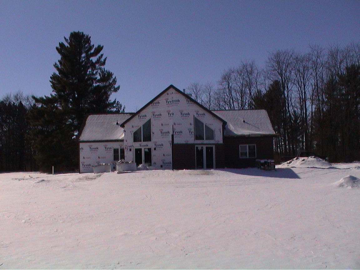

I think $100 a sq.ft is pretty good estimate. I just did this in Wisconsin 2 years ago, so my numbers are fairly recent. We built 2650 sq.ft lodge home and we spent roughly $100/ sq. ft. by time we blew through fixture allowances, made as built changes, and hauled in dirt and stone for final grade and driveway. PM me if you want any info

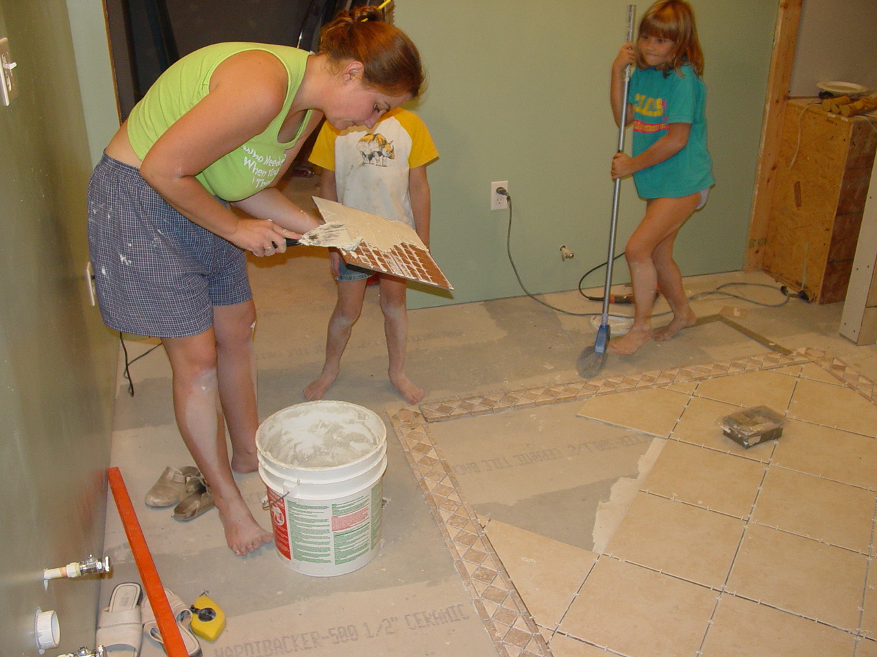

The main way we kept cost down was do everything possible ourselves and waste as little material as possible (i.e. the 3/4" plywood for the concrete basement forms was re-used as subflooring), 2 x 4 for the forms re-used for framing/blocking, concrete first floor was stained, laminate flooring in lieu of hardwood (that can always be upgraded years from now) etc.

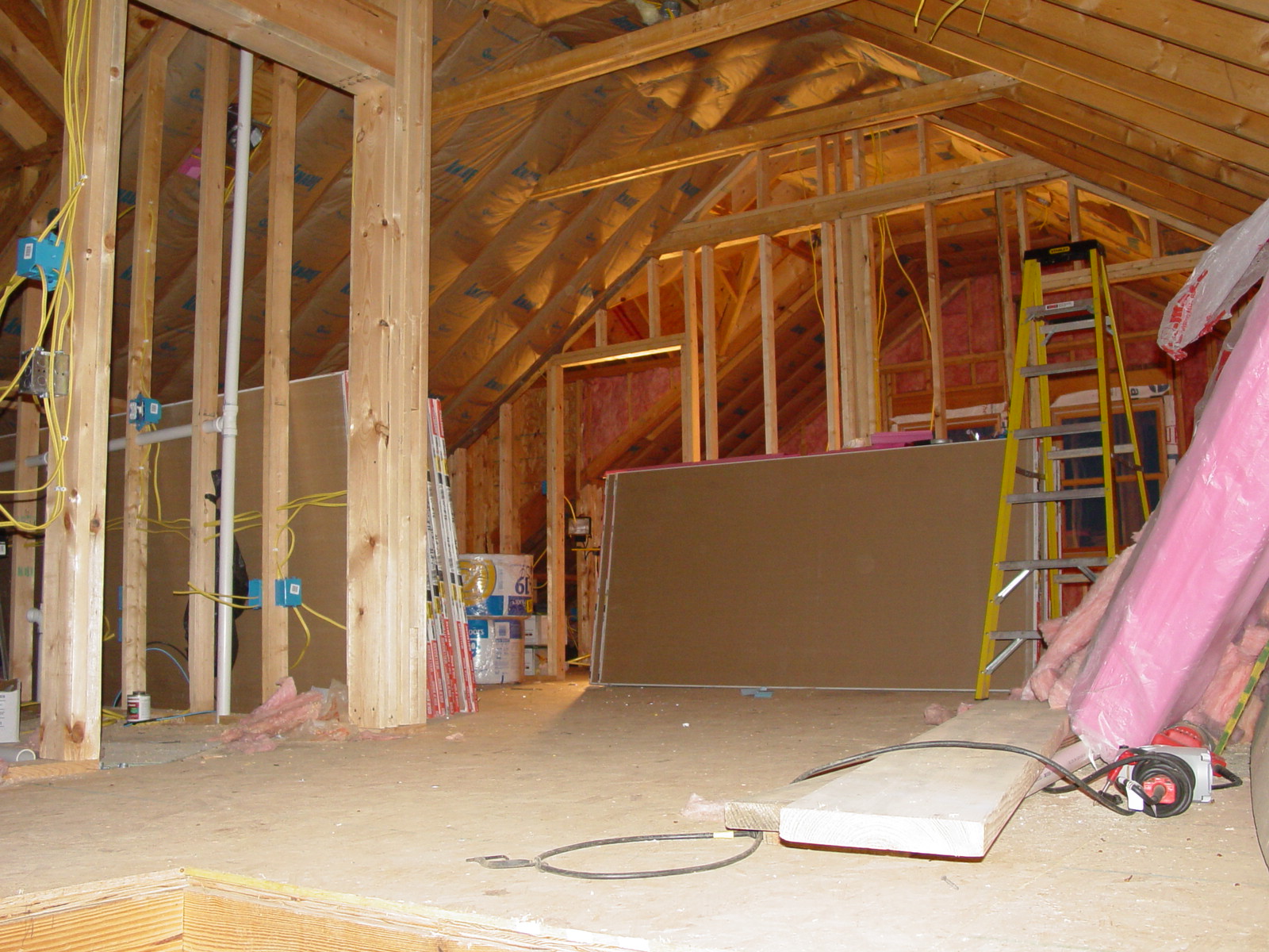

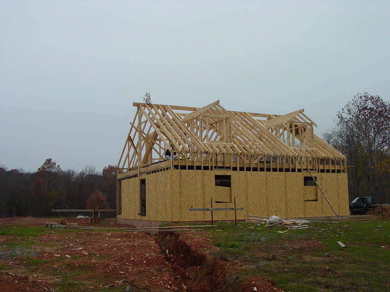

5202 is when we were framing
6283 features the chief tile layer/framing nailer/drywall finisher/painter with helpers

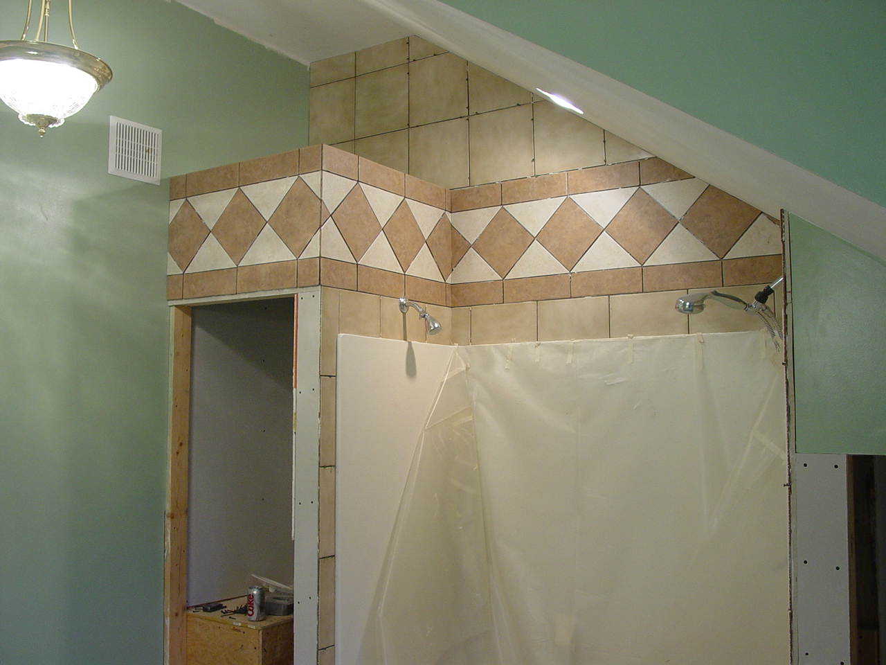

6291 is tiling above the shower (with two shower heads, no less)

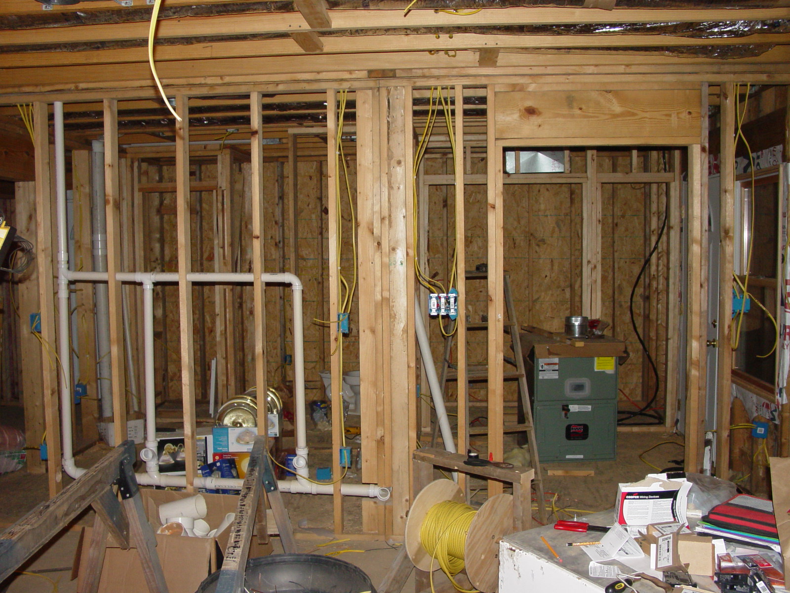

6045 is plumbing/framing/electrical downstairs
6046 is plumbing/framing/electrical upstairs
