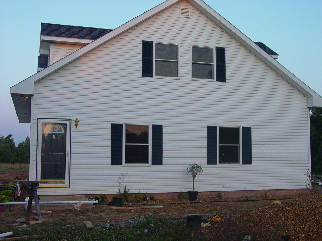

6411 is the front view

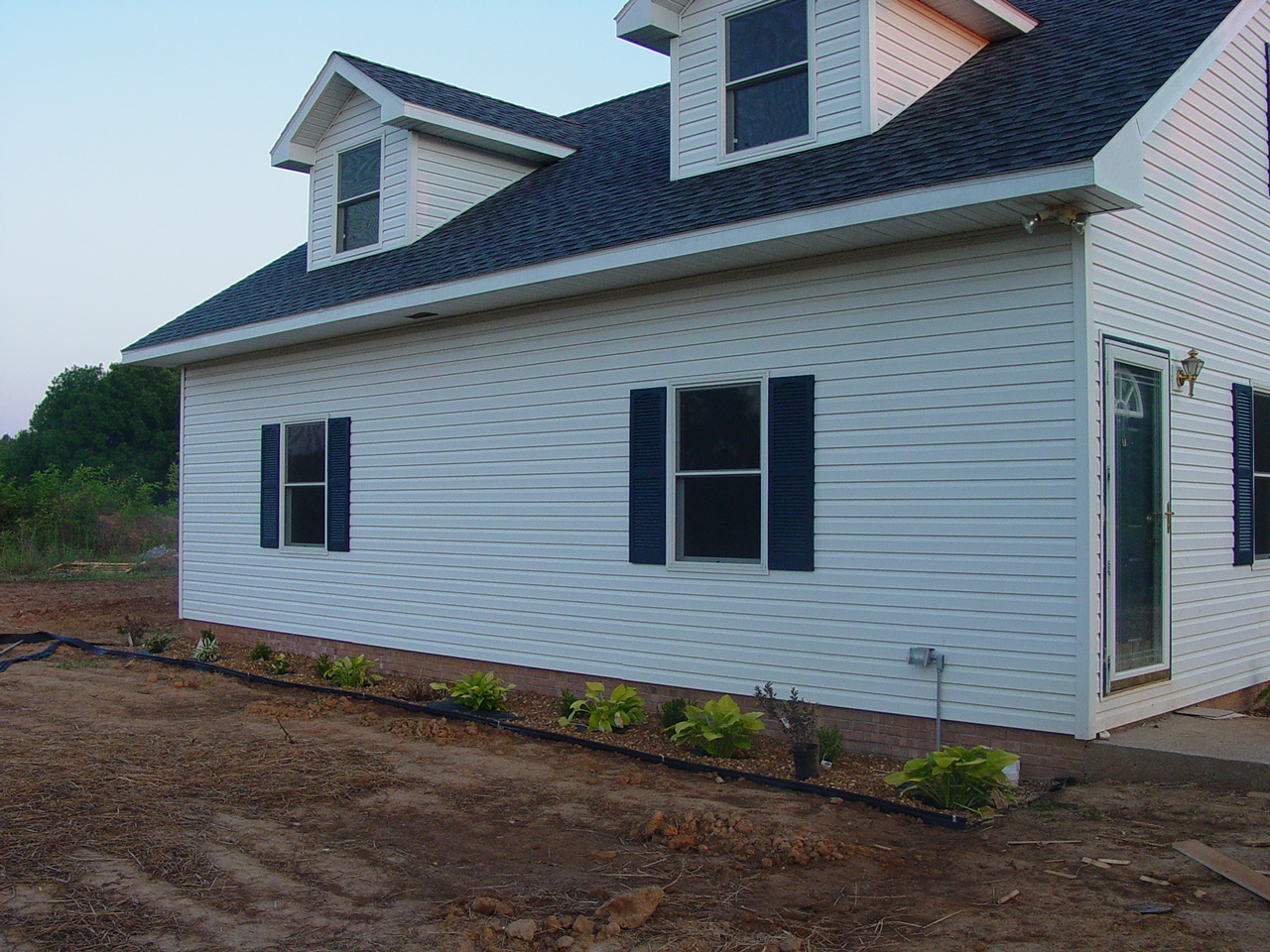

6414 is the side view

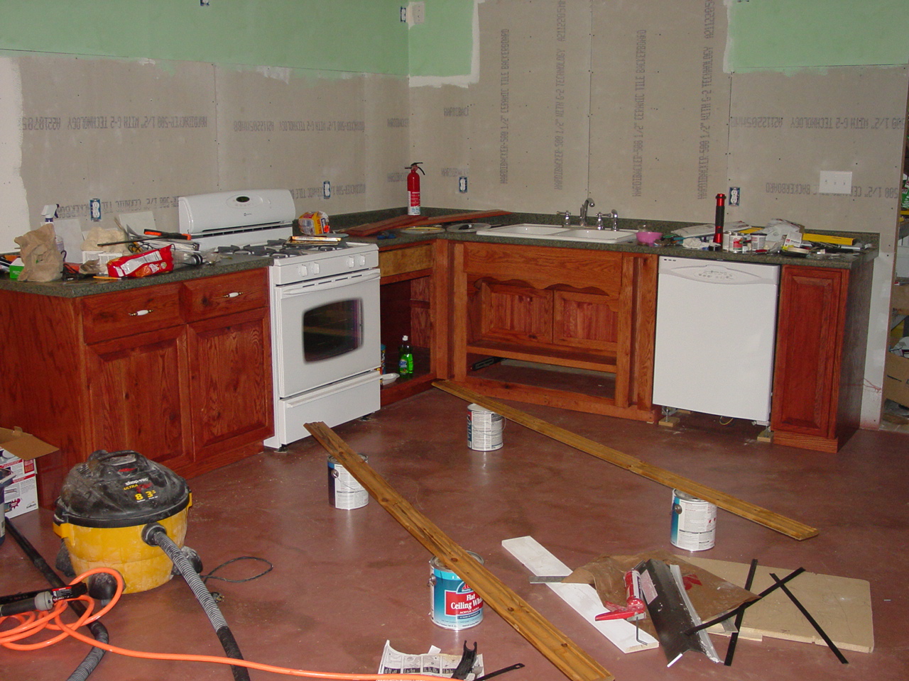

6428 is a shot of some of the kitchen cabinets
Building the cabinetry is far and away the most gratifying/fun part of this whole process. We had planned on purchasing cabinets, but we looked at the box store cabinets (expensive junk), local discount outlet assemble yourself cabinets (cheap junk), and even allegedly Amish built custom cabinets from a local shop (that still used particle board shelves, plastic corner braces, $1.89 drawer glides, etc). I was disgusted I decided to build them myself. We purchased rough red oak and maple from a saw mill, stickered it and let it dry, and I got to buy table saw/planer/jointer/drill press/compound miter/molder/lathe/bandsaw/sander/etc. for less than the price of the cabinets from any of the sources. I even learned how to make dovetails for my solid maple drawers and raised panel doors, etc. I still have so much more to do and so much more to learn, though.
Also, a bit of an explanation - this house began life planned as being a garage for a larger house to be built several years from now. That may help to explain it's boxy shape and concrete floor. Years into this process, we have realized that while we may indeed (probably will) build the larger house, we will never convert this house into a garage (way too much emotional ties from building it from the ground up). In retrospect, I would have done many, many things differently that would improve the look of the otherwise boxy house, but I am overall still very happy.

VERY NICE!!!!!!
Thanks for posting the pictures. You guys have done a fantastic job. Especially for what you have into it. Just amazing how much you can save by doing it all yourself.
Putting backerboard on your walls in your kitchen was a suprise. I've never seen anybody do that before. Same with the green board, but it doesn't hurt anything. Just extra money.
Your framing looks great. I love how big and massive your headers are. No worries there!!!!!!!!!!!!

The backerboard is there for tile work that will be installed after we (build and) hang the upper cabinets. I don't know if we had to, but we (my wife and I) have recently completed a tiling job at a nursing home shower room that just had green drywall beneath the tiles (except in the shower stalls themselves - thank goodness it had backerboard). The tile was falling off the walls where it was just on drywall (in fairness, this tile is probably 12-15 years old, so maybe that is to be expected). Just for the slight increase in material cost (and aggravation of installation), I'd rather go with the backerboard.

In wet areas, like bathrooms and especially showers, cement based backer boards are the only way to go. Green board is for the surronding areas in high moisture locations like the ceilings in bathrooms due to steam and condensation.
Kitchen walls don't have these issues and backsplashes are considered decorative, not wet areas. What you have is great, it's much, much better then you needed. I just wanted to point out that it's not required and you could have saved some money with regular sheetrock.

Dang - I could have built it for $44,975 instead of $45,000! We did put backerboard on all the floors in the bathrooms and utility rooms and we put it on all of the walls that have/will have tile. We put the green drywall in bathrooms. I'm sure that drywall base for tile work as backsplashes is addequate, but for the few more dollars for backerboard, I'll put up backerboard.
