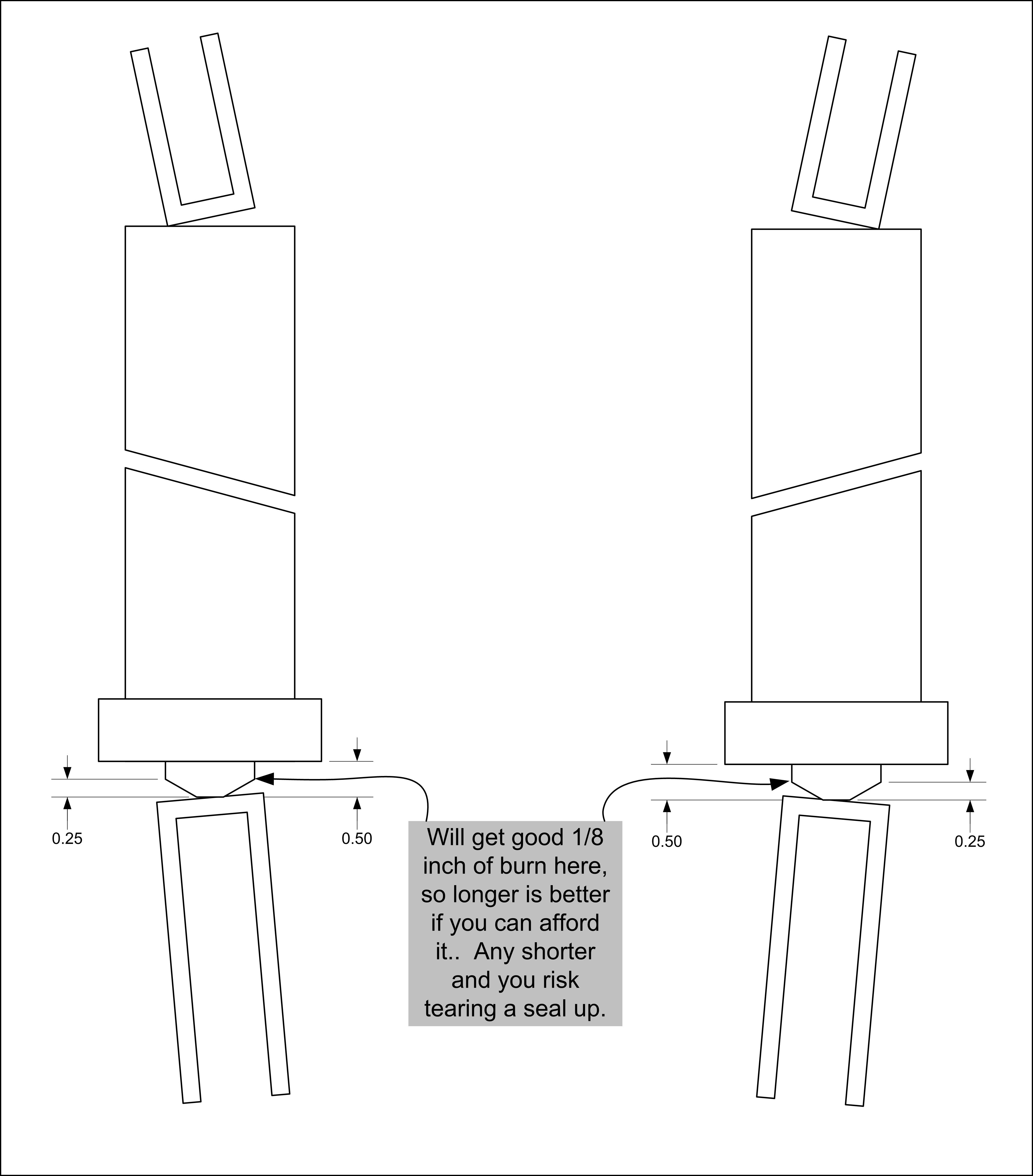

The side links aren't too bad. For the BX22 when using the bailey cylinders, when fully retracted, I just needed enough rod to keep from pinching stuff and give the welder enough room for the bead. I left 1/2 inch of rod total (see picture). There would be 1/4 inch ground off the side of it for the welder, and another 1/4 inch of untouched rod below the weld. You really don't want to go anything less than 1/4 inch between the weld and the seal because the heat from the welding will damage the chrome at least 1/8 inch below the weld which leaves only another 1/8 of good chrome. Not much..
If the OEM links were longer then I would have left more rod, but in this case the cylinders were an inch longer than the OEM links so shorter was better.
The new side links, once all put together using OEM sized clevis ends, left the total side link length 1 inch longer than OEM. It turned out to not be a big deal. And if I need to get that extra inch back there is enough clearance between the lower links and the top of the side link clevis ends that I can move the pin hole up an inch on the clevis end without any problems. I haven't found the need to do this though.

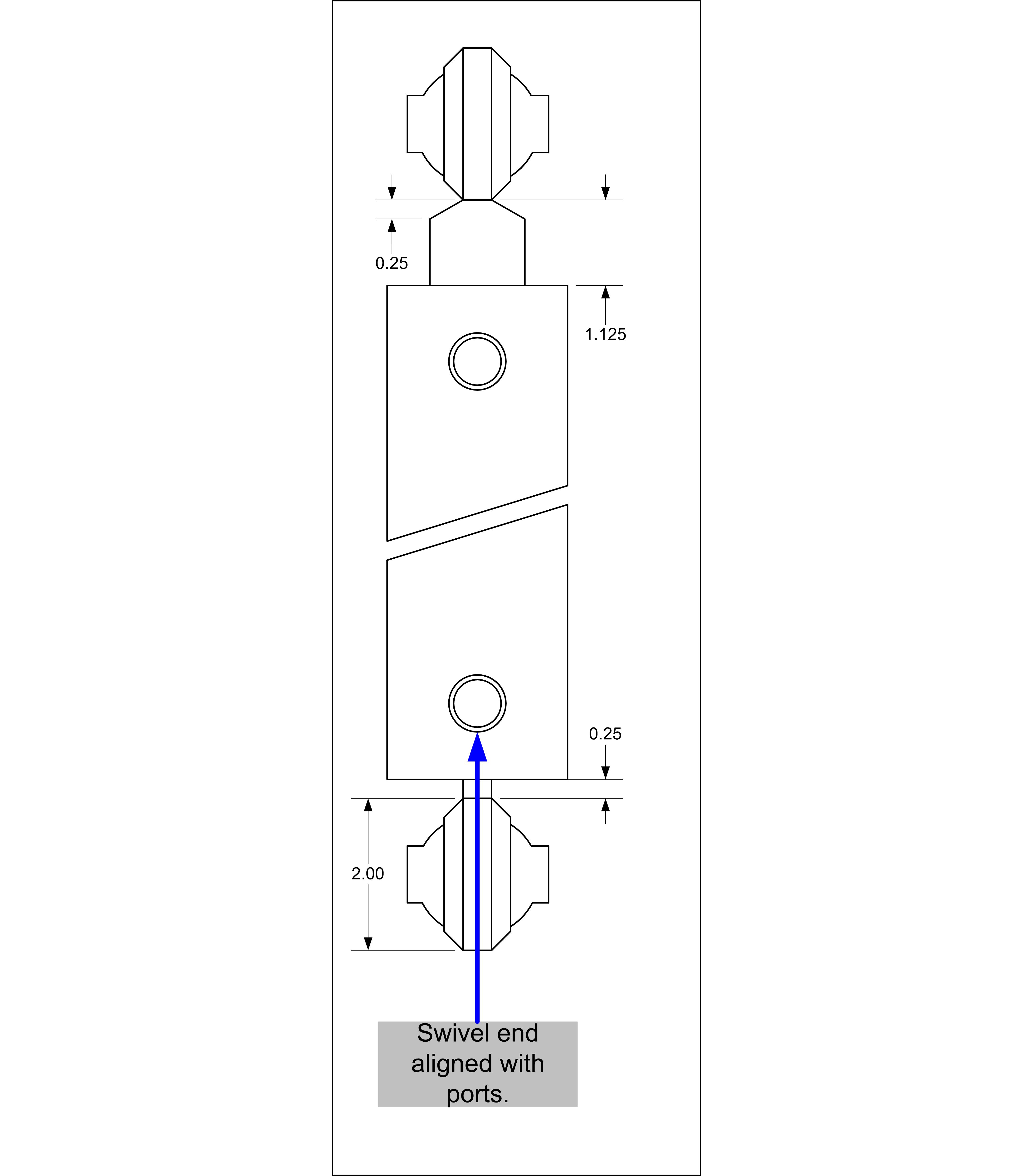

Don't have to worry about angles on this one, just rotation or lack there of in my case. The rod end swivel just needs to be straight and centered on the rod. The rod will turn in the cylinder, so it's pretty hard to screw the rotation on that one up.
The non-rod end worked out best when the swivel end aligned with the cylinder ports (See the picture). This way, when using it on the tractor, I can aim the ports up or down by flipping the cylinder over. If the swivel was aligned such that the ports aimed out the side when mounted, flipping the cylinder wouldn't make much difference because the left side of the 3pt hitch looks pretty much like the right side. So if it's in the way on one side, it will probably be in the way on the other side too. But use what you think will work best for you.

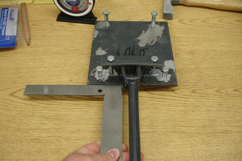

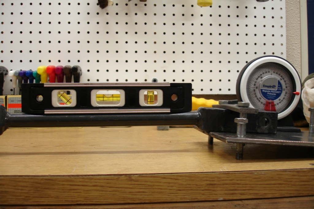

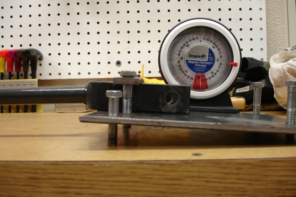

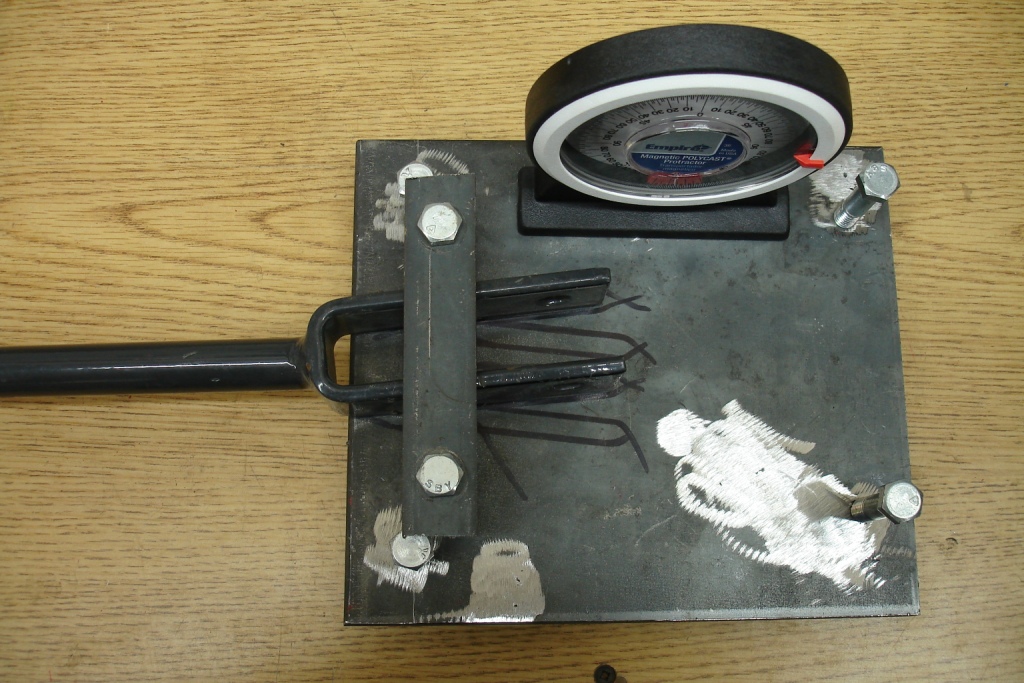

The side links (Rod end).. When I took the side links off the tractor the angles of the ends were pretty intimidating. But thought about it for a bit, it's just a bar with two ends. The ends just happen to angle back to front and side to side at the bottom, and side to side at the top. The rotational difference between the rod and non-rod end didn't matter because you can just give the rod a twist after things are welded if need be.
To figure out the angles I used a flat piece of steal approx 8"x8" ($1 scraps shelf at the welding shop), drilled and tapped each corner, and put bolts with nuts into the holes to make the angle of the plate adjustable. The I drilled and tapped two more holes to make a clamp to secure the side link ends to (see the first two pictures). This jig did a couple things for me, it gave me a consistent way of measuring the angles of the link ends, and it gave me a jig for welding.
How to setup the jig.. Slide the end to be measured/welded under the clamp with the holes of the clevis ends to the sides. Make sure the bar of the side link is square with the end of the plate, and tighten the clamp (third picture). Then, using a level (or eyeball), turn the bolts until the bar of the side link is level and the plate is level from side to side and doesn't wobble, then tighten the lock nuts (fourth picture). The pictures don't show lock nuts, but you want to use something to keep the bolts from turning or be careful not to unintentionally turn the bolts.
The measurements I took from my side links are in the last picture, yours may be different if Kubota changed anything from model to model. But the beauty of this jig is you really don't care what the measurements are since it will allow you to blindly duplicate the OEM angles.
The back to front angle is secured by the screws of the plate (the second picture). To secure the left to right angles, just take a marker and trace the clevis ends on the surface of the plate (the first picture). They are hard to see from the picture, but the non-rod ends are marked there too (Note for the BX22, the non-rod ends didn't have any back to front angles, just left or right).
Now that you have the jig adjusted for the rod ends, use the marks on the top of the plate to line up your new clevis end in the clamp. Square the cylinder with the plate and use shims to make sure the cylinder is level. If the clevis isn't the same height as the cylinder rod, just turn the four corner bolts equally until it is the right height. Then tack the clevis to the rod. That's it. Real easy once you have the jig set.

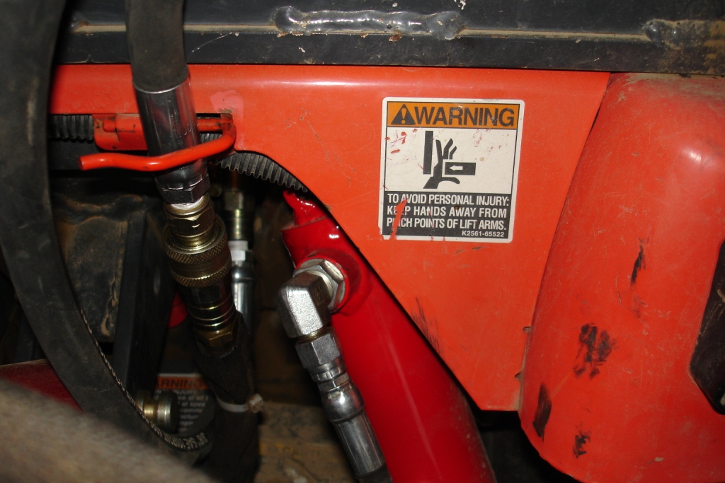

With the BX22 I had to consider where to locate the cylinder ports so that the ports and fittings wouldn't bend up the fenders when the hitch is raised. Take a look at the first picture and you'll see where the top port and 90 degree fitting are in relation to the fender.
The trick to making sure you will clear the fender is to consider the worst case scenario. The ball end in the lift arms will allow the clevis to rotate some, so you need to rotate it to towards the fender then figure out the safe angle for the ports in relation to the clevis end. Sounds difficult doesn't it..

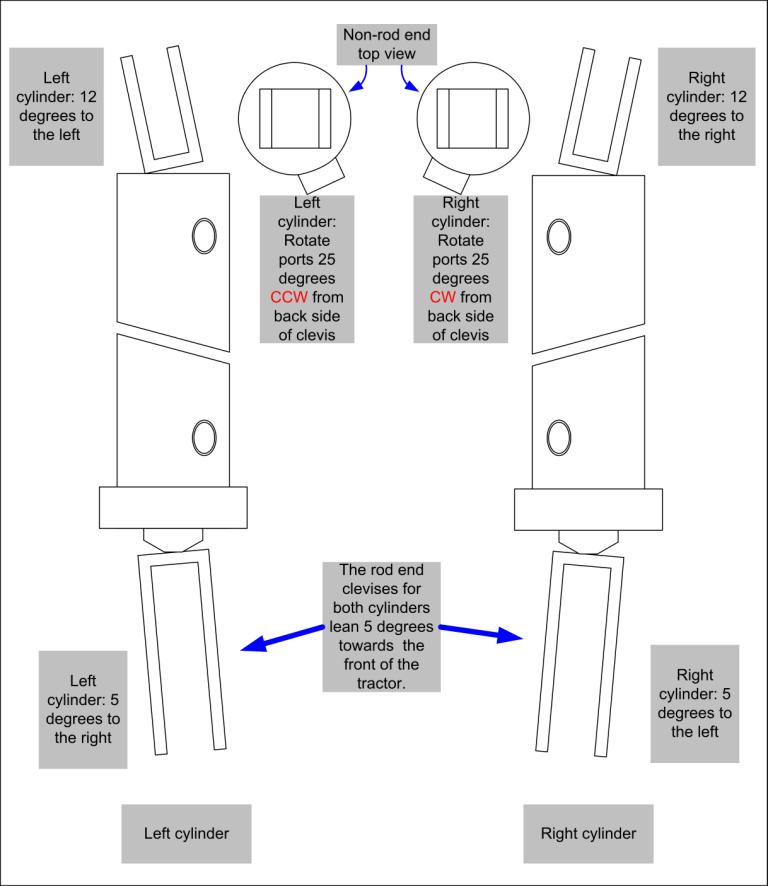

Picture two to the rescue! Found it online somewhere. Print it out as multiple pages per sheet and it will print a handful of correctly sized protractors for a 2" cylinder. If they are still not the right size, try to save it as a .jpg and use a photo editor to resize it. Or you can google for a different one.
So how do you use the protractor? Just center it on the bottom of the clevis end such that either 0/180 or 90 is square with the open side and stick it there with a piece of tape (number side up). Raise the lift arm as high as it will go. Now pin the clevis end onto the lift arm and twist it to towards the fender. Eye ball the point where it clears the fender and mark it with a pencil or something. This will be the OUTSIDE of the cylinder port.
Hold the clevis end with protractor onto the non-rod end of the cylinder and line up the mark with the correct side of the port. Now make a mark on the cylinder for the point that is squared with the clevis end. For example, when I taped my protractor to the clevis end, I set the 90 degree to be square with the open side of the clevis. The mark I made on the protractor after holding it up to the fender was on the 65 degree point. So once I lined up my 65 degree mark with the cylinder port, I marked the 90 degree point onto the cylinder. (Please note that when I did it I guesstimated the center point of the port when I marked the protractor. I later determined that the side of the port would have been the more accurate & easy way to go. So where the last picture says the clevis is rotated 25 degrees from the ports, it is 25 degrees from the CENTER of the port. Your number will be different if measuring from the side of the port)
Once you have the mark on the cylinder, draw a line across the middle of the non-rod end of the cylinder using the mark as your reference. When you go to weld the clevis on to the cylinder, this line should run through the middle of the open side of the clevis end.
You can use the same jig as was used for the rod-end work. Do the same setup to figure out the angles, adjust the height, and tack weld the end onto the cylinder. The only difference here is you need to pay attention to where that mark on the cylinder is in relation to the open side of the clevis end.
And BE SURE you have the correct cylinder before you weld. The right cylinder rod end clevis angles to the left and to the front, with a non-rod end angled towards the right. The left cylinder rod end clevis angles to the right and front of the tractor, with a non-rod end angled towards the left. I screwed this up twice.. Yes, twice. :mad: This is why you TACK weld.
