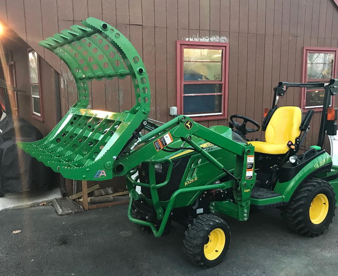

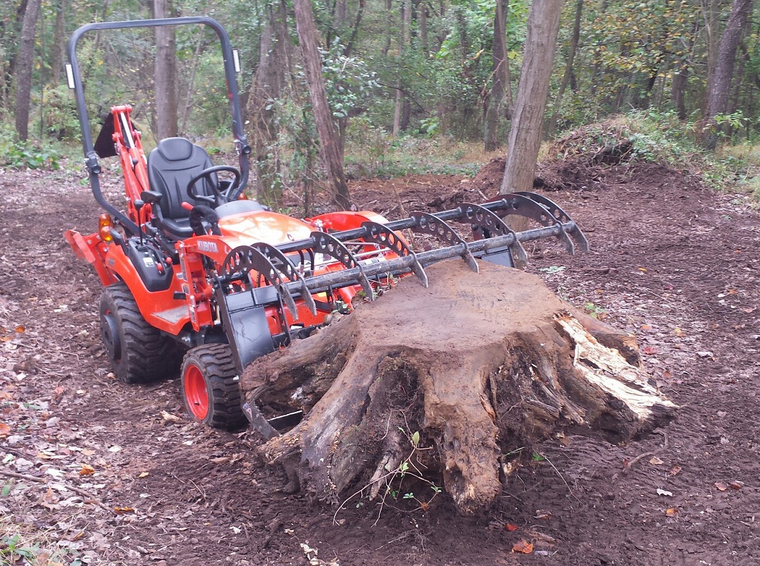

Here's the best grapple for either of those tractors, no matter the price! 200 pounds, 36" opening.
Custom valve kit is under $800 when purchased with a grapple.
