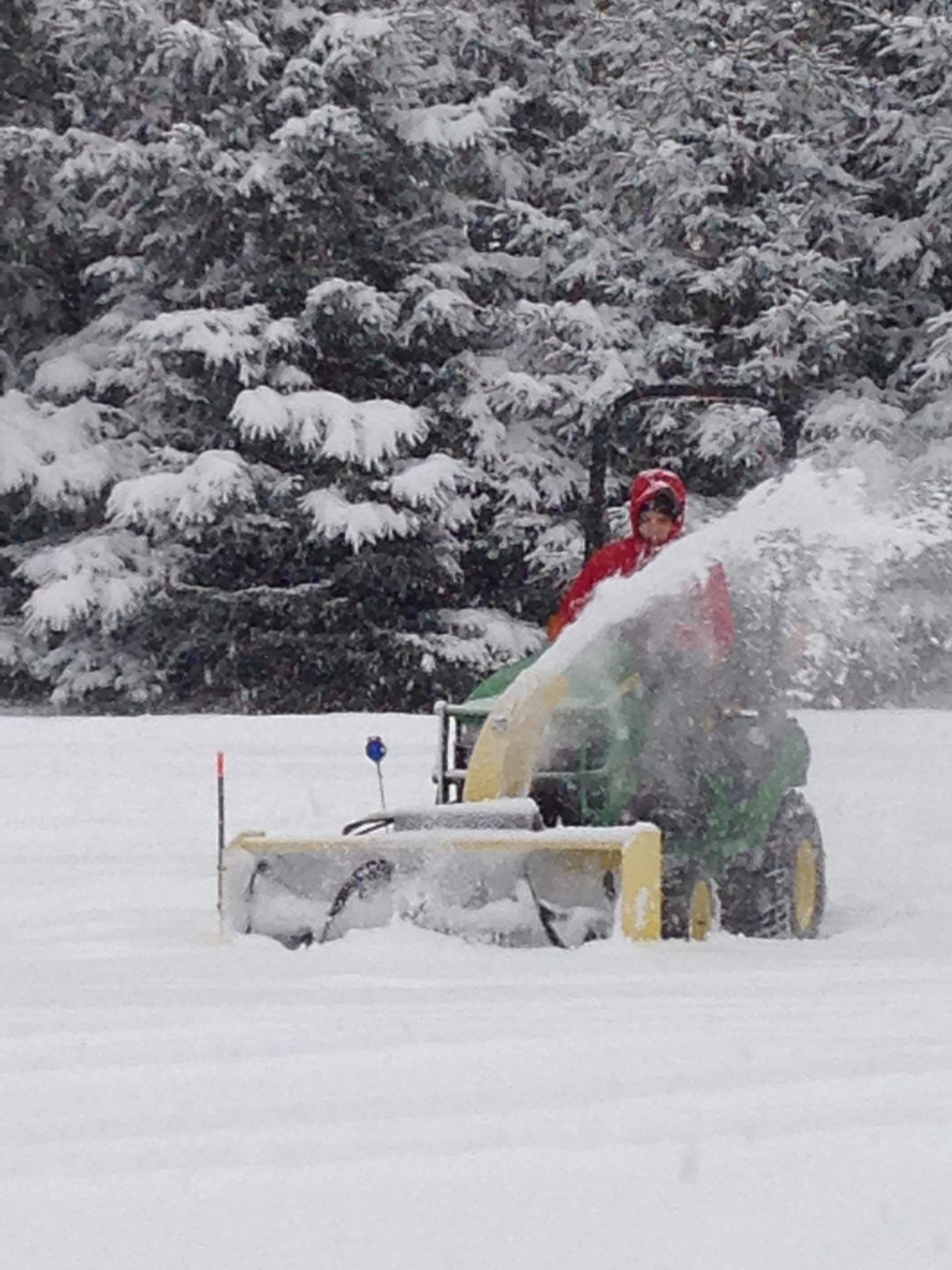

There's no adjustment to the sensor location, but the gap spacing appeared quite sensitive to me. I spent a fair amount of time ensuring the gap I set was accurate - and the thing is hard to adjust assembled too.
I put it on app. 2 weeks ago, & mine works fine (can reverse w/o snowblower or engine cutting out).
Good luck!
