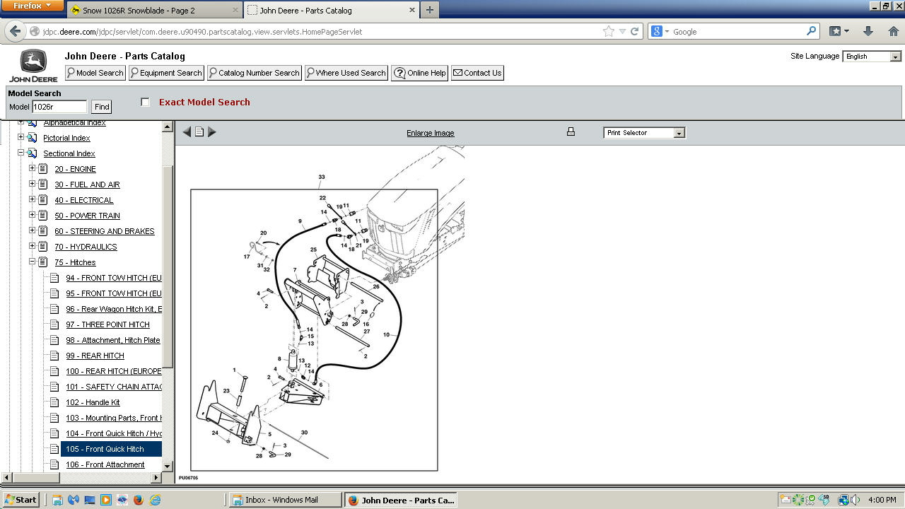

I found the diagram on jdparts with no problem. here it is...
I don't know about the parts in common but seems to me if all other parts are the same you can just replace the part #7 ?? AM132310
really wishing I had negotiated a snowblower with my 2210 when I bought it back in the spring of '04. I don't have a front hitch and never saw one up close except in photos.

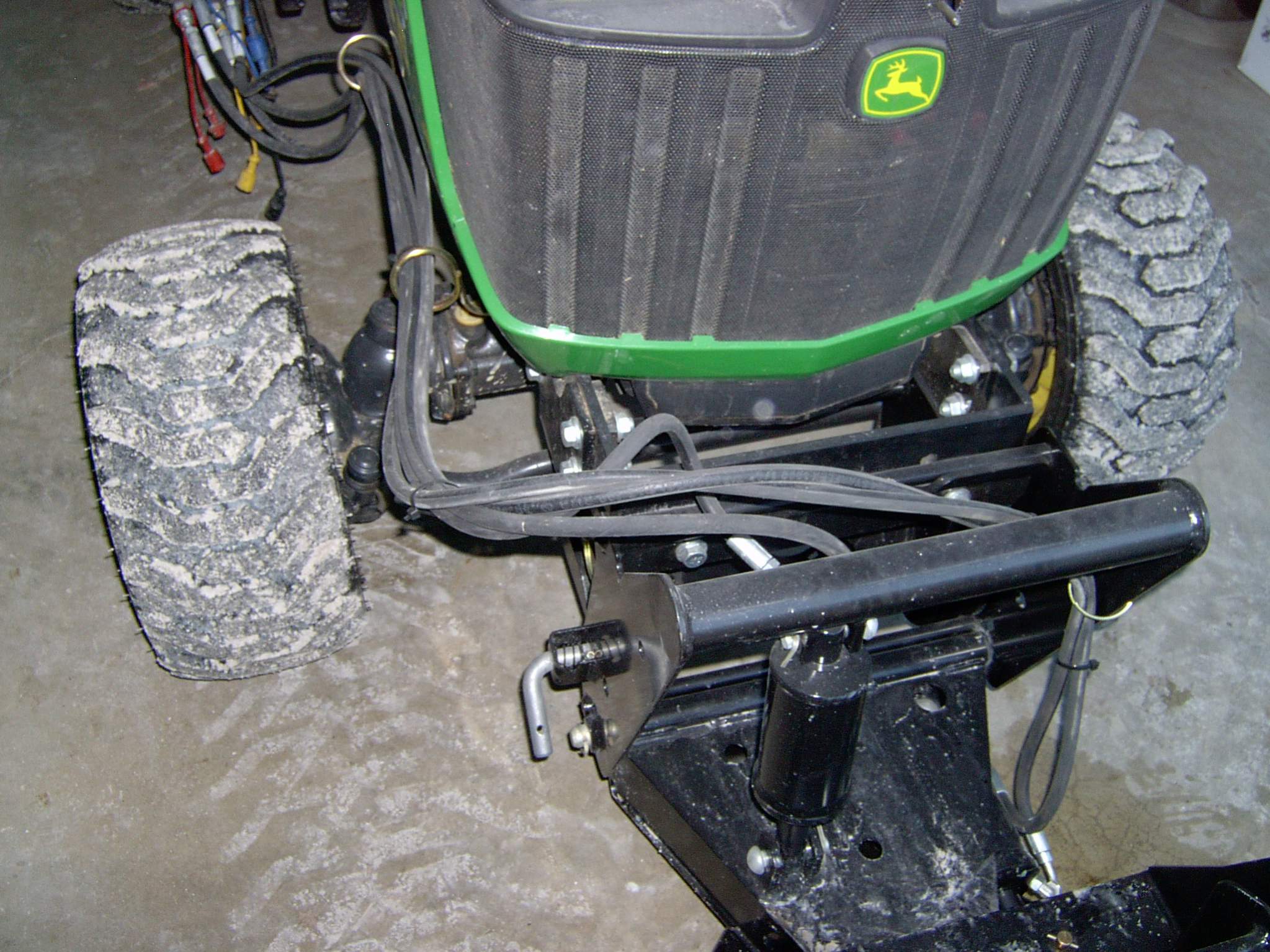

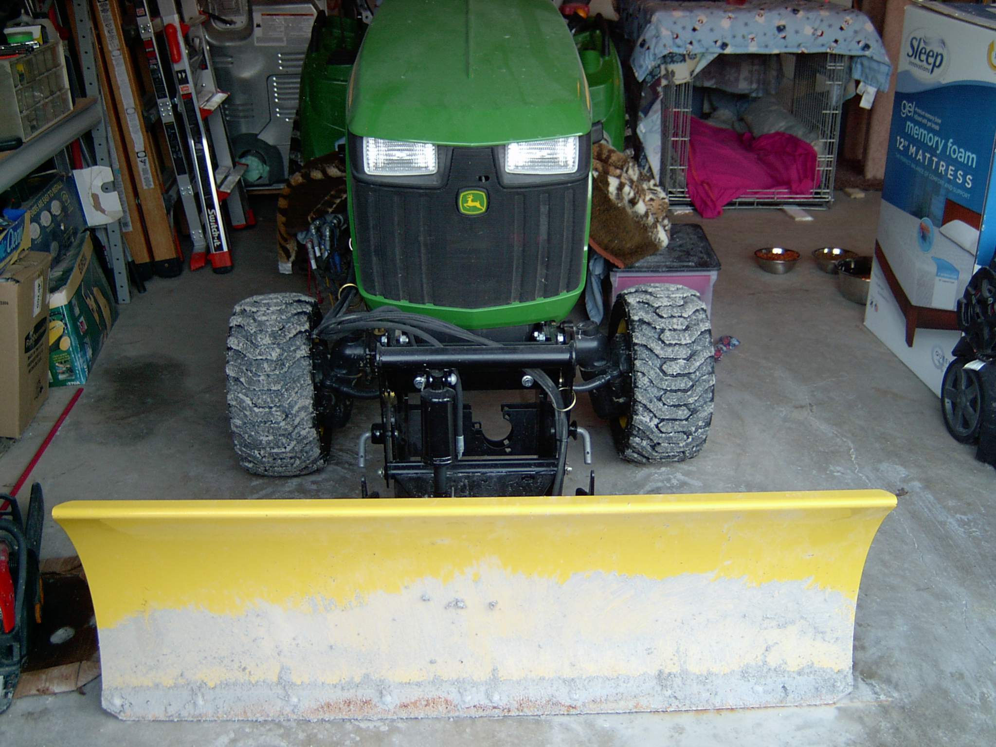

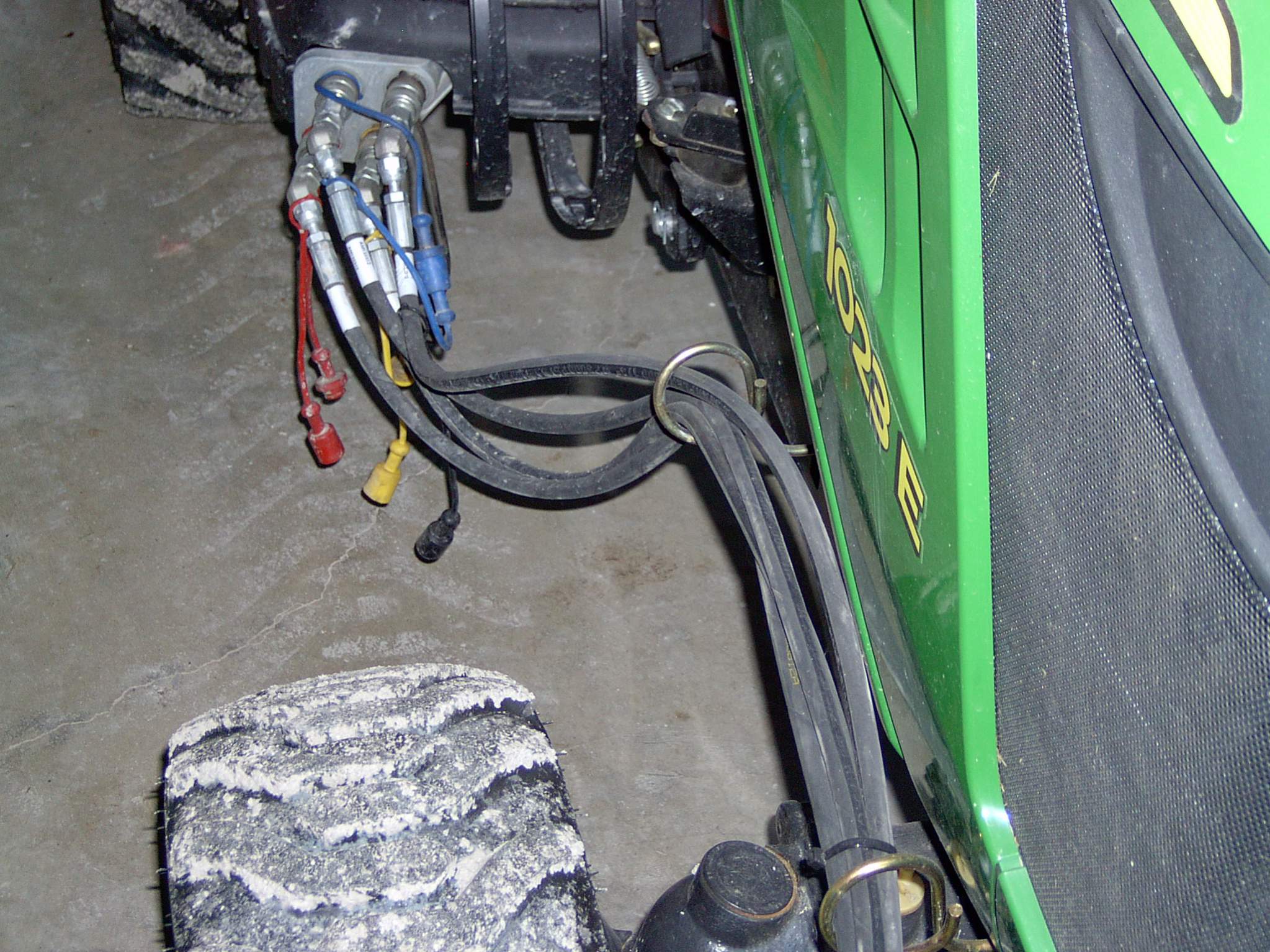

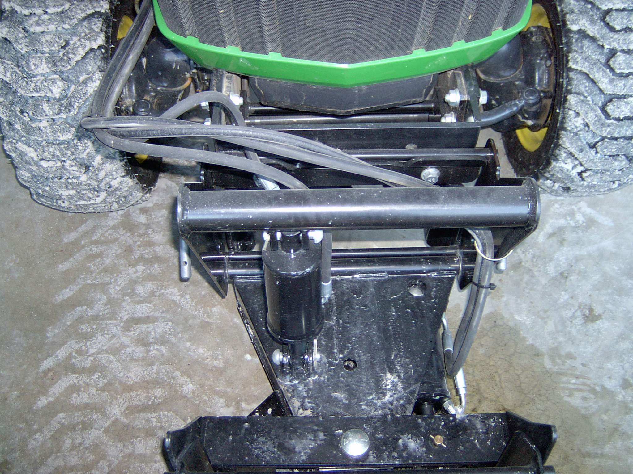

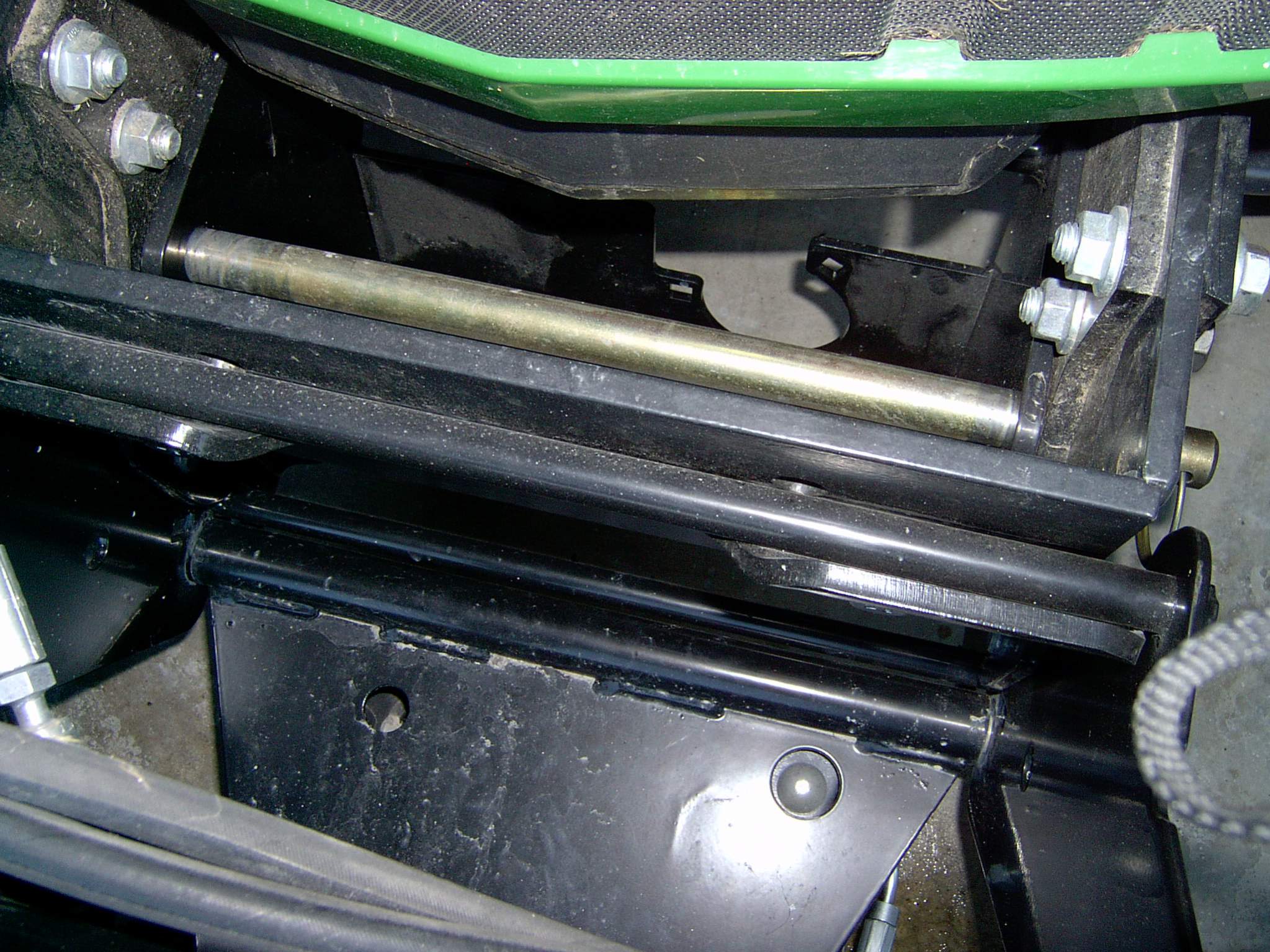

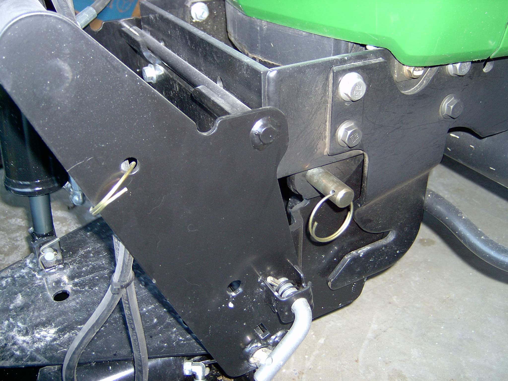

Sorry I didn't make over to my brother in laws house to get pics for u. He had the flu and I wanted to stay clear. He's over it now. I'll go over there tomorrow after work and get pictures of the blade and mounting hardware for you. Again sorry for the delay.
   / 1026R Snowblade #15
As promised here are the pics.1023blade 001.jpg1023blade 002.jpg1023blade 003.jpg1023blade 004.jpg1023blade 005.jpg1023blade 006.jpg
