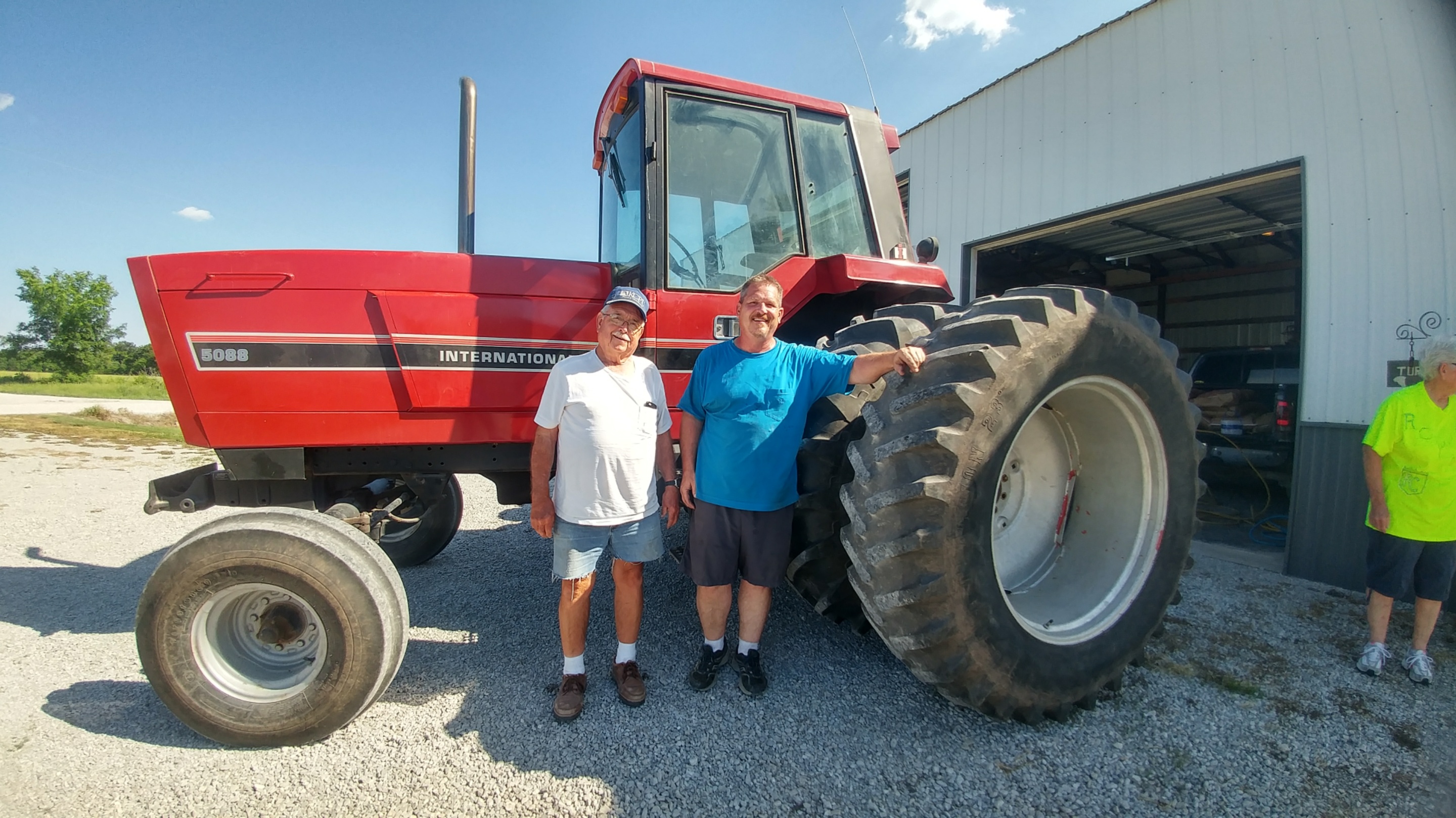

so here at the farm this weekend and when I say farm I mean we take care of 707 acres..............varies in row crop, CRP, timber - personally I don't have the funds with dad to have a 4x4 in large size, how did I come about this decision 95% money and then my neighbor that rents our 80 for row crop - ( who is one year younger than me we went to school together ) dad and I just upgraded - so since he is a Deere man - his family had fords when I was growing up and worked for them - So he like me has been around tractor s and farming all his life - they had a 9600 7700 and tw20 for big tractors, they still have the tw20 and 9600 but now has expanded to all 4wd for tillage - so I talked to him before I purchased mine - he said Robert to do what you need to do with large tillage 1st don't short yourself on HP - second he said is weight he said I have had to abandon the 6000 series deere as they just aren't heavy enough for my needs even in 4wd and then I run out of power - he runs 7000 and 8000 series for everything but hay, he uses his 6230 for haying and its probably close to 12K with a loader. He still runs duals on his 7K and 8K series 4wd tractors if that tells you anything about traction even with a 4wd.
he said his tw20 and 9600 2wd with duals would work circles around the 6K series - so as we all know, there are many variables here to consider but I am going with the guys with real life day to day experience, weight and power will forgo a 4wd unless you are comparing apples to apples - so in this case with the OP being power/weight - im going 2wd duals - running out of power is a sickening feeling and wears you out dealing with it
I mowed some of the thickest CRP yesterday for 6 hours then disked for another 6 - 15ft batwing and 18foot disk, there is no way I could have done what I did with an 85hp tractor that is why I traded our 89hp 706 to a 5088 both IH tractors Dad and I and 5088.jpg
