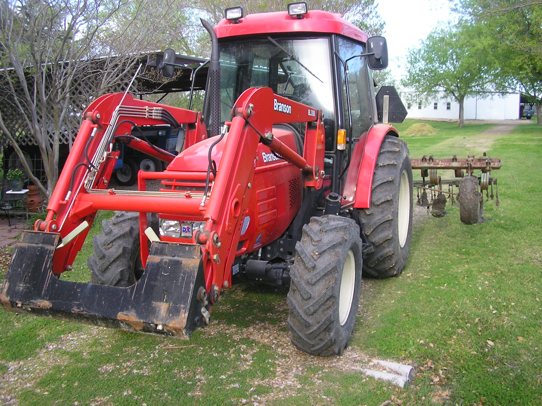

texasmark, what kind/size of implements are you using with that branson? I find it hard to believe it would pull large tillage w/out needing more power but then again clipping a grazed pasture with a 15' batwing is a far cry from pulling one through 8 to 12 foot growth in 2 yr old CRP. No way a 57hp tractor could do that so its all relative to the soils/implement/applications - I would love to have a mid sized 4wd with a cab to replace my 706 ( saving up for that ) and I have already considered dropping HP and using the 5088 for the BIG STUFF

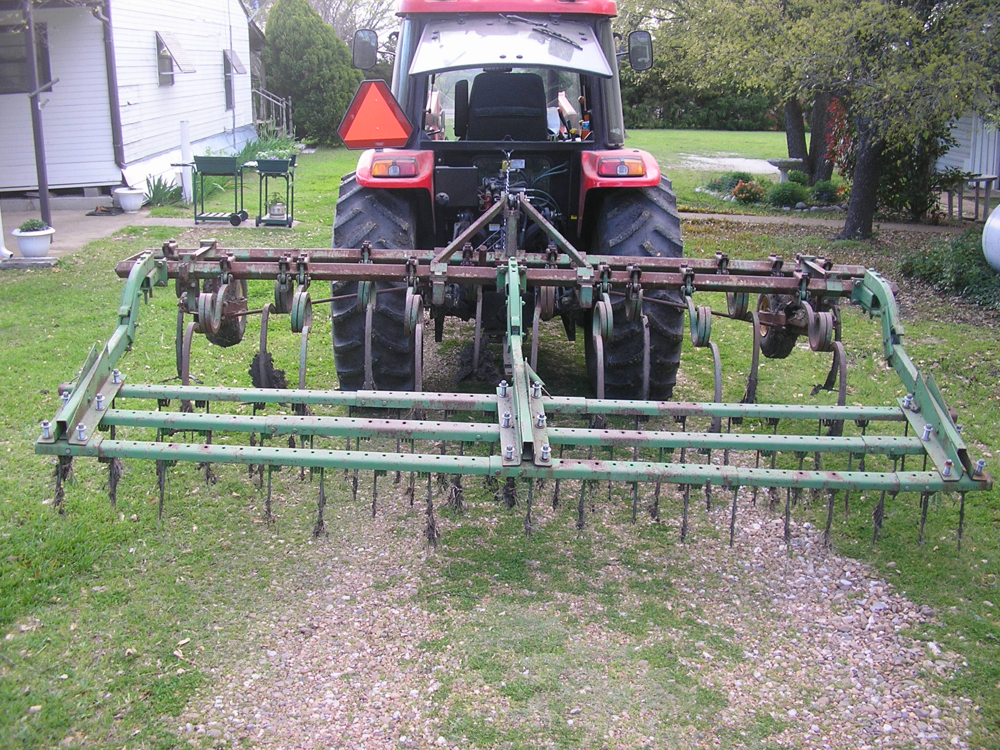

Soil is Houston Black Clay, (heavy). Sweeps are 10" for one of which I have a picture......and I can do it burning 0.047 gal/hp (65)/hr....just under 3gal/hr at 2600 rpm....no way could the 4230C do that.
Additional comment on small dia vs large dia discs: Here, initial plowing (sod breaking) is done with rolling blades and discs are commonly used as plows, including disc harrows. The blades need to be large in diameter to get some depth before the axle drags the ground. The implement in the picture only works on ground that has been softened up somewhat the previous season. Otherwise it would just bounce across (the top of) the ground.
