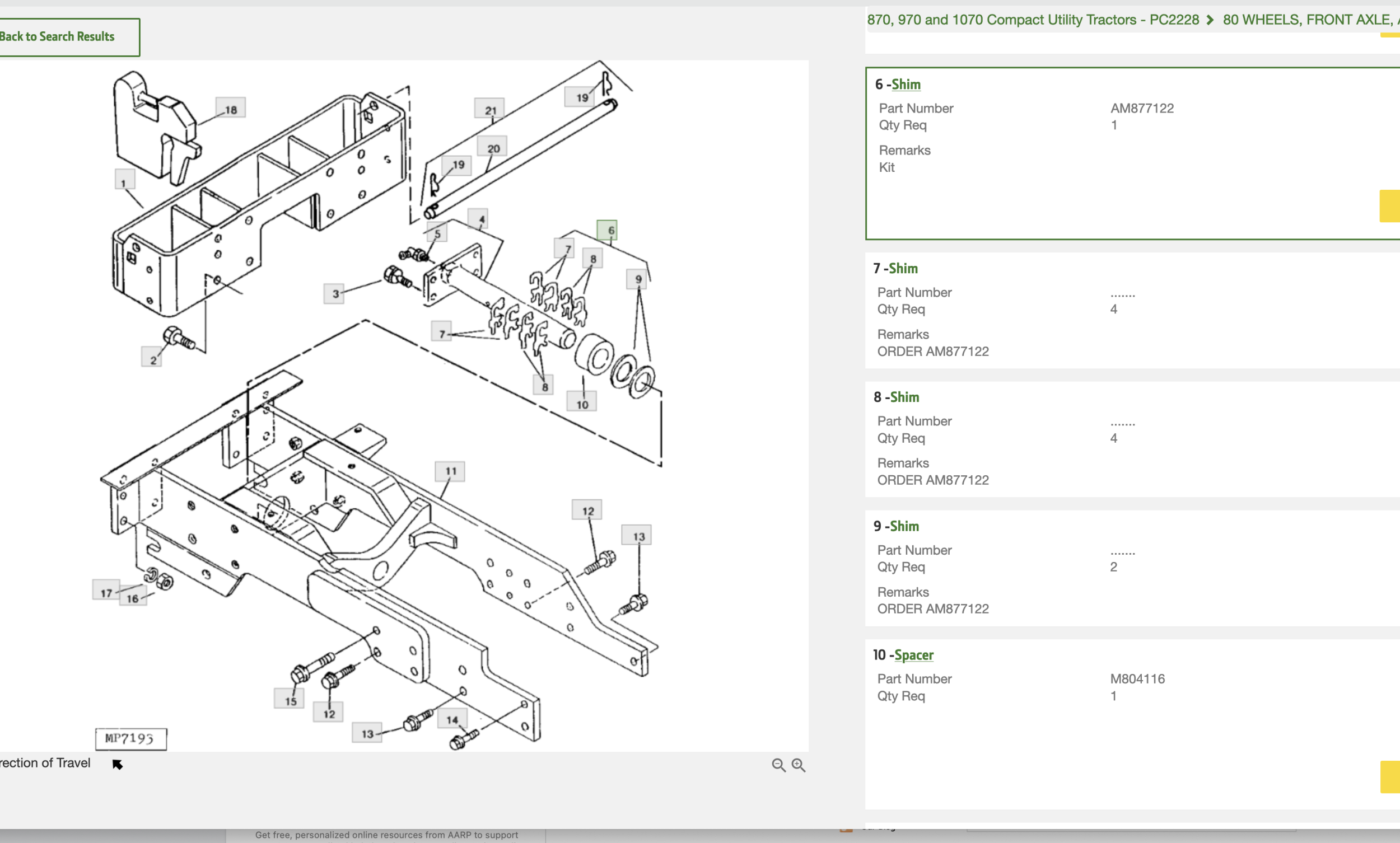

I have a 4wd 1070, some time ago the shims fell out and now I have lots of slop in the front axle when going from either forward to reverse etc I want to replace, but I've looked at the ipl and can't seem to find where (what ipl) they hid it on?

#6 shim kit should get you all the shims
