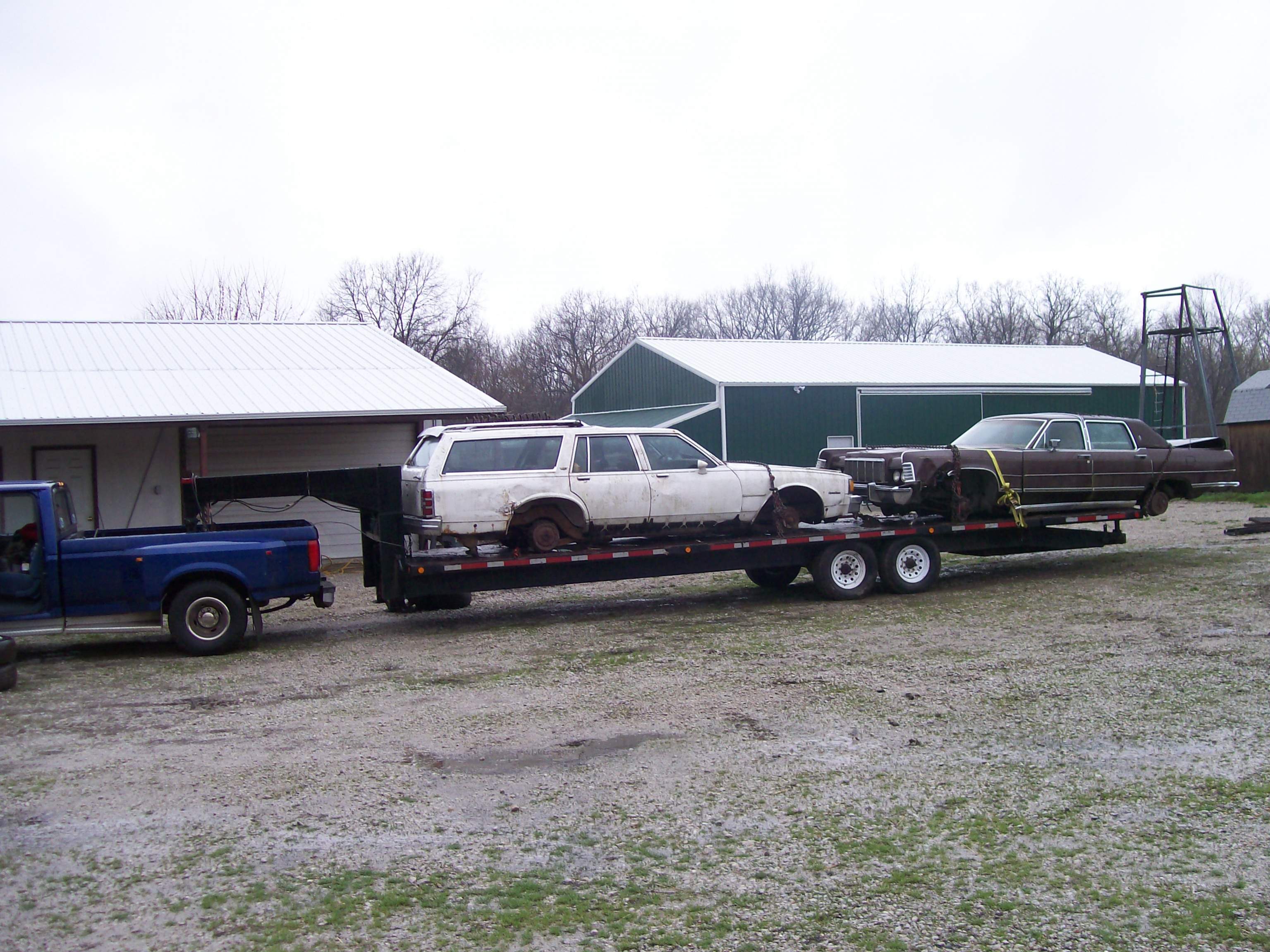

10K winch is mounted to 14K GN 20+5 trailer with deep cycle by its side.
Tomorrow is the test trying to load a 1960's era car.
Anybody ever winched a car or truck up onto a deckover trailer??
How well did it work?? I have drove and used chain hoist to get many cars and trucks on a normal car hauler but never up on a deckover...

Only a few hundred times some didn't even have wheels 8K ramsey to the truck bat. On larger loads I use a doubler block.

Car was winched up and down off my GN deckover with no problems at all. Used a Deep Cycle battery to power the winch and it all worked great.
Thanks for the help
