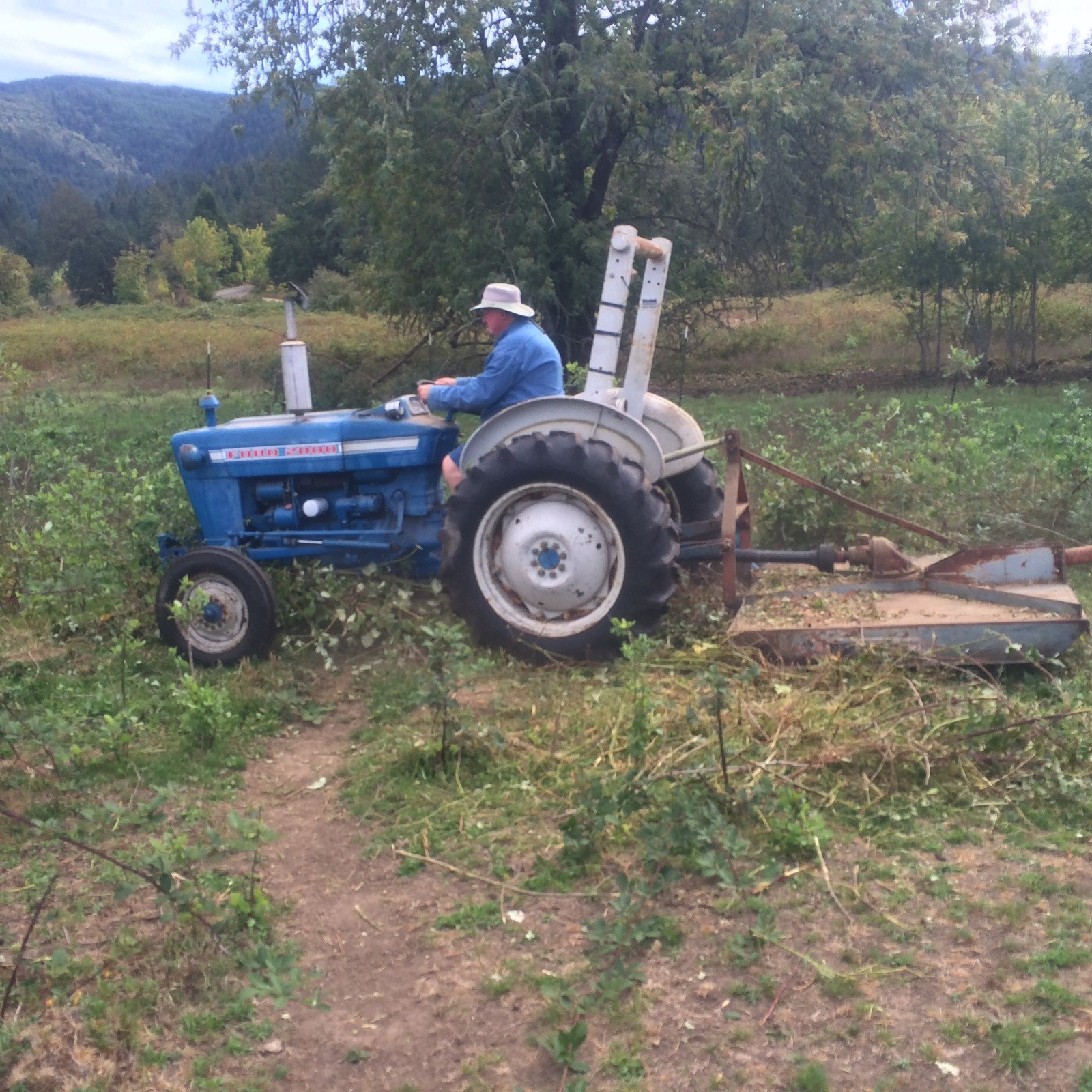

Good advice except your forgetting that synthetic oils bond to metal better and don't flow off like conventional oil. I discovered this entirely by accident. I am the 2nd owner of a Ford 2000 Diesel tractor I use synthetic oil in andabout 12 years ago I had just changed the oil and my neigbor came over to ask a question which i answered then went to work out in one of my pastures brush hogging. I noticed the oil light come on but paid little attention because i had just changed it but it bothered me after a half hour or so hoggin I disengaged the pto and drove the 1/3 mile back to my shop to see what was wrong with the oil light. This old tractor dosen't have the best gauges and i don't trust them. Well the first thing i do is look at the dip stick and much to my surprise it was dry. Then i noticed there was no drain plug in the bottom of the pan. At that point I knew what happened, the last thing i do after screwing in the plug by hand is tighten it with a wrench and because of my neighbor i missed that step so the plug must have fallen out on the bumpy road over to the pasture. I must have hogged a couple of acres and driven at lest a mile or two with NO oil in the engine. Well I figured i had just killed my old tractor but put a new plug in her filled the crancase up with amzoil marine oil and fired her up. She ran perfect no smoke and 12 years or more later still runs perfect and this ole tractor gets about 100 hours of use hoggin each year. The only way i can explain away the no damage is that the syn oil really does bond with the metal protecting and lubricating even without being renewed. Thats me on the old tractor in the pix the Colonel took in 2016.
