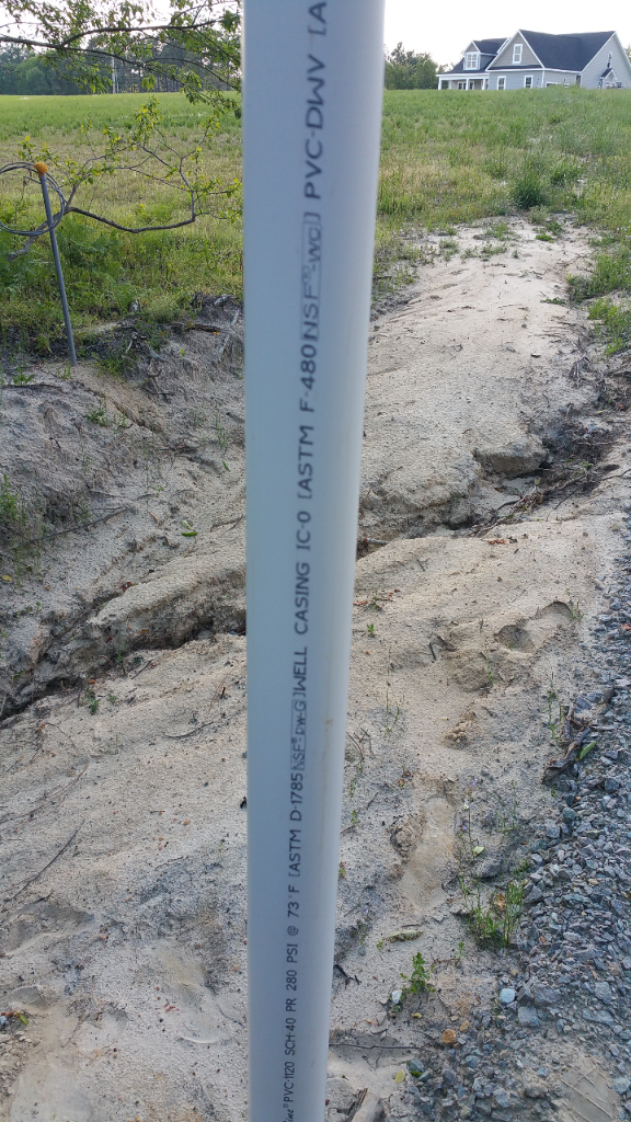

That looks like sch 10 pvc .....is it sch 10?
How long is the run?
What is the static pressure?

The run is about 1300 feet with a good elevation change (valley) in the middle. They used schedule 40. Attached is a picture of the pipe. I know that after the pressure reducing valve the pressure is around 60-70 psi. Screenshot_2017-05-13-04-37-01.png
   / $11,000 Water Bill #24
That was a small leak at the joint and the smooth hole is just warn that big and smooth from the leak looks like it's been leaking since day 1. That is good pipe I've had it buried in gravel for over 25 years now with no problem. I have repair a no. of water leaks wear the pipe looked like that just from the water pressure enlarging the hole.
Abrasive swirling sand slurry! Make perfect sense. I couldn't understand why the hole looked like that. Thanks. :thumbsup:

Looks like the plastic pipe melted. That is not a fracture or crack for sure. Seems to me somebody did not install properly.
I just had my water company (community well on meters) call me about abnormal water usage for the month. They monitor comparing last year's volume. Turned out I had a break in the PVC main line. 30 year old install. Water company gave me one time relief (once every 10 years) for paying the surcharge for the water. I would talk to you water company and builder. Maybe have an independent guy come out to inspect and determine cause. The builder won't be your friend most likely.
It's right at the joint too.

That looks like 1" PVC? I don't think that pipe could carry that much water at that rate. Let alone the small hole.
