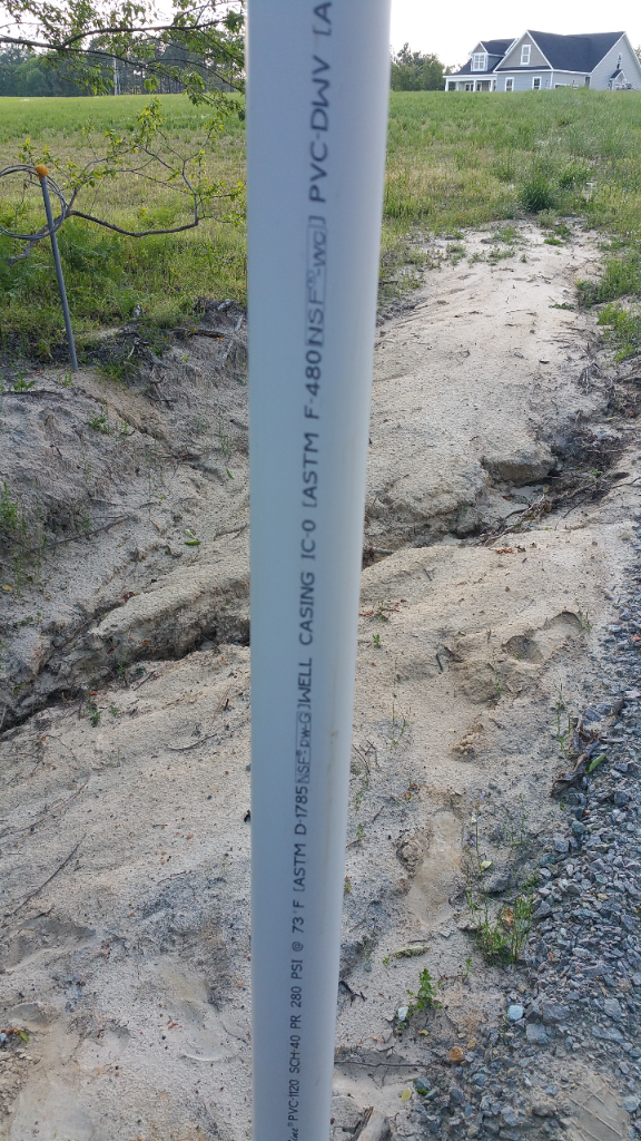

What do y'all think about the replacement line. I'm going to have it replaced. The options are 200 psi HDPE in 500 foot sections or PVC again. The pvc would have over 50 connections. The black pipe would have three.
   / $11,000 Water Bill #38
x2, i generally just call it black poly pipe/hose. less connections, and the hose goes with the trench it is put in, if the hose is put in correctly. snaked / weaved / wave pattern (side to side) within the trench. it can move back and forth up and down some without putting extra stress on anything.
sch40 or like pvc hard pipe. does not really give. and any slight angles tends to put stress on at the joints. or not fully seated joints.
sch40 pvc and like joints, can be rather troublesome, if not pressure tested, before being burried, and inspected. even after being buried. if the pipes were not properly chemical welded (most folks call it glued), the pipes can still come apart.
if the trench is not properly back filled with clean soil (no rocks and other junk in it) along with compacting the trench as it is back filled. the pipe can end up cracking/breaking more easily. as everything settles over time, resulting in empty voids under sections of the pipe.

   / $11,000 Water Bill #40
The run is about 1300 feet with a good elevation change (valley) in the middle. They used schedule 40. Attached is a picture of the pipe. I know that after the pressure reducing valve the pressure is around 60-70 psi. View attachment 509302
The pic in this post show's the pipe is "DWV". I'm not a licensed plumber but as far as I know the "DWV" means Drain-Waste-Vent, only!
