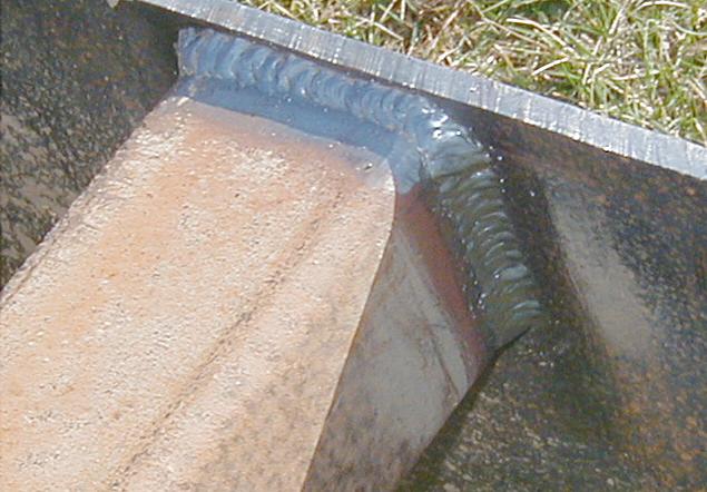

I have a Lincoln Pro 100 mig welder that I've used on thin sheet metal (quarter panels for a hot rod for example) and I've welded up to 3/4 inch steel (building a hitch). I built a few things that have some thick metal on them. The links below are a few things that I've built using my 100 amp mig welder. I'd like to have a 220v unit but my 110v units does everything that I have asked of it. My shop is wired for 220v, so that is not a issue. And if it wasn't, I've wired a dedicated 220v plug for it (all it takes is two 110v lines...simple).
