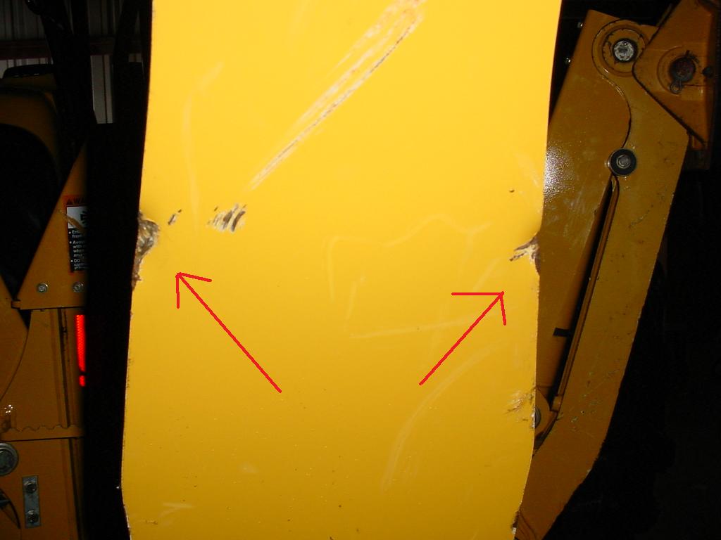

his is bending the arm.
   / 110 tlb thumb question? #22
I thought just leaving it off may have been the best in the other case. Your setup seems to support the stop is a bad idea on the 110 thumb set up. How many times have you used the thumb? It tagging from time to time would not concern me.

No, it does not appear to be bending the arm. I have only had the 110 for about 2 months and have used the thumb a couple times.
   / 110 tlb thumb question? #24

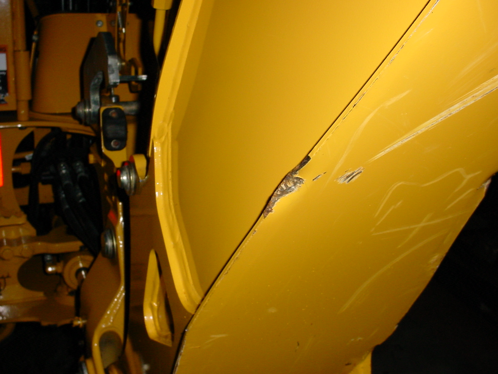

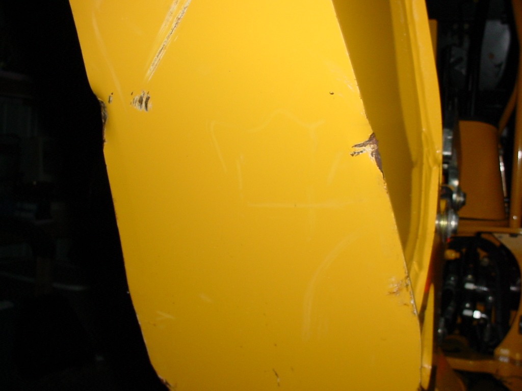

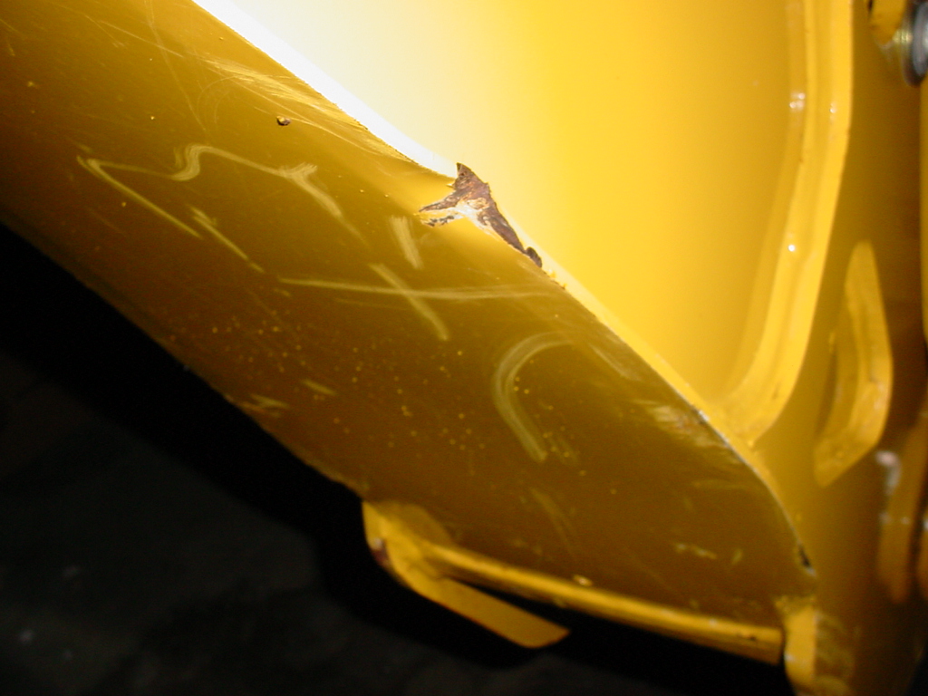

in this photo you can see that someone closed the arm with the thumb opened and did some damage
Whoa... really??
I thought that maybe I'd "overreacted" and concluded that the issue was really a matter of misplaced "concern". So, I went back and carefully looked over the OP's initial photos. Nah, I didn't overreact; the problem is really misplaced concern! :eek:
You might wanna go back and revisit those pictures as well.
Look at the front plate of the dipper arm. Please note the concave surface and the inside gap between the dipper and the contact/wear plate. During the final welding and construction of the dipper arm, the surface of the arm developed a "normal" concave.
I would bet "dollars to donuts" that virtually every boom arm and dipper arm you'd care to inspect - irregardless of manufacturer - has some distortion. Every sheet of flat steel or plate steel that I've ever looked at has a measure of warpage. Before... before it's ever been welded! A perfectly flat surface or perfectly square dimension is a fantasy.
I'd like to see photos of straight edge measurements taken along the face of the boom arm and dipperstick ALL THE WAY to the thumb - beginning at the bottom of the boom arm.
AKfish

Take it easy fish, I was just doing a comparison to Doc's dipper stick. What do you think of his photo's???

Was this done with an OEM JD thumb like showed in the first post on this thread?
To me it looks more like marks made by the bucket teeth.
maybe your right, i just assumed that it was from the thumb
Ok... here's when I'll have to admit to making a dumb @ss move with my 110 backhoe! :) 'Cause I've got a dent along the edge of my boom arm - just like that!!! :mad:
If you leave the stabilizers in the up position and swing the hoe from side to side.... well, the backhoe is NOT designed to do that! And those darn stabilizer feet will absolutely crimp and roll it over; that 1/2" (might be 5/8") thick plate steel! Aaarrggh!
I only did it on one side, though... that was enough. 'Course, if you were in a full-blown swing motion - it would/is very hard to stop that motion with those legs up - the whole back end of the tractor is swaying! And you could crimp both edges.
AKfish
