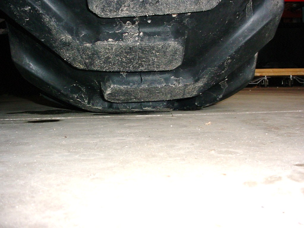

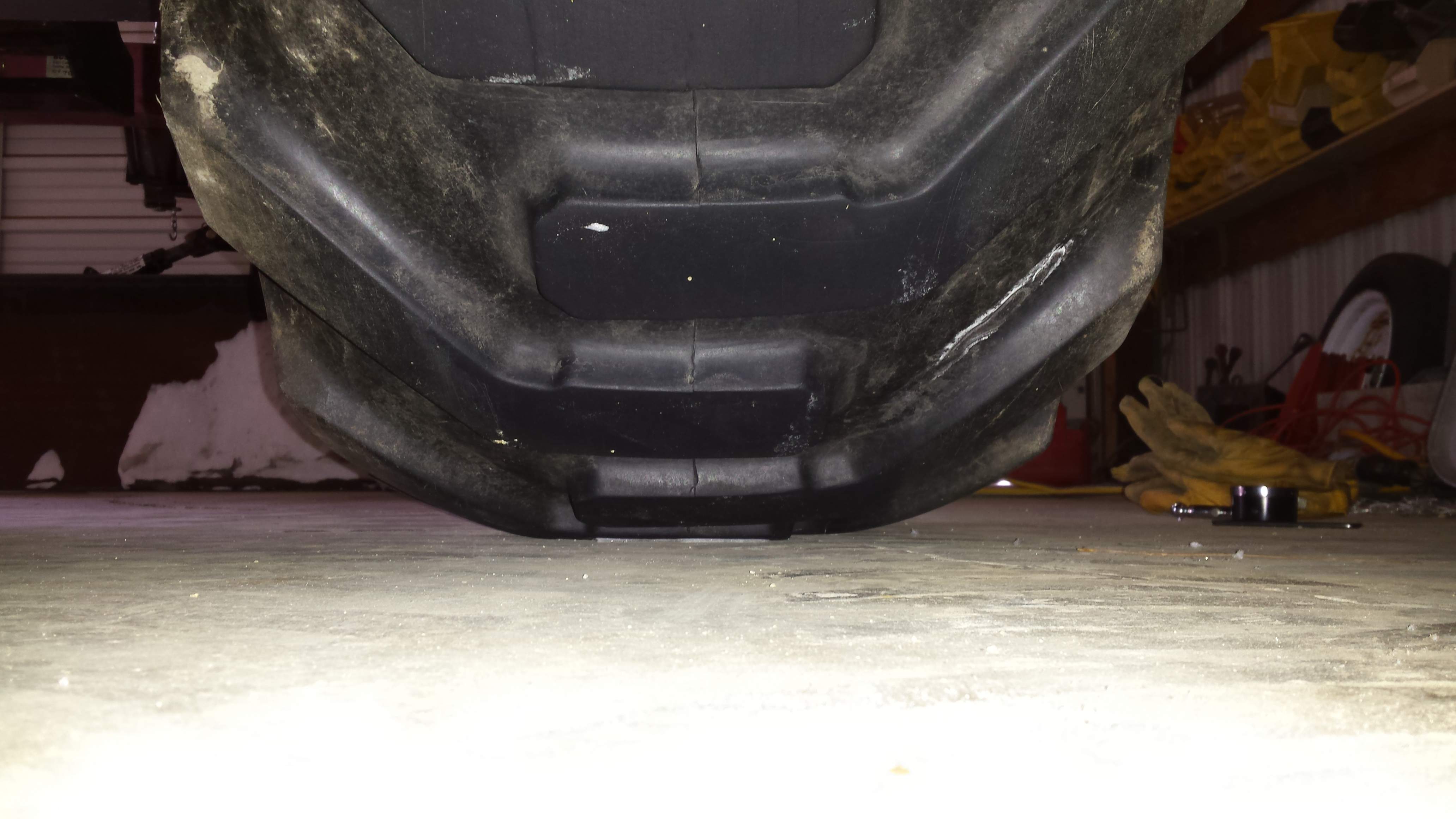

Just thought I would post some photos of before and after, notice how much of the tire makes contact with the ground.
Thanks to all for helping me with the tire pressure. And thanks GreatWhitehunter for starting this post!!!!!!!!!!!
Who knows how long I would have operated my tractor with the tires @ 50 psi
50 psi
15 psi
