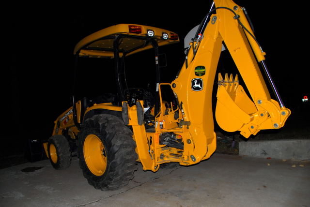

I'm thinking loaded tires would help without the hoe. The dealer delivered one for demo about an hour before dusk. Trying it on the drive in high range, it felt fairly bouncy. Again, I am hoping loaded tires would help that. Backed it up a slight slope and cycled the FEL. It still jerked and groaned some. After cycling it a while and after it was warmed up a bit, it did seem to settle down some, but it still isn't as smooth as the BH controls yet. In fact, it seemed to be more jerky with higher rpms than with lower rpms. I took it over to where a 12" dia tree was cut. It pulled the stump fairly easy. I'm starting to like this machine!
I am wondering if the bucket needs to be loaded for it to smooth out or if it needs a break-in period? Hopefully, I'll find out tomorrow.
Anyone else here run one with loaded tires? It comes with a 72" HD bucket and all the hydraulics options. List of thing to add:
Skid plate
Thumb
Loaded tires
Anything else a must have?

My dealer was very reluctant to load the tires, wouldn't say why, but just didn't want to do it.
I have to say that in 3 years I have never felt the need for loaded tires.
I have an Addington thumb because there were reports of the Deere thumbs being too soft when I was buying it. I have no idea about the current state of affairs, but I am satisfied with the thumb I have. With any thumb, it is not recommended to use the 12" bucket, and the reason is that the way the thumb mounts, a pin longer than 12" is used, so a 12" bucket would have this pin dragging in the dirt.
AKfish: I don't know about removing the FEL bucket with the hoe off. Clearly this makes the machine less "tippy" toward the front, but I think it might be better to have the bucket on. If it does tip to the front, I would much rather have the bucket hit the ground than the ends of the FEL arms. Sort of a moot point for me since I don't really intend to ever use an implement other than the box blade on the rear.

I believe that much of the bounce comes from the tires. The 110 rides just like other construction equipment that I have operated; JD 524 and 544 loaders come to mind. I just slow down when the road or trail is rough, 'cause when you get that harmonic "wave" bounce going; it's not a happy time maintaining control. (If you've ever seen heavy equipment start that bouncing "wave" motion going down the road; you know what I'm talking about.) But I don't seriously believe that loading the tires will change that dynamic.
The hydraulic controls are more responsive and therefore less forgiving of operator miscues. Especially at higher rpms. The FEL and hoe will jerk (very quickly..) and can inadvertantly "smash" things before you can get the word "Sh@#t outta your mouth! So, take your time and keep your rpms down while you're still figuring everything out.
Curly, I can appreciate what you're saying. I think the primary safety concern operating the 110 without the hoe is front to rear stability especially when attempting to use the FEL to move heavy materials. Of course, when the rear end gets light and lifts upward, the machine will begin to tilt off to one side or the other and could roll on it's side.
That said, I would not use the loader without significant rear-mounted ballast, etc.
My HD 20" bucket and thumb are from a JD 27 ZTS mini-excavator. It's a pretty stout configuration - IMO.
If you plan on using chains, you should consider rear wheel spacers. Heavy 3/8" chains will not easily clear the inside of the fenders and will likely rub the inside of the fender.
To genuinely make a fair comparison - is there any chance that your dealer would have a 40x20 machine that he'll let you demo? Even without a hoe, it might be worth your time to work the FEL and experience the ride and control layout, etc.
Best of luck with whatever you decide.
