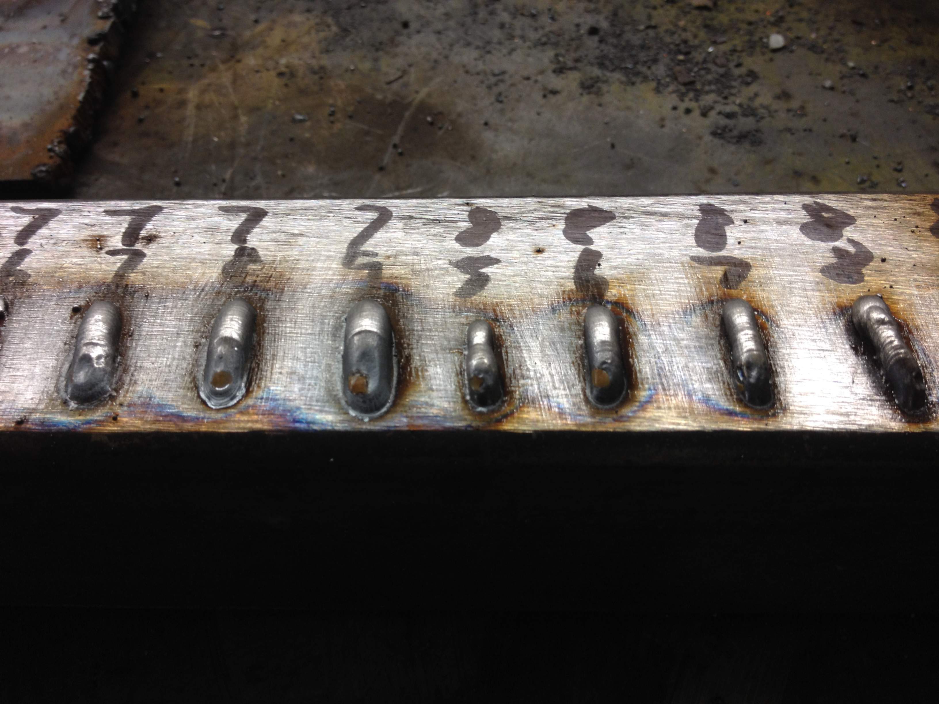

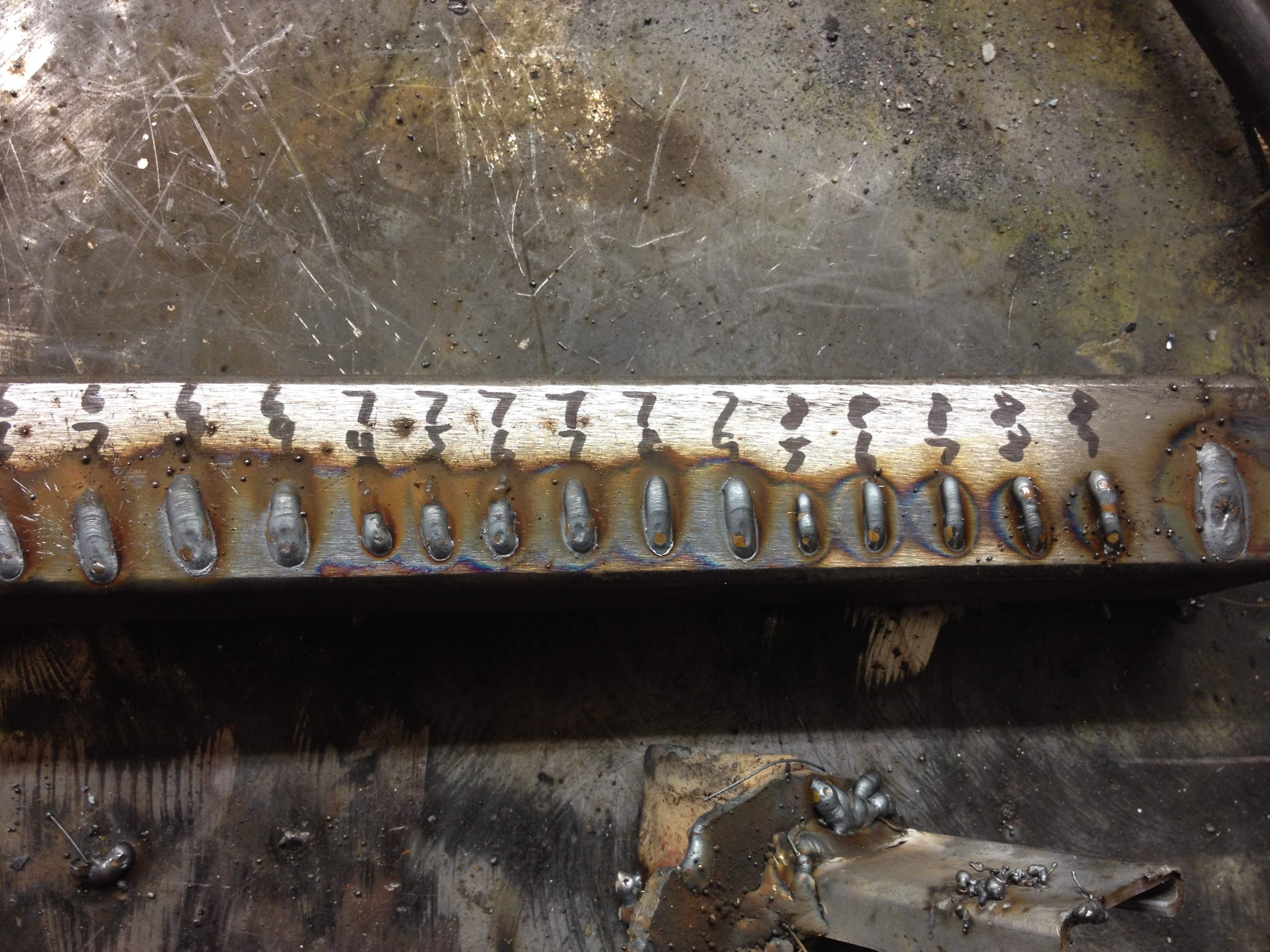

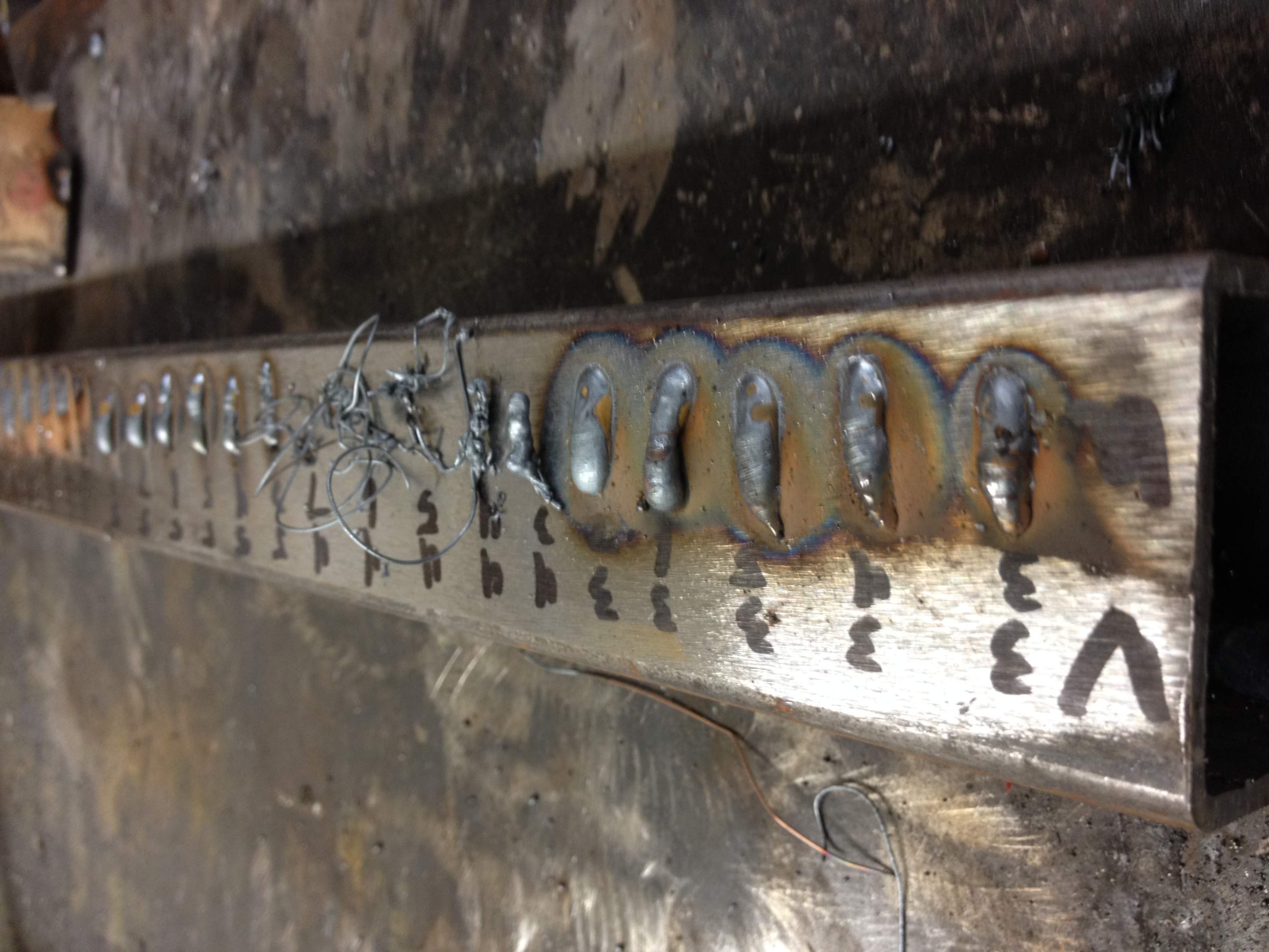

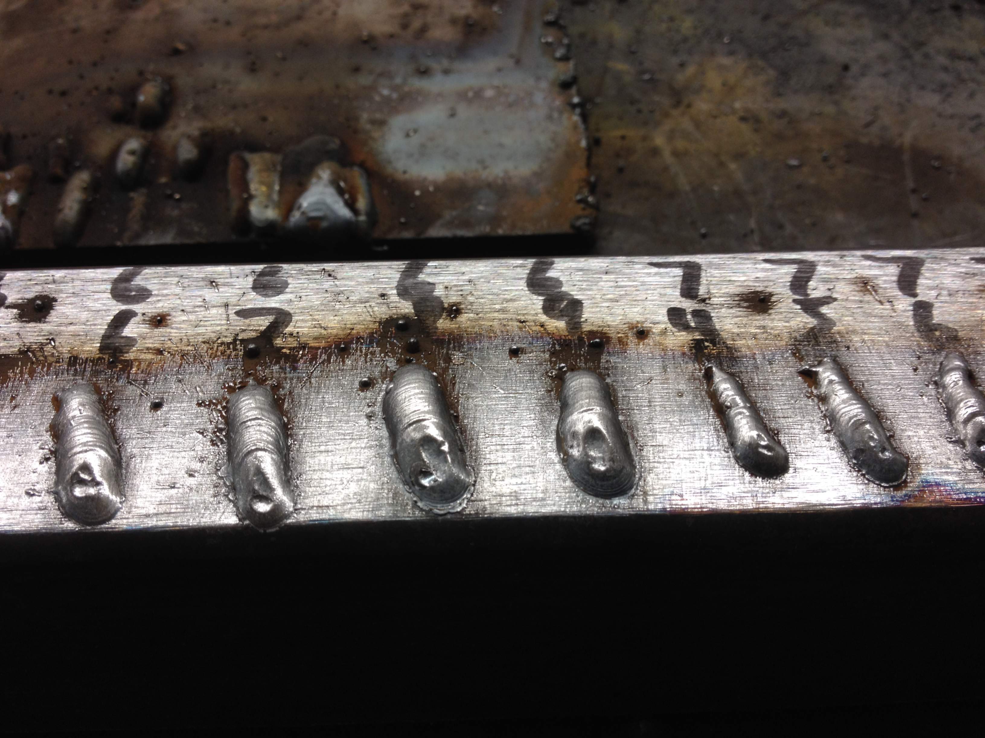

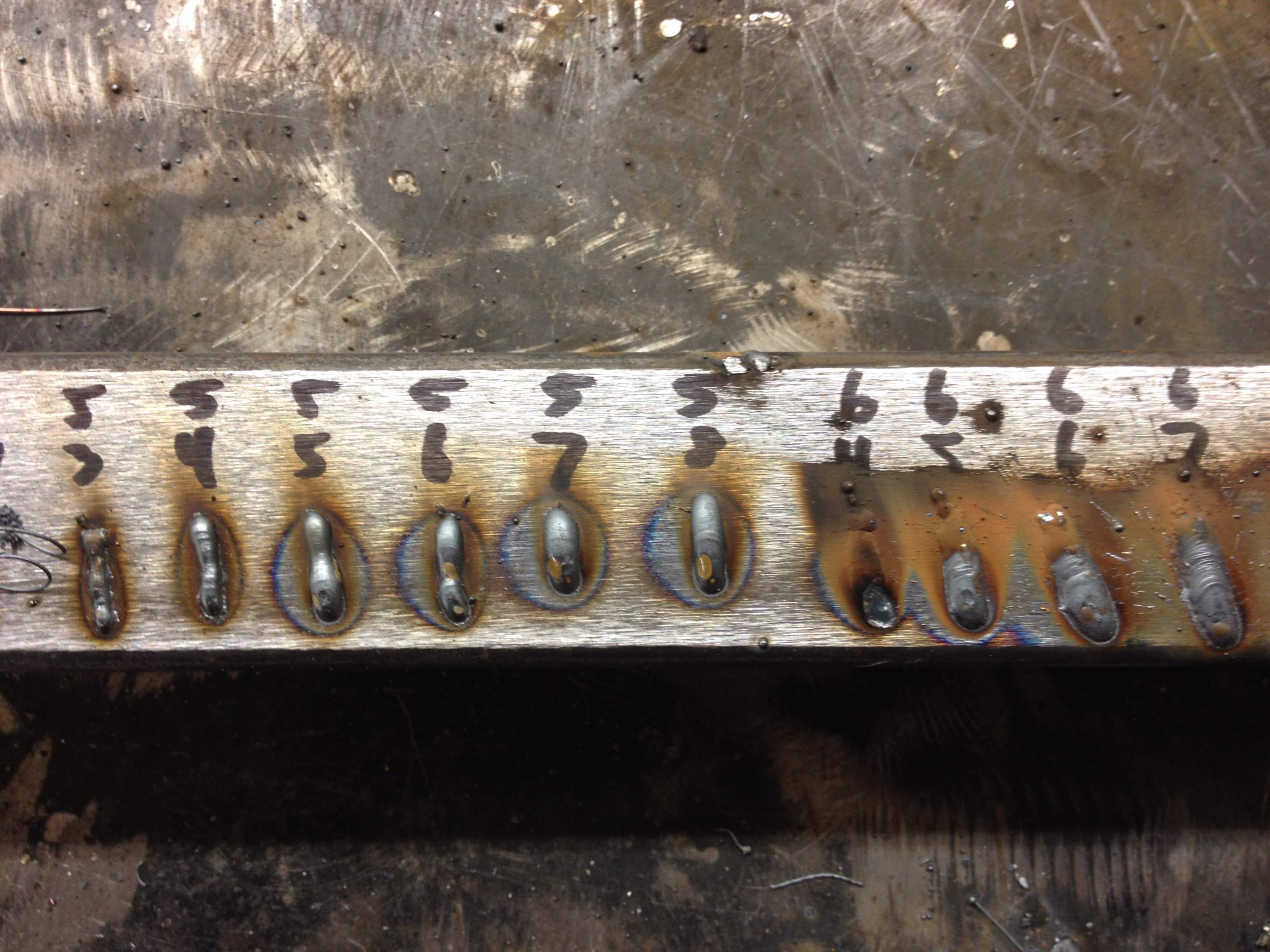

It seemed to be in good shape when I opened it up. I don't really know what the deal is. I could get it to run fine at times and then it was like something changed. When the wire was not even striking an arc I knew something was wrong as I have never had that happen before. I immediately figured it was a ground issue but after checking connections that did not seem to be it. My uneducated guess is that something is wrong with the voltage dial on the machine causing inconsistent performance and dead spots, specifically at voltage setting #4. I'll post pics.

This is where I resorted to testing each voltage setting and wire setting. The top # is the Voltage and the bottom # is the Wire speed. As you can see on Voltage 4 the wire just curled up.
   / 110v welder and the 3/8 bend test #88
That is so strange!:confused: I don't remember having one false start. Makes me wonder if a wire didn't get knocked lose in shipping!
