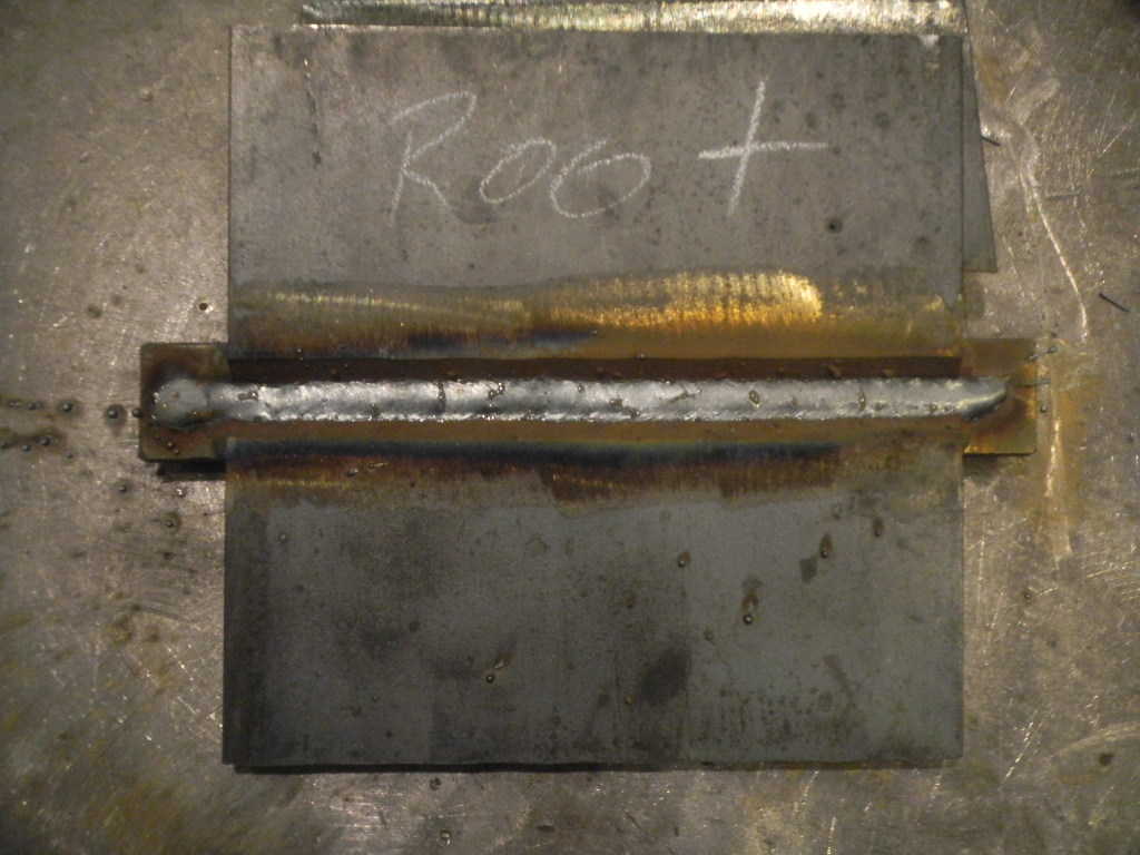

Remember this is the root pass of the V-butt test plate?

I agree. The real issue is not striking an arc when wire hits the base metal. See the pics of voltage level 4 where the wire just curled up. Then it started doing the same on Voltage level 7. That's when I decided to stop since it wasn't really even welding at that point.
   / 110v welder and the 3/8 bend test #100
That's what makes me think a wire got knocked lose during shipping from here to your place. I tried to pack it up just like it came to me.
