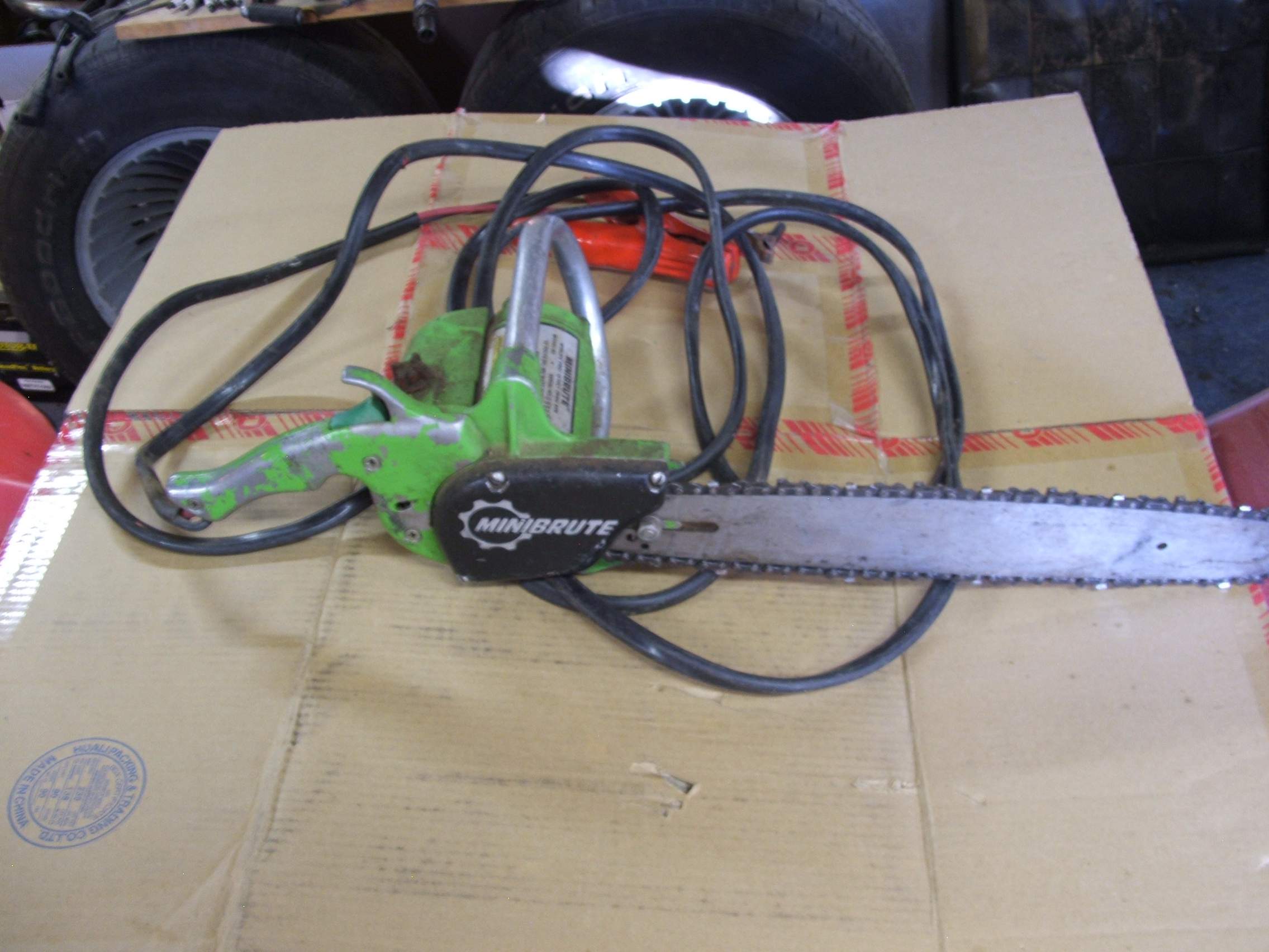

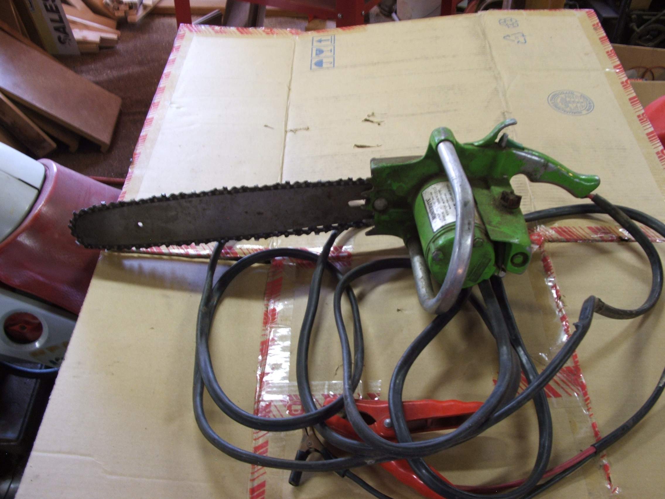

/ 12 Volt Chainsaw #31
The one I posted pics of above is $75 shipped. You want me to hook you up with seller? I dont really have a use for one.
He says everything is there and works as should.
