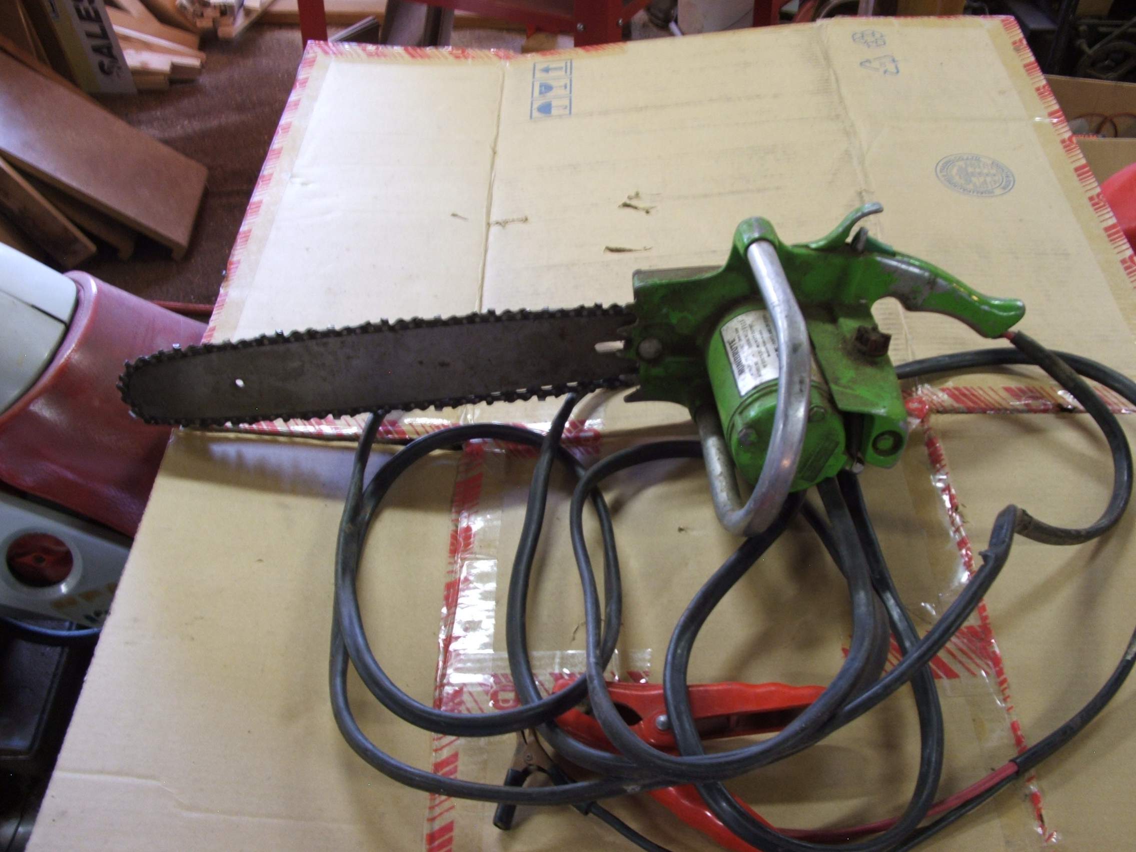

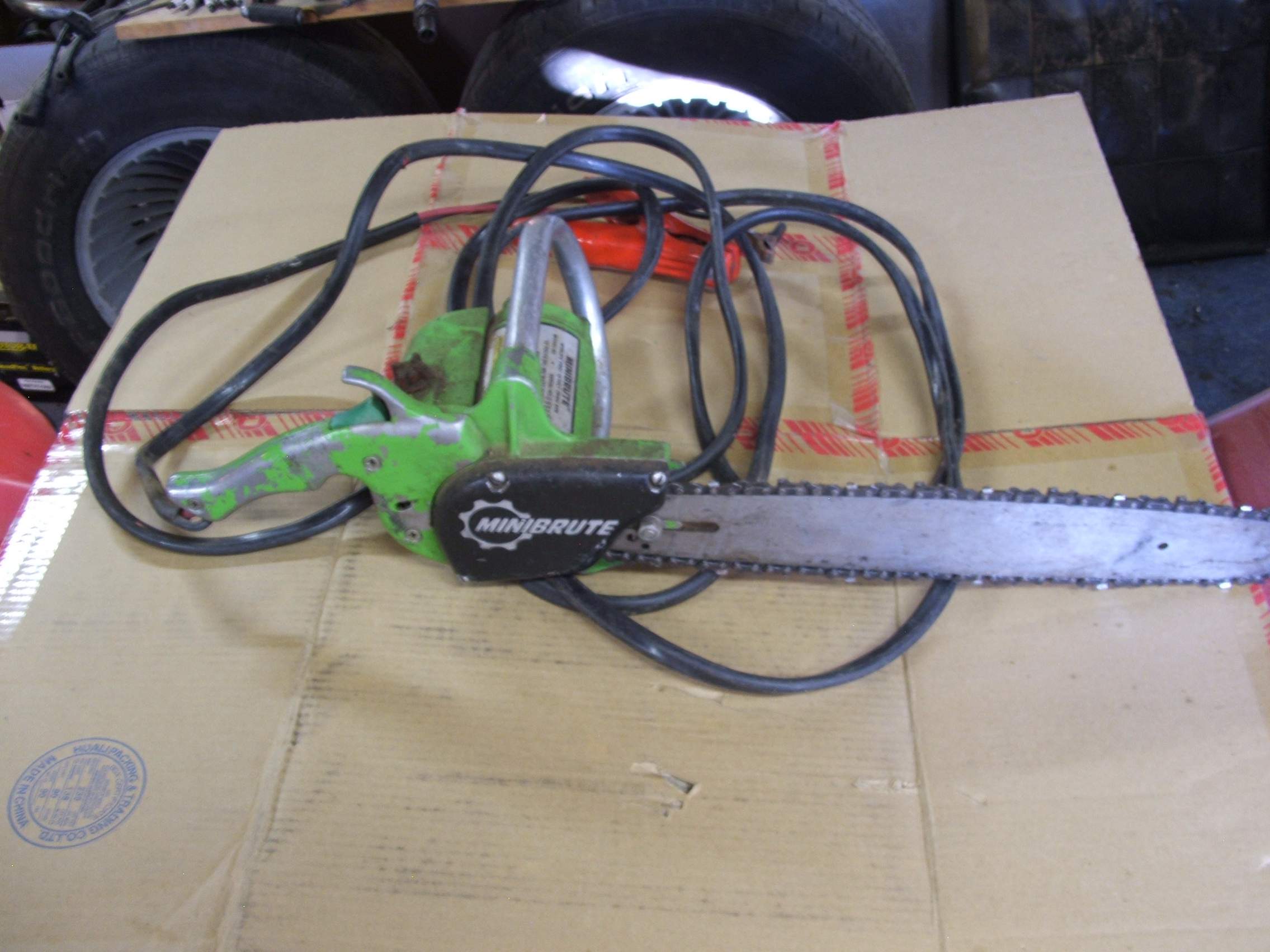

It prob weighs 10# or so.
I wanted it for my log splitter for the ocassional trim here and there. My splitter has a 12V DieHard powering it, works for me...
Any idea on what years these were made? from ? to ?

PS< A reminder if anyone reads this I am looking for an oil plug for fit this baby.
The thread size is smaller than 1/2" NPT and Larger than 3/8' NPT , the thread
pitch I can only guess is somewhere between the 3/8 and 1/2" as well, I do
not think it is a tapered thread.
The OD of the plug is almost 1" exactly(.98"), a hair under.
The OD of the O-Ring is .85"
The threads protrude below the bottom of the o-ring .24" but as long as I match the thread it matters not the length.

OK I think I figured out the oil plug. A 37* JIC fitting fits perfect thread wise, from a 1/2" gas flex. I went digging thru RUSSEL's parts and found a "Russell by Edelbrock 660283 Black -8 AN Straight Thread Plug" I do believe I can add
an O-Ring to that baby and have a forever plug, I ordered it, I will report when it arrives. I bet ya that lil plug killed many of those machines! There are only like 3-4 threads max in the body of the oil tank and it is plastic!

OK the Russel plug is a winner. The thread pitch is right and I am happy, Happy HAPPY!
The color is right, it has an o-ring and all is well. What a score.
OK so payin' it forward here, you guys that own a MiniBrute and have issue w/
that pos oil reservoir plug, just get yourself one of these babies and rejoice! :laughing:

It cuts well, it is not a tree feller*, but it is absolutely dangerous that is for sure. It is light at 7 pounds and it will be absolutely beautiful for the lil' trim here and there at the log splitter as I said. I am sure I will find other uses for it thru the years as well.
*Do not get me wrong, it absolutely will drop trees, but I suspect the motor will overheat first. It is a winner in my book. I will find many a use for it. I filed up the chain and oiled it up and clean it up and laid the cord in the sun and massaged it back into as new condition and VIOLA, I am very pleased with it!
PS, it is so very very quiet. I call it my George Washington 21st Century Special .:laughing:
