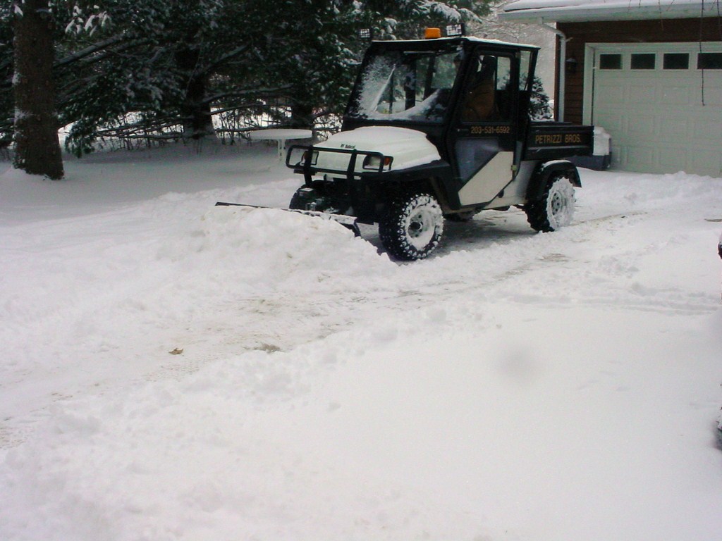

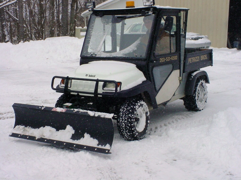

I had the same problem in my bobcat 2100. It also has a Curtis cab. The heater I used was from Harbor Freight. It was not the best but it worked and it was cheap.
12 Volt Auto Heater / Defroster with Light
