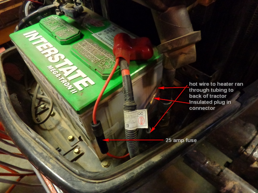

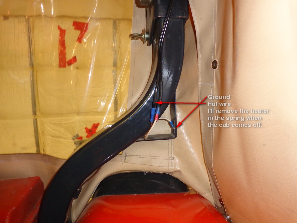

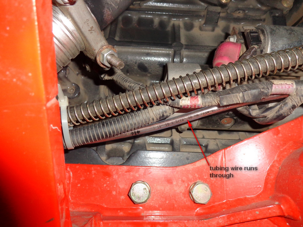

Read a post here some place about 12 heaters so for $36 I thought I'd give one a try. Haven't put it to the test yet but will tomorrow as it's nice and cold out. On 150w luke warm are and on 300w warm enough it's bound to make a bit of difference since the cab fairly comfortable just from the engine heat.

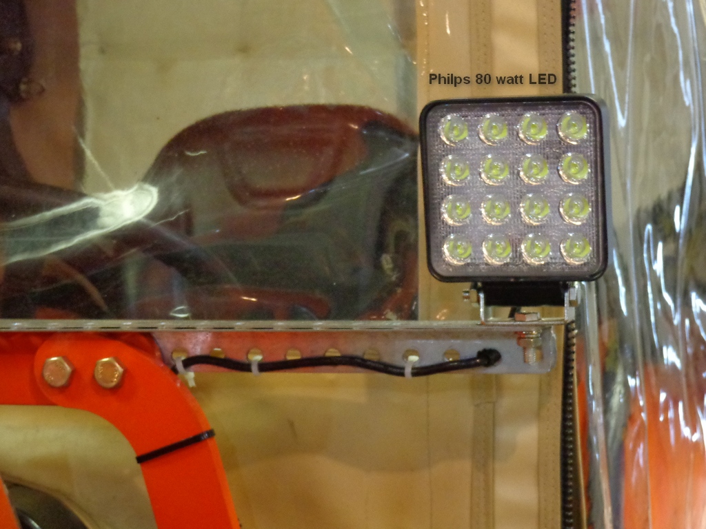

In stall this light a few days ago and plowed a few miles of skid trail the other night it was like working in day light I have a 45w flood out the back of the tractor as well both are connected to the light switch using existing extra plugins in the harness probably meant for factory cabs.

Boy, If you have 300 watts of "EXTRA" alternator output, your tractor must be fitted with something very special.
Mine only has a 35 AMP unit. 100 AMP alternators are customary for modern automotive applications.
If the alternator won't keep up, the battery is going to need to make up the difference.

You're confusing watts with amps.
/ 12 volt heater #5
At 13.8V it's going to draw 22A, not going to leave much for anything else if you have a small alternator...............M

The tractor has a 50 amp alt and the heater other than the fuel gauge is the only thing it would be running during the day is the heater so time will tell.
