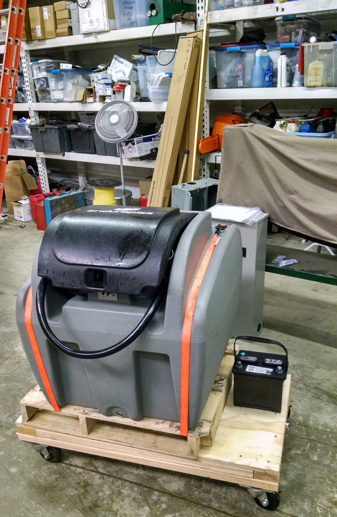

I also keep a spare 12v battery next to my tank. It only needs to be recharged once a year. Very low draw. fuel 1.jpg

I also keep a spare 12v battery next to my tank. It only needs to be recharged once a year. Very low draw.View attachment 605739
Sounds great and an option that I will keep in mind. Thanks
