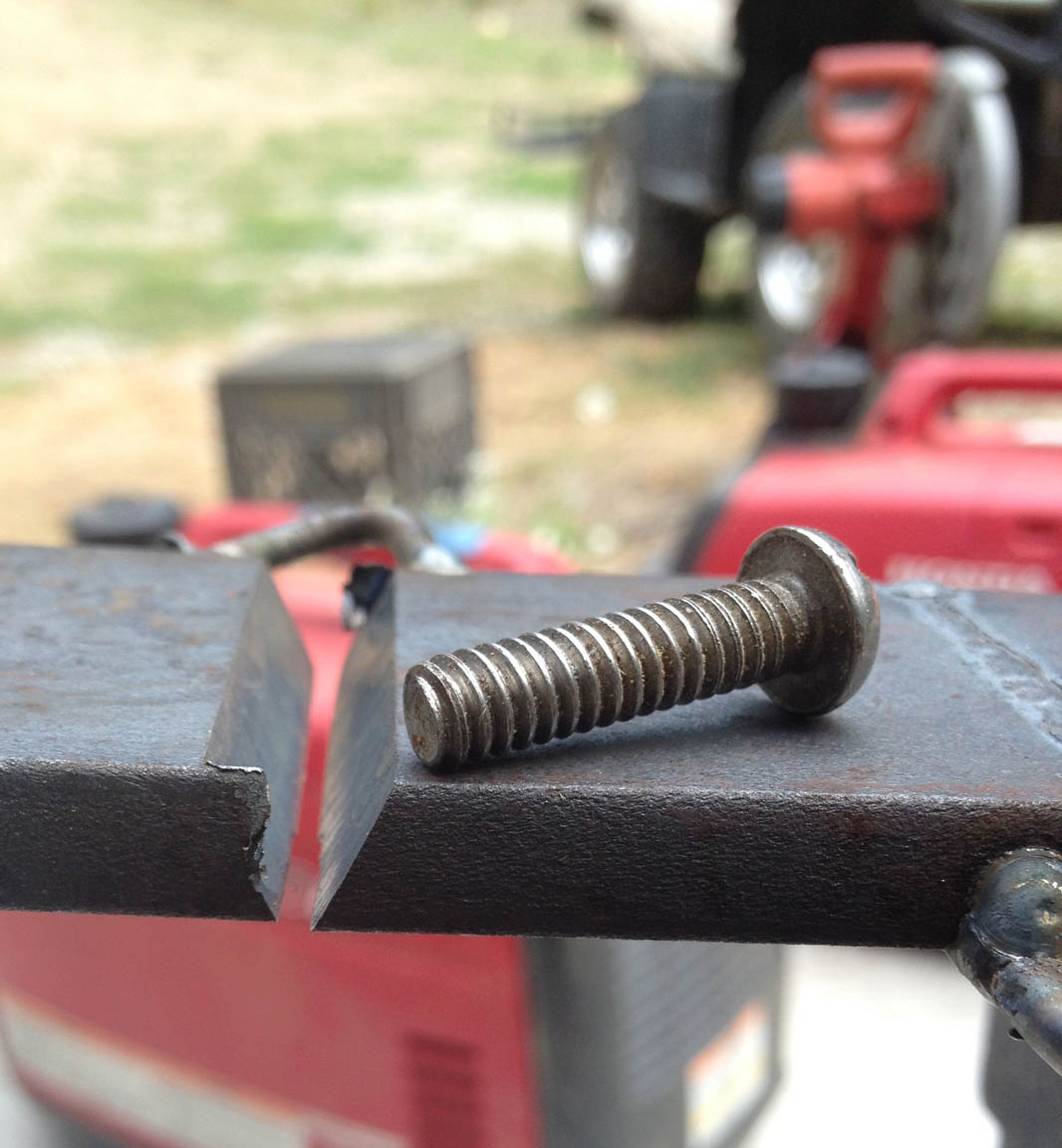

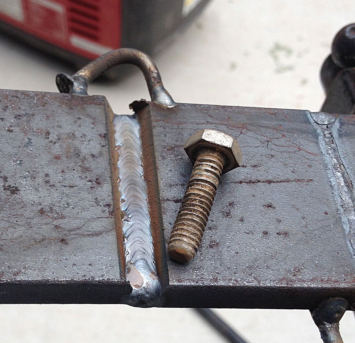

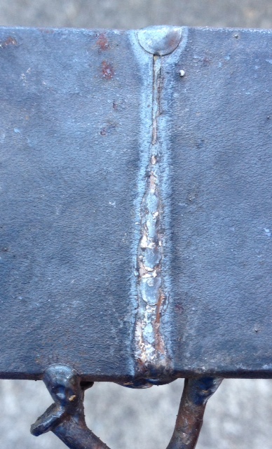

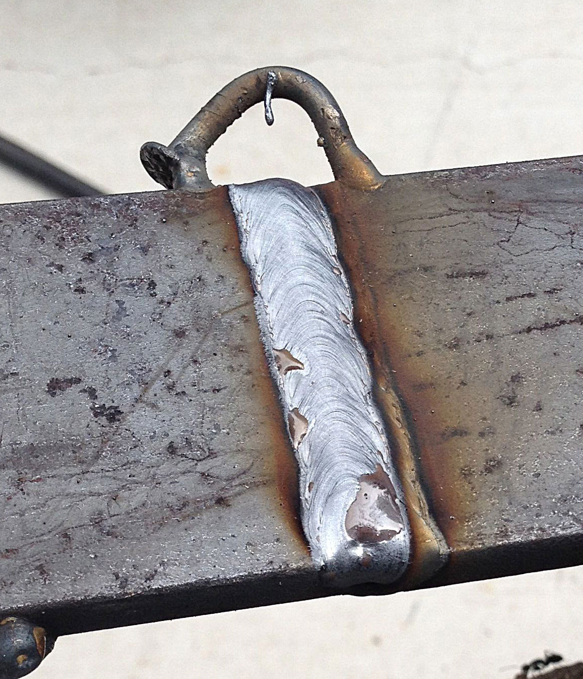

Here's a 120volt weld on 3/8" steel, 60 degree bevel. It's two passes. That's a 1/4" bolt for scale.
I have a 20T press but don't have any fixtures to bend it. Probably can whip something up, but do you think a guy with a 120V welder can actually construct a bending fixture that won't injure forum members in 3 adjacent counties? :D :D :D :D
** edit ** ooops it was 3 passes ****
Also added pic of the weld backside. No animals were harmed during the making of this test plate.

Give us some details on wire size, feed, speed, technique, etc... please. Looks pretty **** good to me but I know, pretty isn't what we are after.

I welded it to bend it, my intent is to see if it's strong.
I chose the 1/4" thickness preset then upped the voltage, reduced the wire speed and just welded like a sumb**ch. My wire is .030. Sorry I didn't make a note of the numbers and don't know any buzzwords.
   / 120-Volt Mig welder. #120
Thanks Sodo... that is pretty much what I was looking for. As I understand it, reducing wire speed makes the joint 'hotter' as well as increasing voltage.
