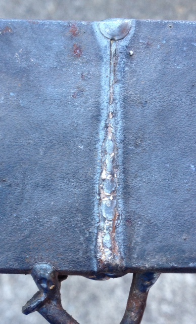

Sodo - looks like you dialed it in pretty darn good for your machine.
Were you able to get the knife edge to fully melt or did a straight line remain?

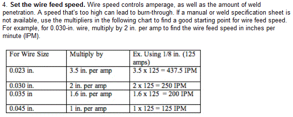

From Miller:
1. Material thickness determines amperage. As a guideline, each 0.001 inch of material thickness requires 1 amp: 0.125 in. = 125 amps.
2. Select proper wire size, according to amperage. Since you don't want to change wire, select one for your most commonly used thicknesses.
* 30-130 A: .023-in.
* 40-145 A: 0.030 in.
* 50-180 A: 0.035 in.
* 75-250 A: 0.045 in.

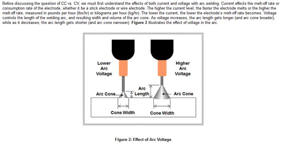

3. Set the voltage. Voltage determines height and width of bead. If no chart, manual or specifications are available for setting the correct voltage, you can try this: while one person welds on scrap metal, an assistant turns down the voltage until the arc starts stubbing into the work piece. Then, start welding again and have an assistant increase the voltage until the arc becomes unstable and sloppy. A voltage midway between these two points provides a good starting point.
There is a relationship between arc voltage and arc length. A short arc decreases voltage and yields a narrow, "ropey" bead. A longer arc (more voltage) produces a flatter, wider bead. Too much arc length produces a very flat bead and a possibility of an undercut.
4. Set the wire feed speed. Wire speed controls amperage, as well as the amount of weld penetration. A speed that's too high can lead to burn-through. If a manual or weld specification sheet is not available, use the multipliers in the following chart to find a good starting point for wire feed speed. For example, for 0.030-in. wire, multiply by 2 in. per amp to find the wire feed speed in inches per minute (IPM).

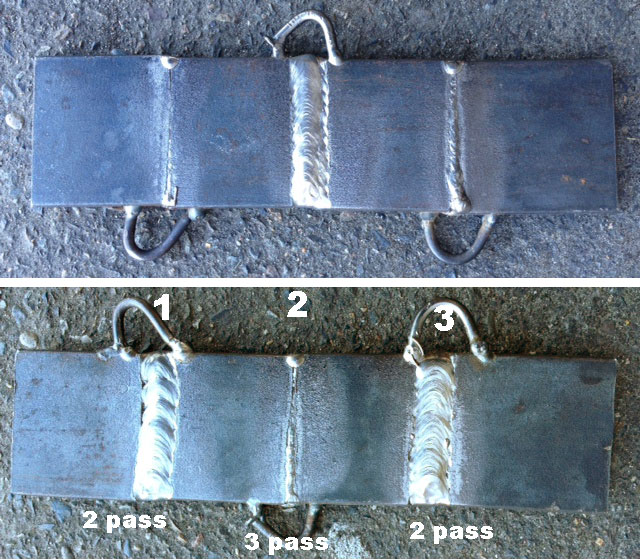

Hi Dave,
I didn't do any dialing in, just set it and welded. I had just a few minutes yesterday at my shop in the woods, and had to hustle. Plus I didn't want to waste my materials stock out there but its worthwhile if 120v discussion is now legalized.
Here's a pic of the backside. Thanks very much for the 120v tips they are appreciated!

Hi Dave,
That's looking pretty good - almost fused the whole root. :)
It gets mostly second nature to watch for the root to fully fuse while you weld.
When it's fused like that, without visible straight lines of the parent metal, you're good to go.
When you bend it, if the machine didn't have the power to penetrate into the base metal, the weld will tear out of the v-groove in some areas.
In extreme cases, the weld will pop out of the groove on one side and it will come apart.
Edit: forgot to add - a bend fixture isn't really needed for home use, just a big vise and a good size adjustable wrench will bend it 90 degrees and check it pretty well. That's what I do when I quick check a student's welds. Sometimes they just break apart.

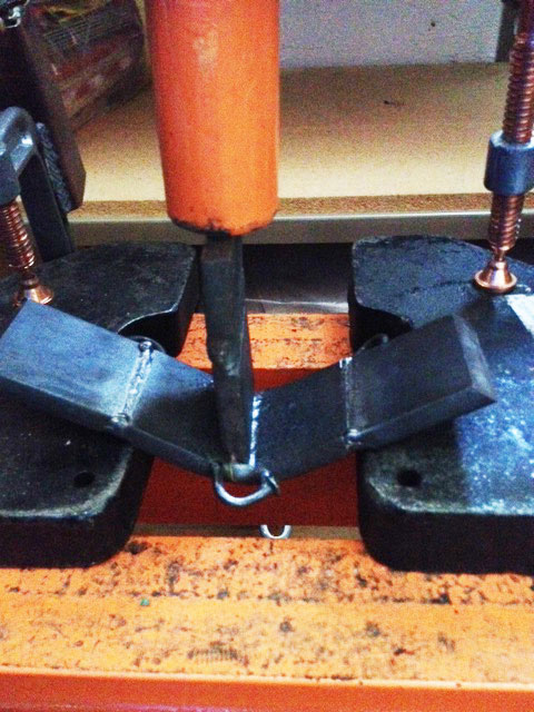

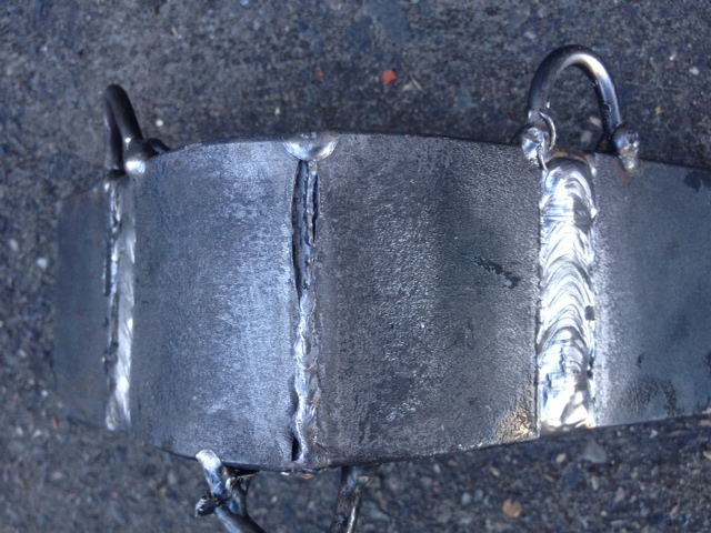

OK here's how the 3/8 thick test plate (welded with 120v) bent.
I bent only weld#2, the weld discussed earlier. It was very strong, had to reef on that 20T press to bend it to the 90-ish deg as shown.
From what I can see looking at weld #2 it's pretty obvious that:
---> #1 will be weaker
---> #3 will be stronger
But even though weld #2 was not 100%, it would not let trailer parts loose on the highway, it was firkin' strong.
