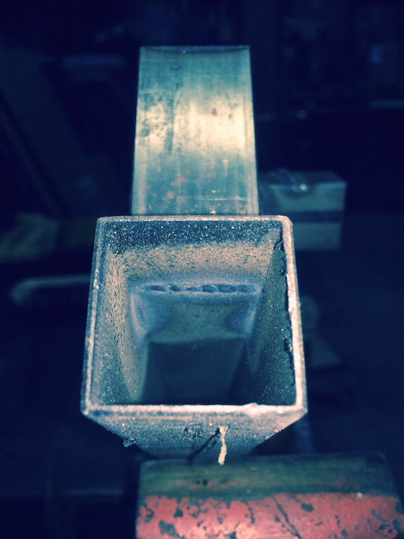

Watertight is no problem, it's a pretty quick pulse, about as quick as you can work that trigger finger. I have never quantified it but guessing from memory it's about 2/3 on, 1/3 off.
Why watertight, does it hold liquid? Or just to exclude water so it doesn't leak rust stains or fill with ice? You can do that with paint if the weld is decent.
This pic is 1" x 1" x .065" (=16ga) pulsed with .030 wire. You can make it a little tighter with .023 wire. I think you'll pick it up pretty fast.

Yeah it is more of it not collecting water inside and making a rust mess or filling up and freezing. But I also wanted to make a tool box for my tractor that is pretty much watertight. So... it is a skill I am trying to learn with sheet metal and tubing. I hate when I pick up something that has been sitting outside and I turn it and rust colored water pours out on my shoe. Just don't like water traps!
Using the exact tubing you mentioned, building a greenhouse bench, I was occasionally getting blow out with .030 wire. And dang it, I just got back from HD and forgot the .023 wire!!! :mur:

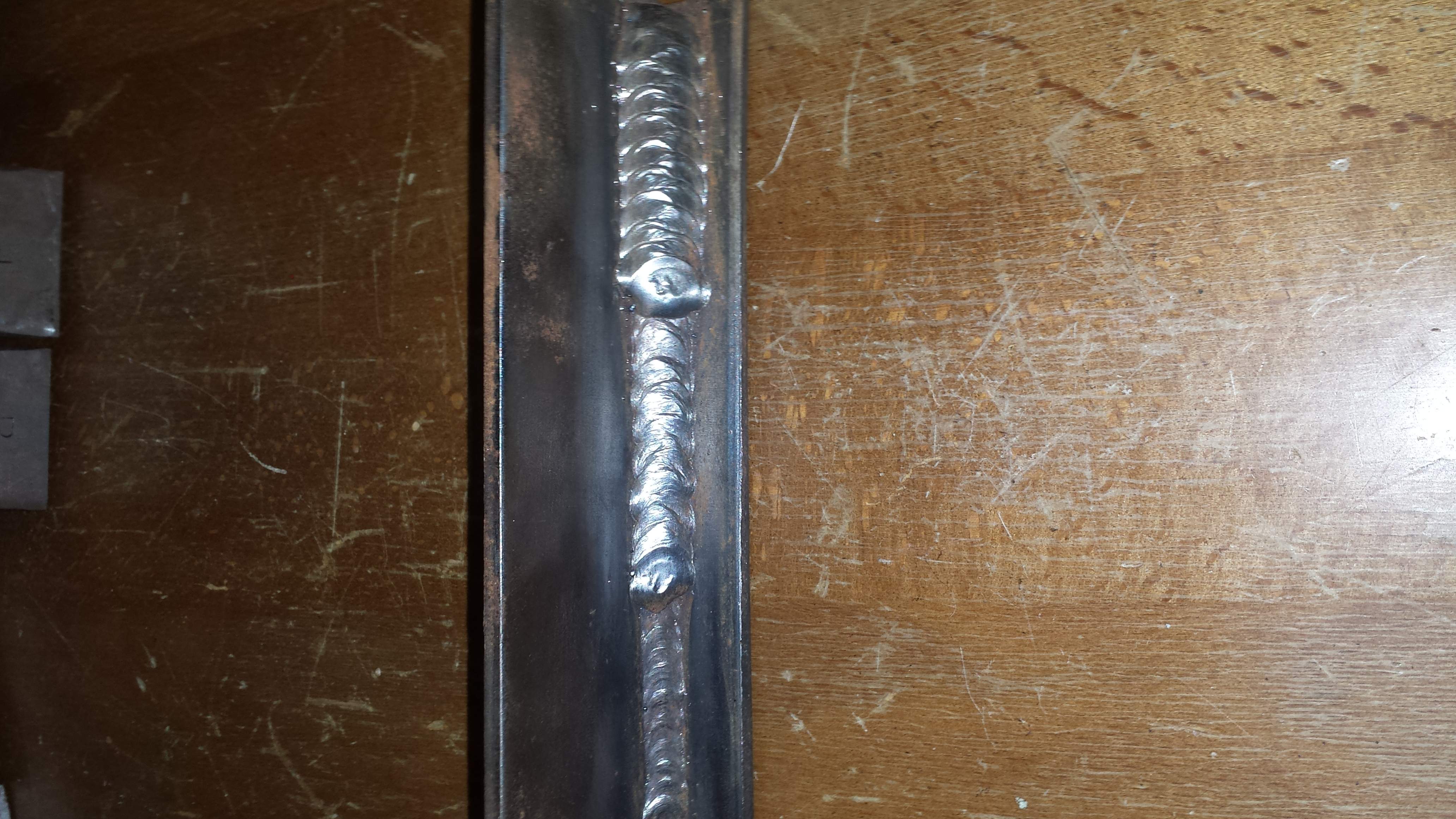

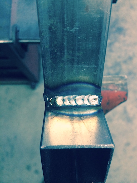

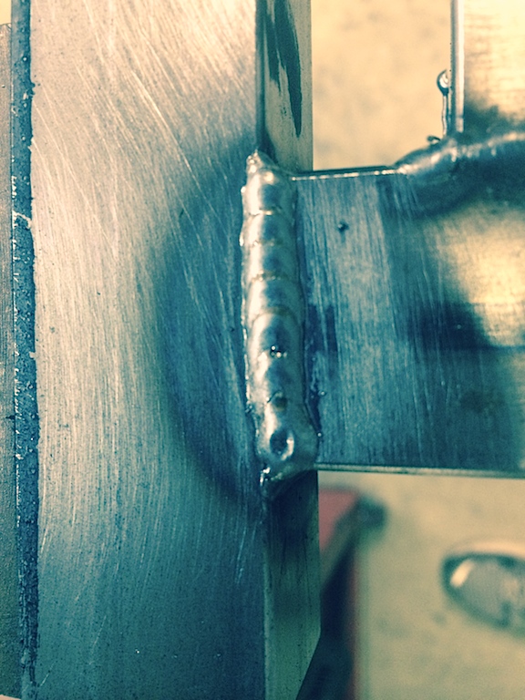

Sodo... thanks for the pulse idea. Played with that tonight and I am happy with the results. Used the 'inside the cover' settings and the pulse seemed much more forgiving than continuous on 16 gauge. Here are a few pics. Even with the pulsing, the second pic seems to suggest that I still got decent penetration. The third pic was pulsing a flat butt weld.

Dragon, the name I've heard weldors refer to that trick is "trigger welding" - like a lotta stuff, there're probably a dozen other common names depending on geography. If you wanna spend enough, the machine can do it for you.... Steve

Hey Steve... yeah had a lot of fun tonight triggering it. :D While I tend to purchase quality/capability beyond what I truly need... I have never regretted that. But that said... I think I can manually pull the trigger. :laughing:
