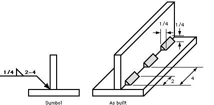

Stitch welding is what that is
In my experiences a "stitch weld" is like this.
It's a very normal style of welding.
But the "triggering" that's being shown is just overlapping tack welds - as I noted earlier, I only use them for thin rusty stuff or maybe car sheet metal repair. For normal welding I do not use this repeated tacking method.

One bad part about welding is that terms used in the US don't always match other countries.
For example, I've seen some foreign built migs that refer to tack welds as stitch welds.
But in common welding language, most people know tack mig welds as a single tack.
But with heavy welding a "tack" may be up to an inch long in some cases.
