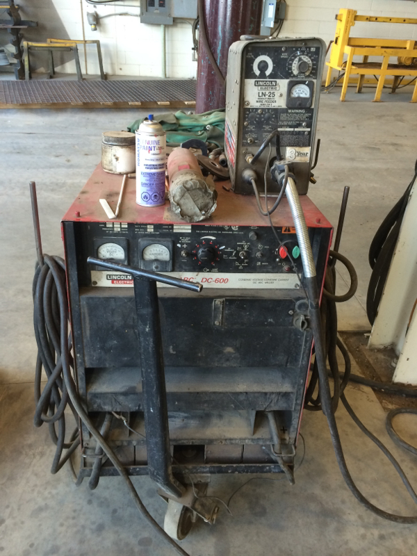

I have welded me a big thing or two and we have the big welder to run the heavy amp stuff but you don't always need 600+ Amps to weld tin or a bracket
