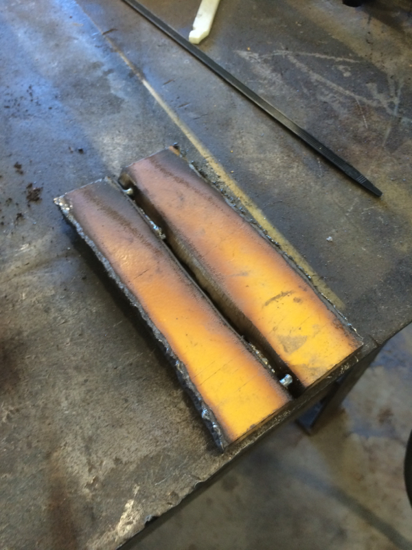

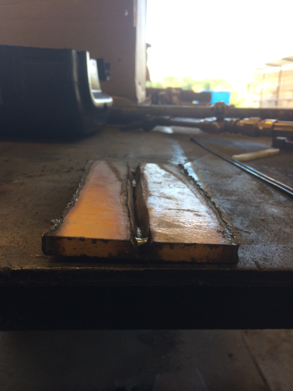

Did this quick today at work
3/8 with 45* bevel
Tacked and welded two passes then ground the root and welded one pass to bring it flush

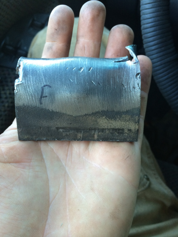

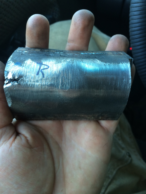

Root bent, can see crack developing in area of start, rest of weld looks good
No cracks at all in welded area but can see base metal actually starting to rip approx 1/4" above weld
