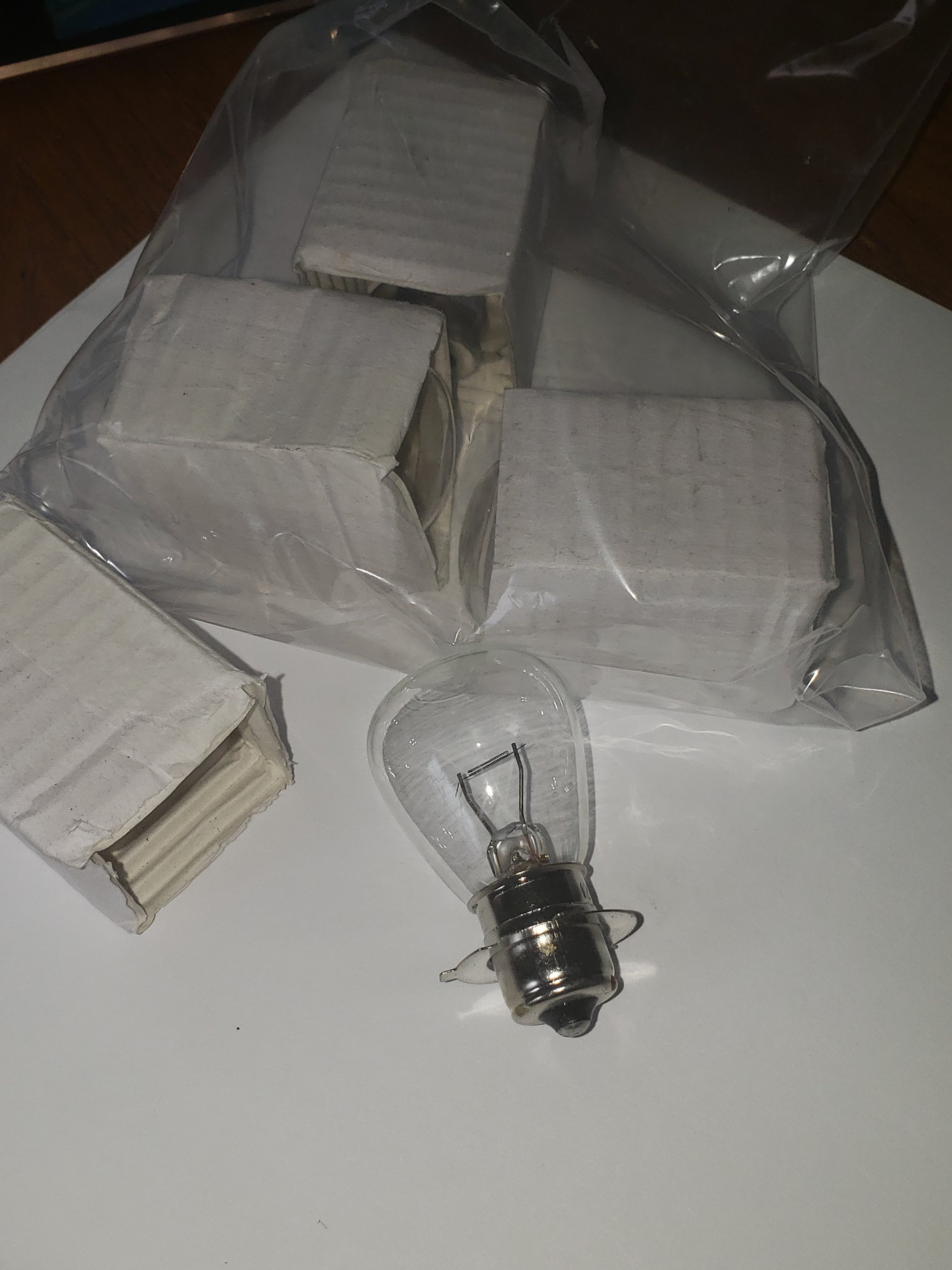

Well, time to check voltage regulator output and install some new bulbs! Hopefully riding around in the dark is a thing of the past!

I tripped over something that wasn't supposed to be laying on the floor while looking for the bag that held a new multi meter. Jammed my big toe, if not worse! Broke that brand new bulb that was in my hand! Went ahead and grabbed another bulb and installed it, then fired the little Ford up and went for a drive. It worked great! I drove around more than I did last time, when the bulbs blew and no issues, except only one fender light tends to make a lot of shadows!

The issue with your replacement is it is a two element bulb. Mine is a single element bulb. The PS039 doesn't match my bulb. That looks like a Hinomoto bulb? Mine has tabs on the outside of the circle that is soldiered to the base.

Single button, single filament is what came on it when I purchased it, and probably what came when new.
