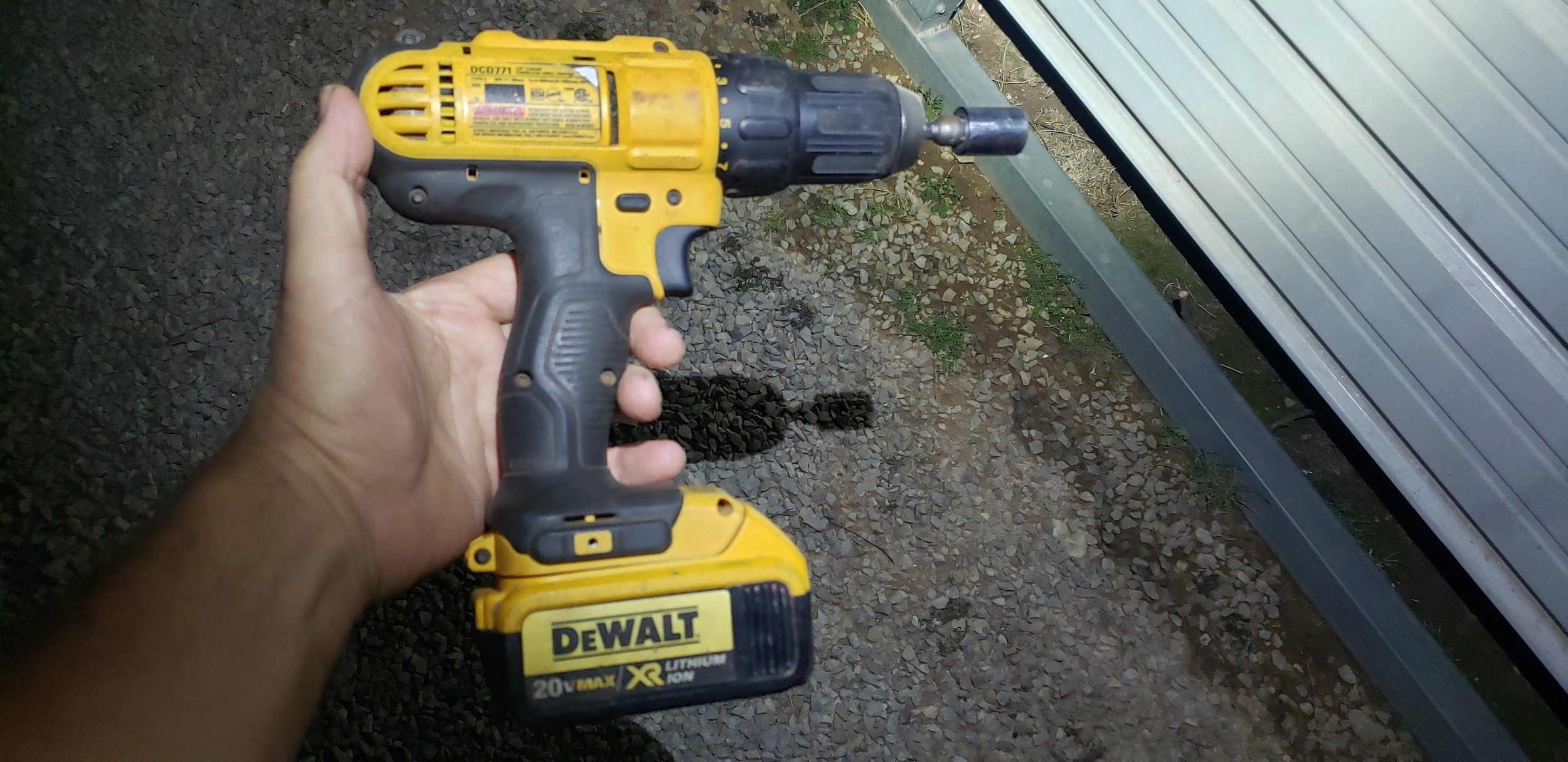

I think one of these adapters is the way to go. I constantly have DeWalt 60V batteries on charge and a drill in my tow vehicle, so I will always have the “power head” to crank the jack. Now I just need the adapter.
Kind of surprised nobody makes one. All the jack axle shafts are pretty much the same.

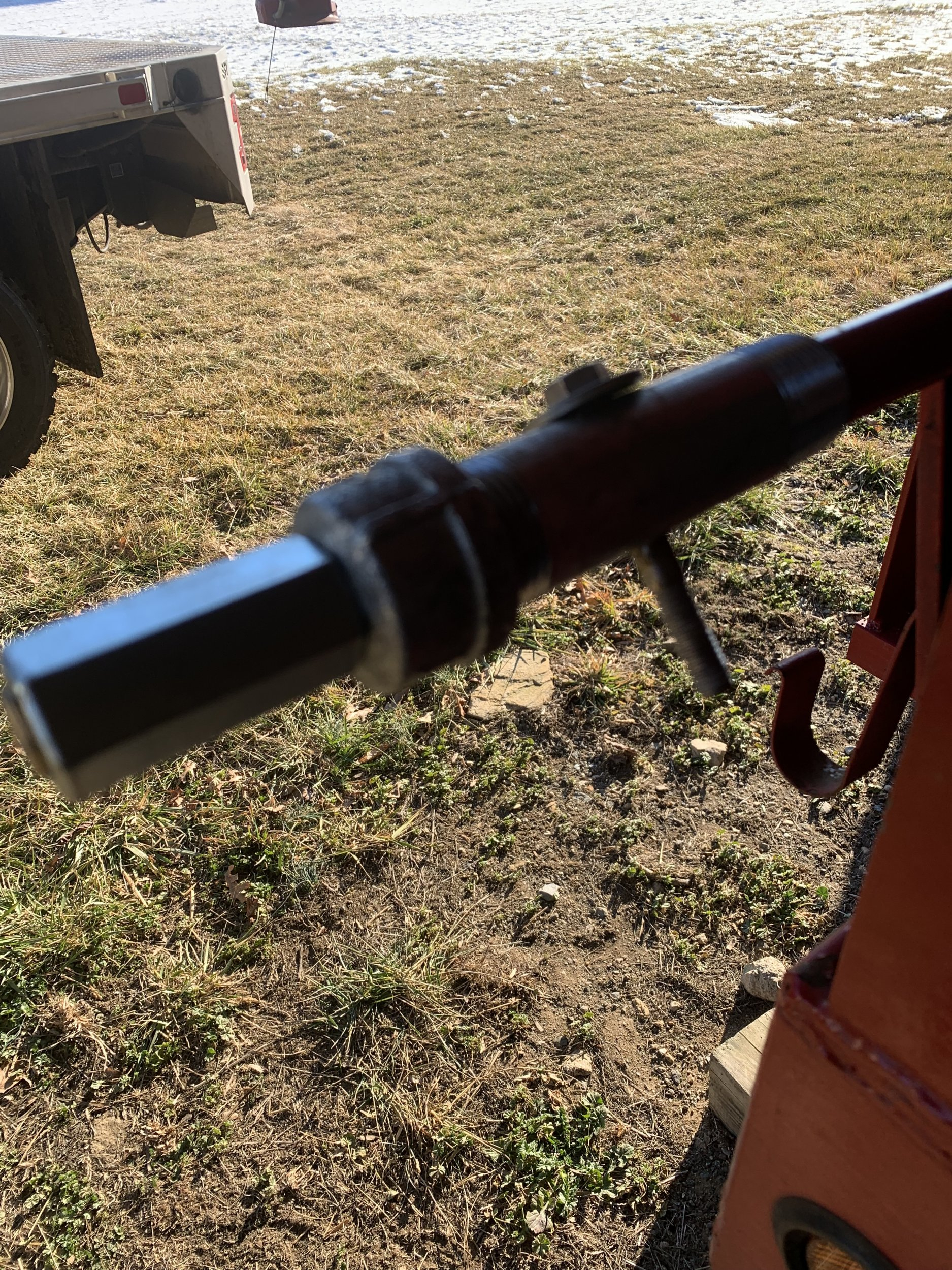

Made mine today.
Easy.
On edit, mine comes apart when drilling counter clockwise, so i am going to weld the coupling nut to the cap. Also, my 3/4” bolt head needed a little grinding to fit inside the 1” galv pipe cap.
I probably should have used 5/8”, but once welded, it wont spin anymore.
Thanks for the inspiration J Coastie

On my 25' fifth wheel, I welded a nut on years ago and used a drill for the landing gear. I recently acquired a 1/4" impact and the first time I used that, I twisted off the adapter. I just make sure I also have the right size socket and ratchet to do it by hand if this happens again after I've gone back to my drill.

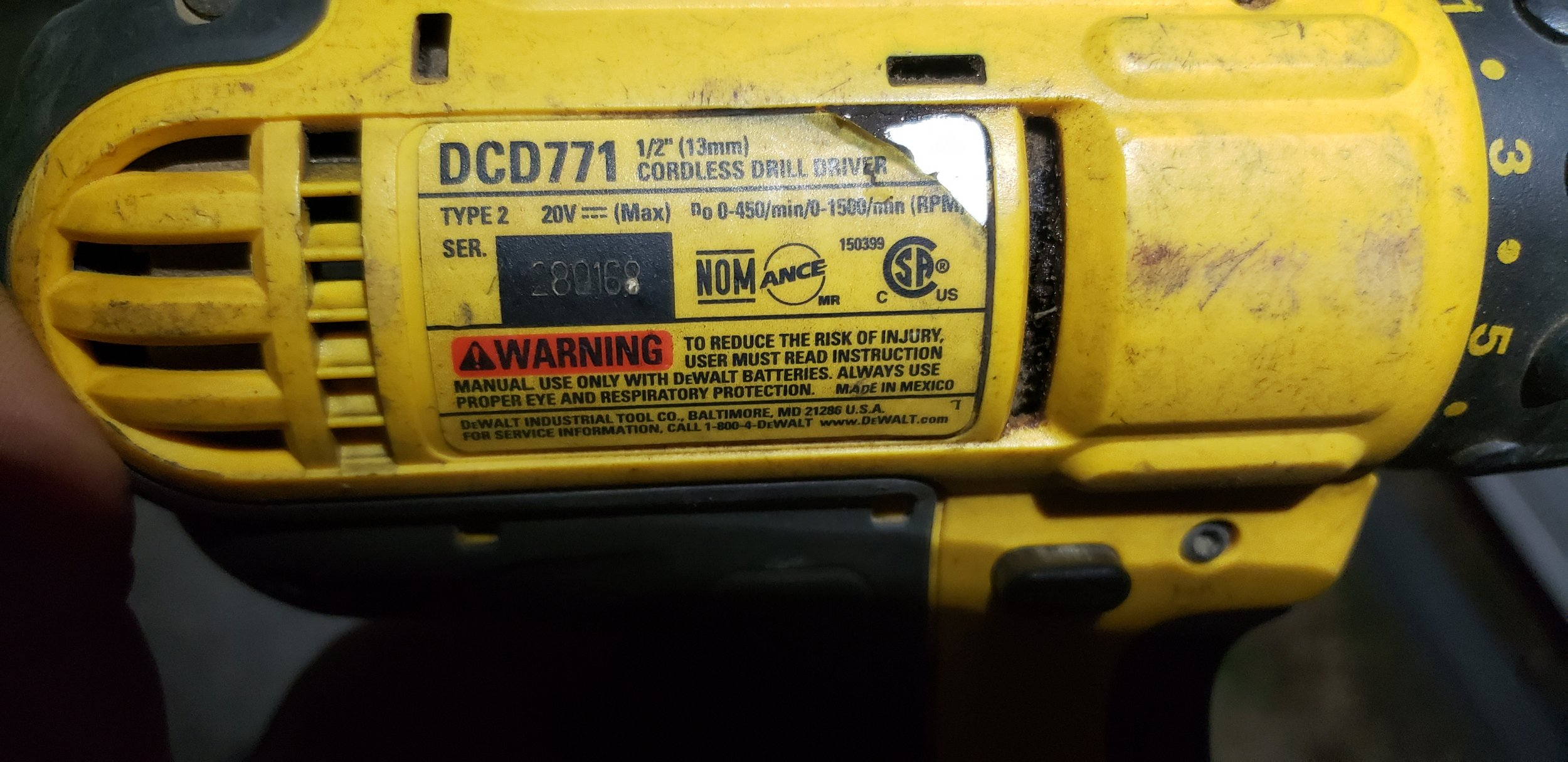

It shouldn’t take much twist to crank the jacks if you have a 2 speed setup

Did that come with handle? To prevent wrist twisting.
Yep. I just hold it easy and don't run it full speed.
