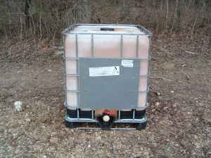

2manyrocks, this tank is so light that I got it out of the trailer by lifting it over the sidewall; I didn't have to mess with the tailgate. Putting it in/out the trailer is trivial.
In contrast I don't know if I could rassle an IBC tote into the trailer working alone. Installing my loader forks and driving around to the back of the detached trailer to lift the tote in would just add more steps, then navigating the tractor in the orchard leaving the forks attached (for unloading the tank later) would be a nuisance. I am trying to avoid a scheme with many setup/teardown steps.
I want to just toss the tank into the trailer without worrying about delicate underside fittings and go do some watering. The easier it is to set up this kit, the more practical it is to use it.
As for reliability of HF gear, this may turn out to be a project where HF stuff is used for a working prototype then commercial-quality gear is installed after the design is solid.
studor, putting the bilge pump in the tank is going to require some ugly butchery. I think I will cut three sides of a hatch and see if the material is pliable enough to lift the flap. If I leave the hinge near the end of the tank, I could make the opposite edge of the lid using a horizontal cut in that groove intended for the mounting strap. That way the lid would be self supporting.
As I described above, this kit will be easier to set up (and more durable) if I don't have delicate fittings and a support structure under the tank. Loaded weight is 1700 lbs which I think should lie flat on the trailer floor.

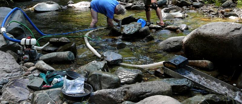

Is there some way to use this 50 psi from the utility pump as a jetting pump, ie pump water through a venturi, for example a little basement drainer that goes inline in a garden hose? That would use its pressure to multiply the volume of water moved. We use this principle in a suction dredge (gold dredge) that is powered by a 60gpm pump, but that unit's physics aren't right for this irrigation application. The gold dredge loses suction if the outlet is about one foot above the creek. See photo below.
Also my experience with foot valves on the various dredges I've owned makes me mistrust foot valves in general. They work fine for continuous running like in the photo. But I think in stop and start service, expecting a foot valve to hold a pump's prime would be a hairpuller. While this little HF utility pump doesn't move much volume, at least it will self prime every time. Maybe I should run it near continuous to replenish that front-loader tank from the trailer tank, and go back to simply dumping water on the trees.
