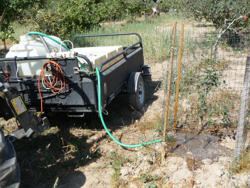

If anyone is still following this soap opera ...
I put clips on the tractor battery feeding an ordinary 3 prong outlet. Then I wired the pumps using 14 gauge PC power cords.
Volume is pretty good. The utility pump (threaded inlet and outlet) moves 4 gallons per minute and the bilge pump is double that. Moving up from garden hose to optimum size ( 1 1/8 for the bilge pump) should improve output, and might get the bilge pump's claimed 18 gpm.
My design isn''t perfected yet. I'm losing half a volt at the battery clips (and nothing is warm), a half volt in the 6 ft of PC cord and its twisted wires that the utility pump clamps to, and still another half volt when I put a 25 ft 14 ga extension cord in series between the battery clip outlet and the PC cord. So for the bilge pump I used wire nuts to connect it to its PC cord. This should have less loss. And at the battery I need to bolt the wires to the battery cable lugs.
After I got the bilge pump set up I took it for a test run. This pump fits in the 26 gallon (100 liter) tank, and it empties it in 3 minutes.
I hate to cut up the large tank to put the bilge pump inside. I may water from the front tank and use the utility pump to move water forward continuously while I drive to the next tree.
View attachment 127861 View attachment 127863 View attachment 127862

California -- if you switch the bilge pump hose to sump pump hose the volume will go up. I would use a heavy duty two wire trailer connector to connect the pump to the wire to the battery or even use lighter plug and wire in a lighter socket. In terms of putting a whole in the tank, see if you can slip the bilge into any kind of plumbing flange. I thought you might be able to use a hole saw to cut the tank and then have a finished "port" to put the sump pump into rather than just hacking a hole. The next thing is to get some five gallon buckets and make a series of 1/8" holes in the bottom. You put those next to your trees and fill them up to give your trees a more thorough watering.

Progress continues on the ultimate watering system.
I have a 200 gallon flat tank (maximum my 4x8 trailer will carry over rough ground) feeding a 12 volt external pump. This pump runs near continuous replenishing a smaller 25 gallon tank up on top, pumping continually while I am watering and while I drive to the next tree. Thanks Studor for the suggestion to use sump pump hose. I found some inch and an eighth hose off a pool filter which increased output of this smaller pump dramatically.
The top tank contains a fast 12 volt bilge pump. With 4 ft of drop, this dumps 15 gallons into each tree basin in less than a minute. (This is all the same hardware shown in the photos above.)
To distribute 12 volt power I applied stuff I already had - ordinary extension cords (14 ga), and multiple outlet strips for their integral switches. I still need to make a rational control panel.
The next step will be to locate the switches and irrigation hose where I can reach them without getting off the tractor. I also need to make a long watering wand from plastic pipe, so I can reach each tree from the tractor seat.
Thanks everyone for lots of good advice. This really works well.

Thanks! I have used this rig a number of times now, and it works great.
I eventually replaced this green output hose with 1.5" shop-vac hose to deliver maximum volume.
It takes about a minute per tree to apply 15 gallons of water.
Mission accomplished!
