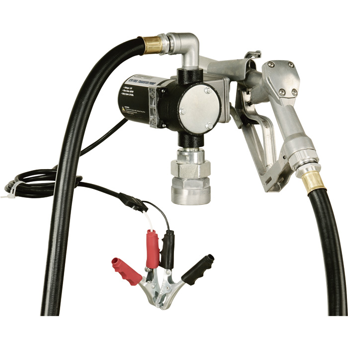

Ive recently acquired a 275gal tank that I am planning on using for offroad diesel storage.
I want to put inline particulate and water filters on it as well.
What are some good home usage 12v pumps?
I have been looking at offerings from GPI and Fill-Rite. Any other companies to consider?
GPI EZ-8 Fuel Pump
Fill-Rite SD1202G
/ 12v Fuel Transfer Pumps #2
I have been researching the same topic but for a much smaller tank. The consensus is you must have excellent filtering or you introduce very fine rust particles to your delicate fuel system and its important to keep your tank as full as possible to reduce both rust formation and water condensation. Users seem to hate the fill rite and gpi pumps with the same intensity. Go no go filters are rated very highly but are very expensive. If you are using a using an older steel tank, I would suggest 2 golden rod filters. Let us know what you end up using.

I bought the Fill-Rite SD1202G pump and a inline golden rod filter, the hydro (496) filter.
I may add on another particulate filter. The GR-496 says its only a 17 micron filter.
I might throw a highflow 10micron filter after it.

That's the same pump I have used for the past 15 years or so. At one time I had the same goldenrod filter (although non water block) followed inline by a spin on water block cartridge. I have since switched to using just the spin on water block filter.
The bowl filter lets you see the junk that it has caught, but I prefer the convenience of a spin on cartridge. I believe either of the goldenrod filters (water block or not) are 10u filters.
Do yourself a favor now and but an auto shutoff nozzle!
