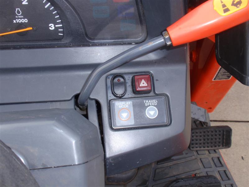

I hate to poke a hole in the dash.

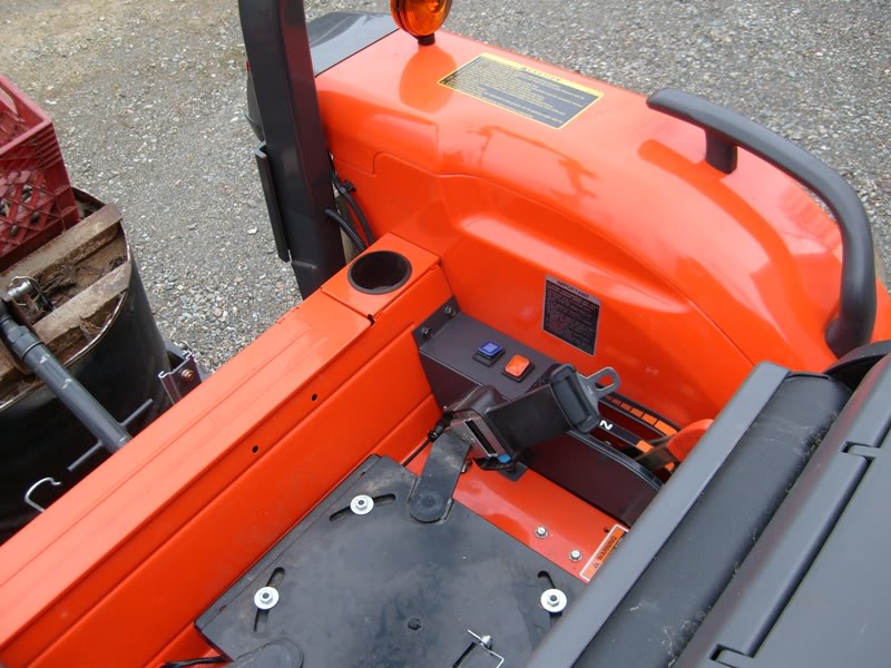

On my 4240 I mounted two switches in the steel panel that has the slots in it for the cruse control and HST Gear selector. I ran the power from the wire harness on the other side of the seat. I found some sealed rocker switches on ebay. I wanted something that was easy to reach and could be toggled with gloves on. I didn't bother with lighted since they are the only things in that area and I find that I can turn them on and off without even looking at them.
I went with this style of switch but one is blue while the other is green. That panel is easy to remove so I just drilled two round holes and then used a file to turn it into a rectangle.

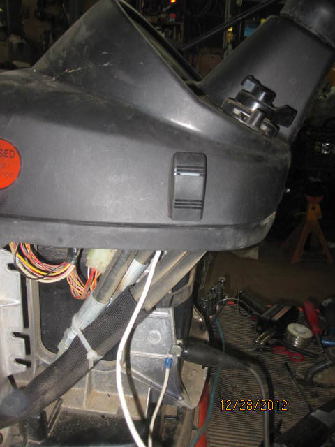

I started looking on ebay, but then found the same stuff cheaper from Digikey, and I trust them a whole lot more. Mouser too. Especially when I added up shipping, I bought 4 switches (1 to replace the dorman, and 2 new ones for my lights, plus a spare) and it came to like $10 including shipping. ebay was more than that for 1 switch.
I drilled a hole in the dash for the original Dorman switch and later enlarged it to fit the better one from Digikey. I don't have a photo of the new switch, but this gives you the idea. Same basic place, just a rectangular switch now.

Not sure when I took this picture but here's my switches.
I guess I used the orange switch not the green one. I got 4 different color ones.

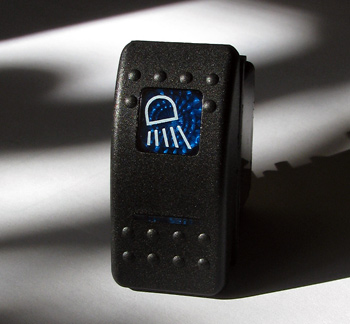

Look for a "Carling" switch.
I used a "Contura" for my LED install. They are Waterproof, marine grade. They are also the OEM for ALOT of the major tractor and boat manufacturers.
Not cheap (About $15 per, depending on model) but quality.V-Series: Contura II & III | carlingtech.com
You can also get the switches with function indicators:
I mounted mine to the dash:

Yeah.. I know exactly what you mean.. It was hard to cut the hole in my dash, believe me!! But in the end I figured it would be worth it, and it was!.. Even if I had to remove the switch at a later date, the whole plastic "dashboard" that I drilled into is only $30 to replace with a new one

I found the dash wasn't all that convenient that's why I mounted them behind the HST gear lever. Must easier to reach.
