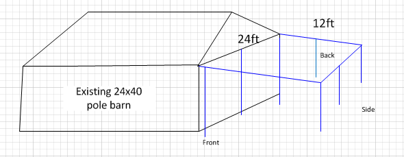

here is a rough sketch, the back and side could eventually be enclosed but for now i just want a roof. it will be used for tractor parking along with maybe an ATV, lawnmower, etc. i would like the roof sealed on the barn side so water would not leak down into it along the barn wall. i will only be able to get into it with my tractor from the front as clearance as no room around the back side due to a retaining wall and the a ditch along the "side". the high side will be about 9' high and the low about 7-1/2'.

OK, picture helps. Diagonal bracing is an issue. I assume you plan to put the posts in the ground below frost line, so that helps with diagonal bracing. If they're 6x6 that's probably enough to take the lateral load under heavy wind. But you probably still want to add something in the corners if you can, like either plywood or steel cable. Make sure to use hurricane straps to hold the rafters down.
For the headers I think double 2x8 with plywood core. You could also use metal. If you put 1/2" steel plate between 2x8s (called a flitch plate), that would really be a solid header. But it's a bit of a pain to fabricate. They probably need some bracing at the midpoints in the weak direction, could use wire rope from the opposite corners with a turnbuckle for that.
I think I'd use a heavy 2x6 ledge on the 6x6 under the header, and throughbolt the header to 6x6.

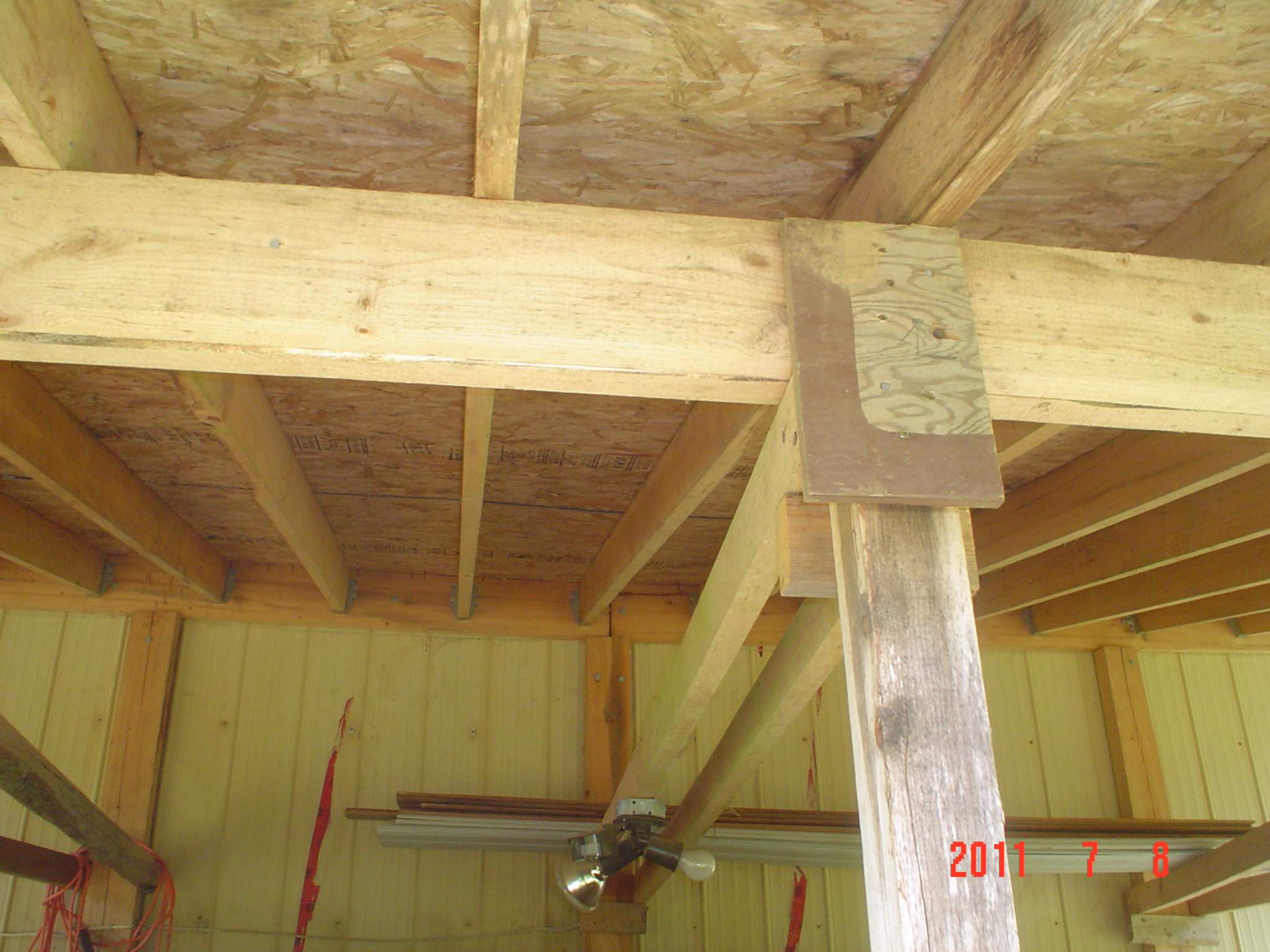

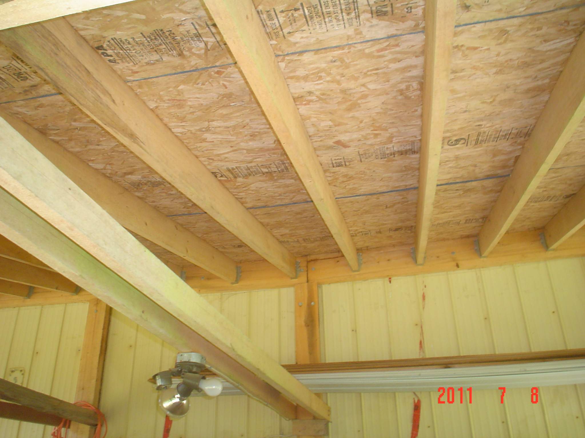

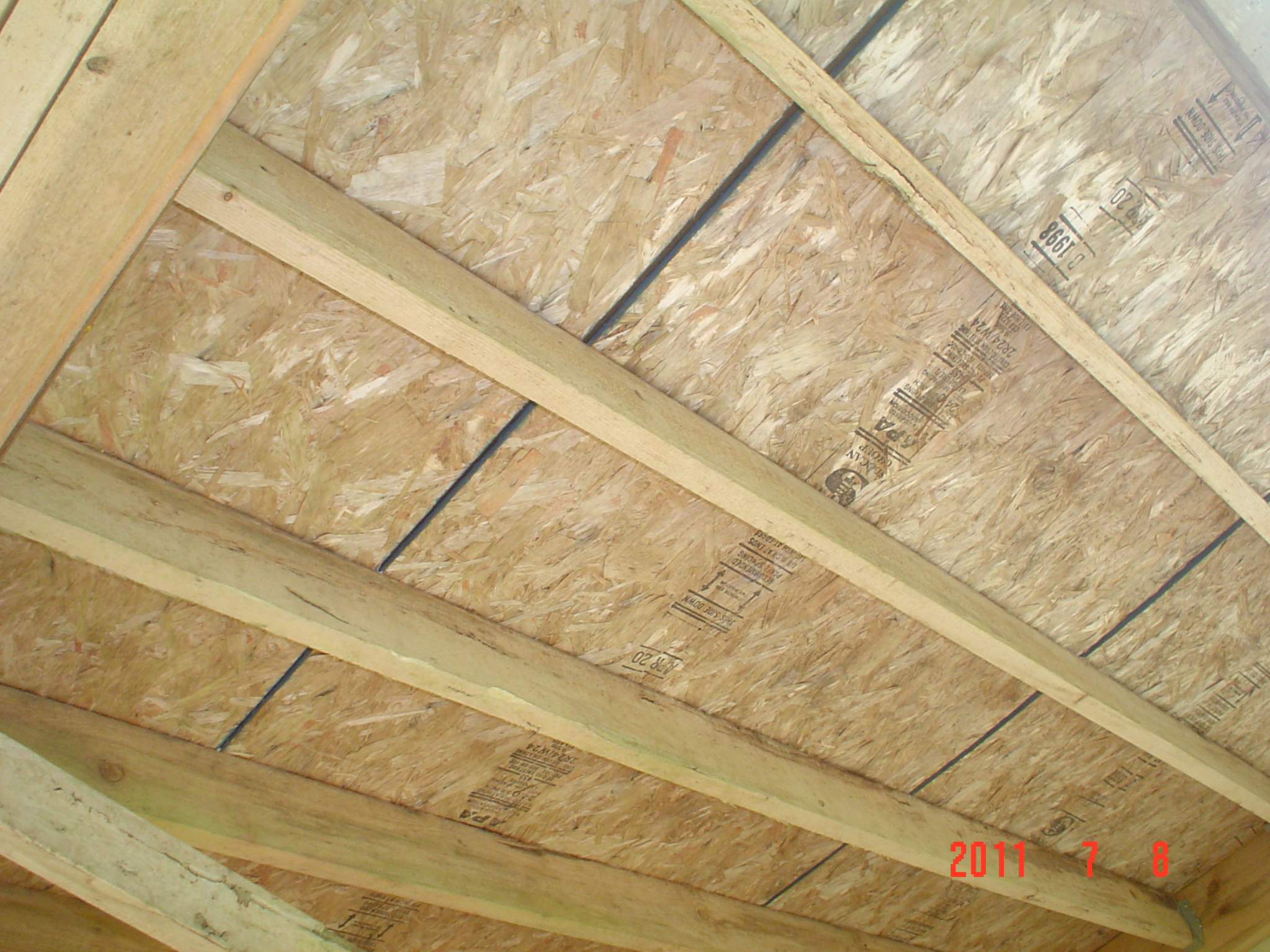

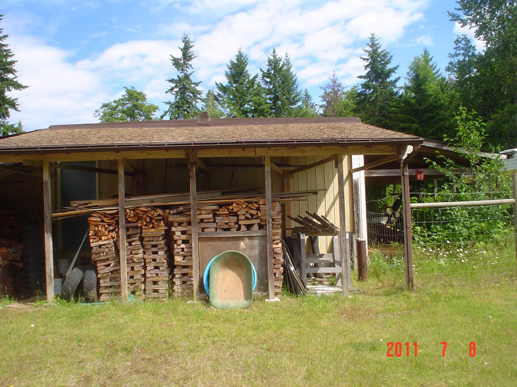

Built this 12 X 24 lean-to about 12 years ago. These are pics of it, it is on the back of a used double wide classroom I had moved to our property, use it as a shop and storage.
I also built two 12 X 40 lean-to's on both sides and a smaller 12 X 12 onto the back of one of the 12 X 40 lean to's. The lumber and posts were milled from our trees and the roof decking is OSB.
