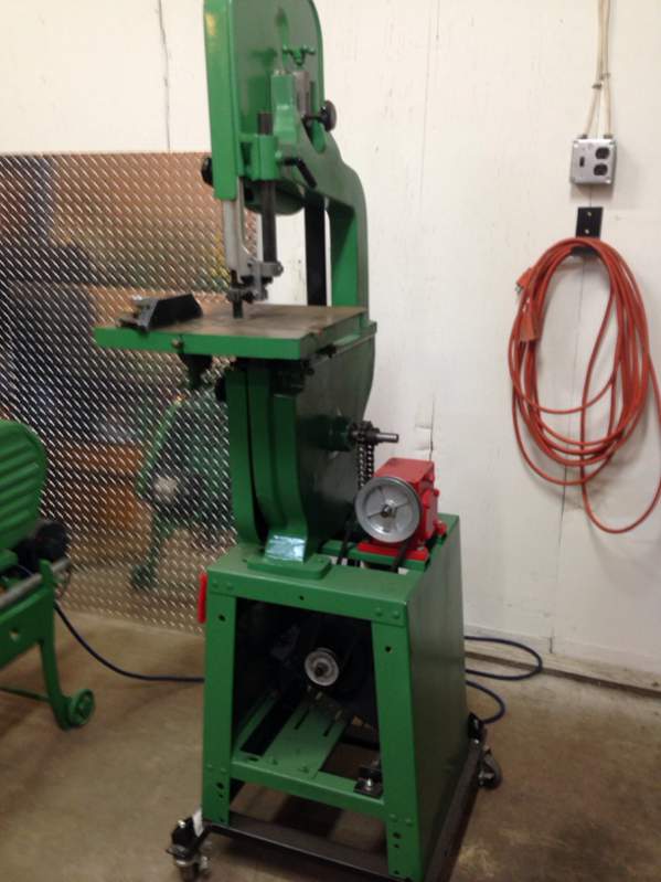

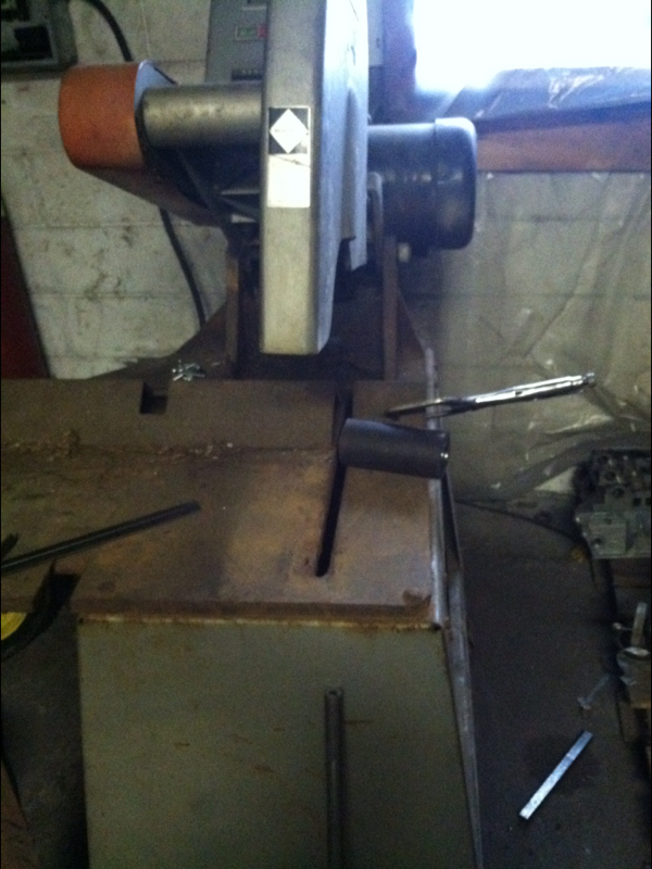

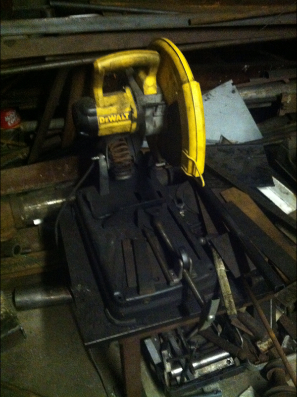

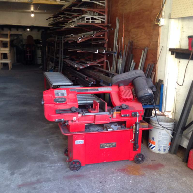

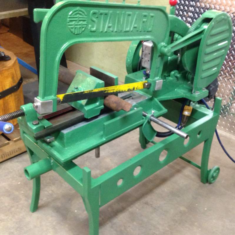

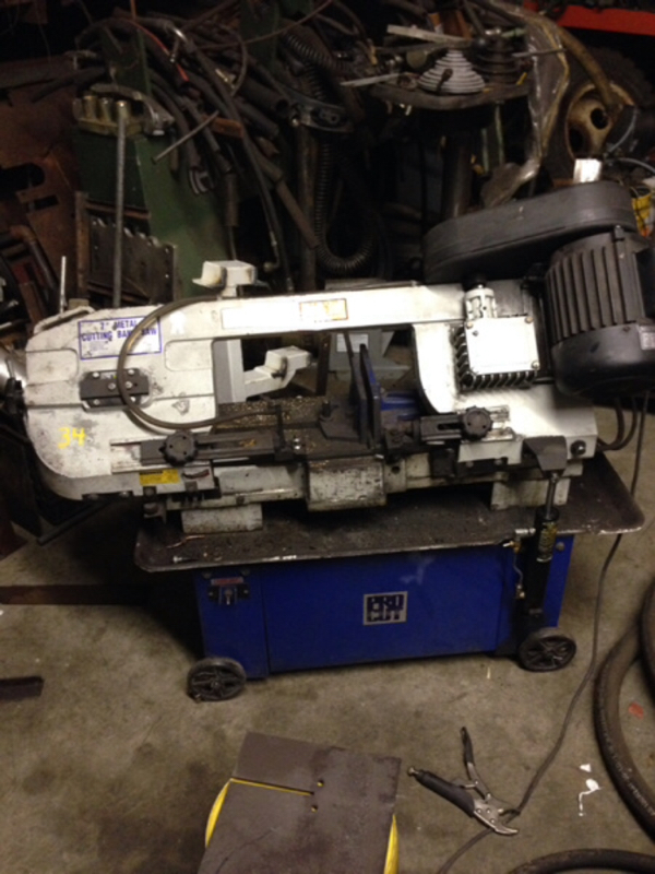

I have two abrasive chop saws and two metal cutting bandsaws. My woodworking tools are another story. I have 3 wood cutting miter saws and 1 wood cutting bandsaw. image-611522729.jpg image-1838485451.jpg image-4199023383.jpg

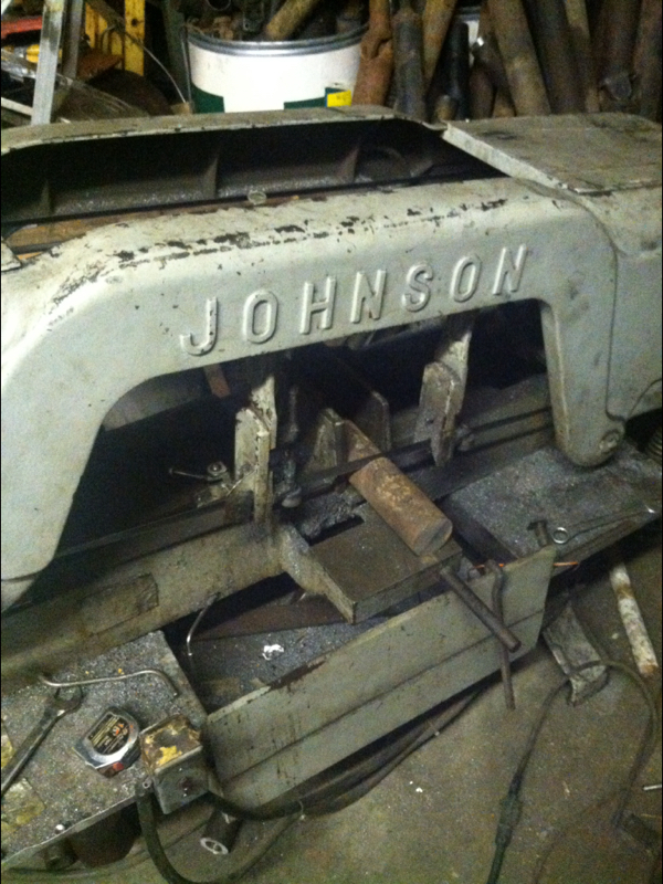

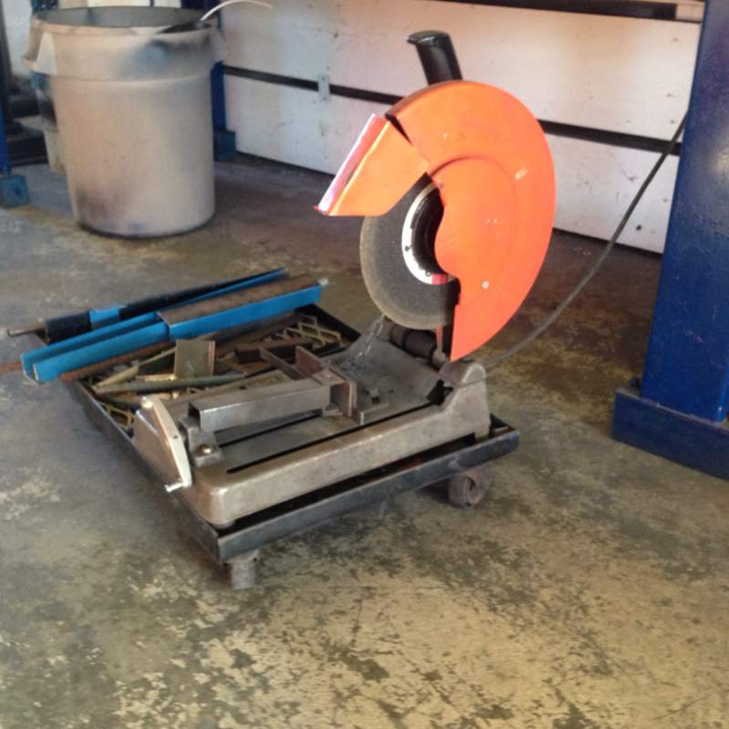

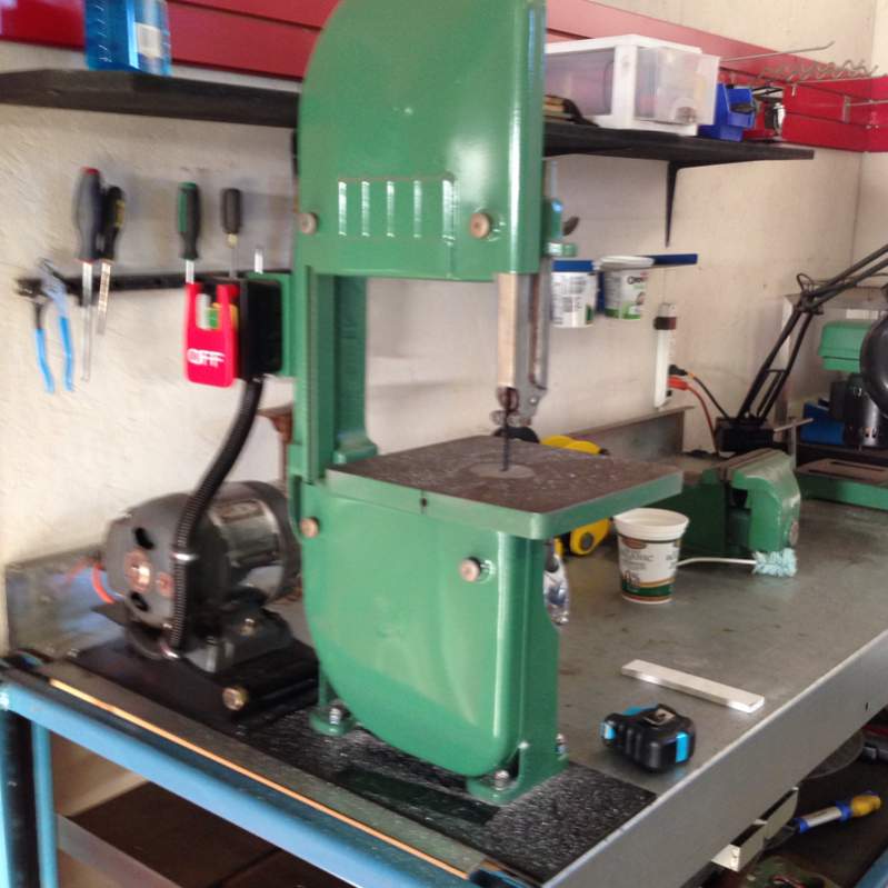

These are my other saws I use for metal.
: image-1086794266.jpg
