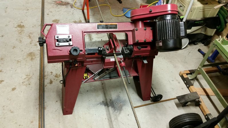

As others have said can't beat a Horz bandsaw. I've cut everything from 1/4" 3" square stock to rebar for a building I just formed and had the mono slab poured this week.
I grabbed one at HF on sale and used a 20% off coupon. Paid around $200...great deal.

As others have said can't beat a Horz bandsaw. I've cut everything from 1/4" 3" square stock to rebar for a building I just formed and had the mono slab poured this week. I grabbed one at HF on sale and used a 20% off coupon. Paid around $200...great deal. <img src="http://www.tractorbynet.com/forums/files/welding/447782-14-dry-chop-saws-any-cutting-rebar-jpg"/>

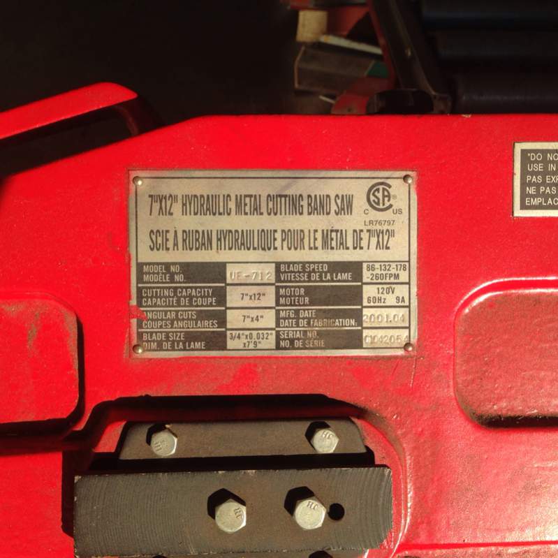

Paid $950 for mine in 2001. Still same price locally today :(
image-592176510.jpg Terry
