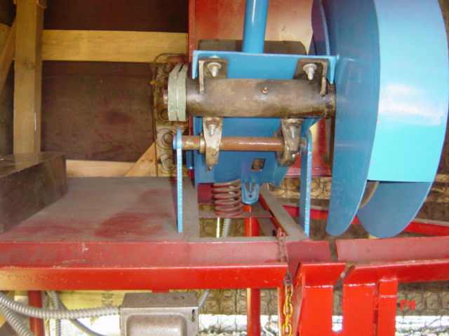

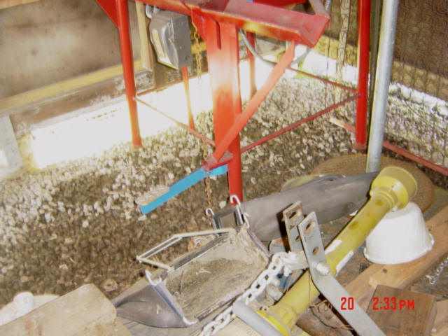

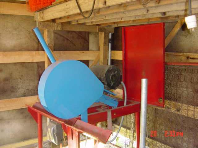

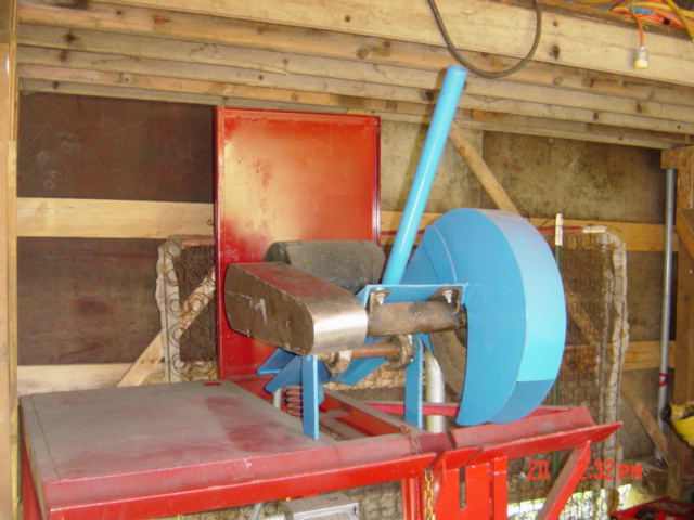

I built this 18-inch chop saw years ago. My dad had the mandrel, everything else except the blade came out of Sea-Tac airport, (old conveyors). 7 1/2-HP 3-phase motor. It will cut 3-inch solid round stock in just a few seconds.:cool:
Just bring it here and I'll get my 3 phase rotary converter built. :) Oh, bring your gantry crane at the same time :)
