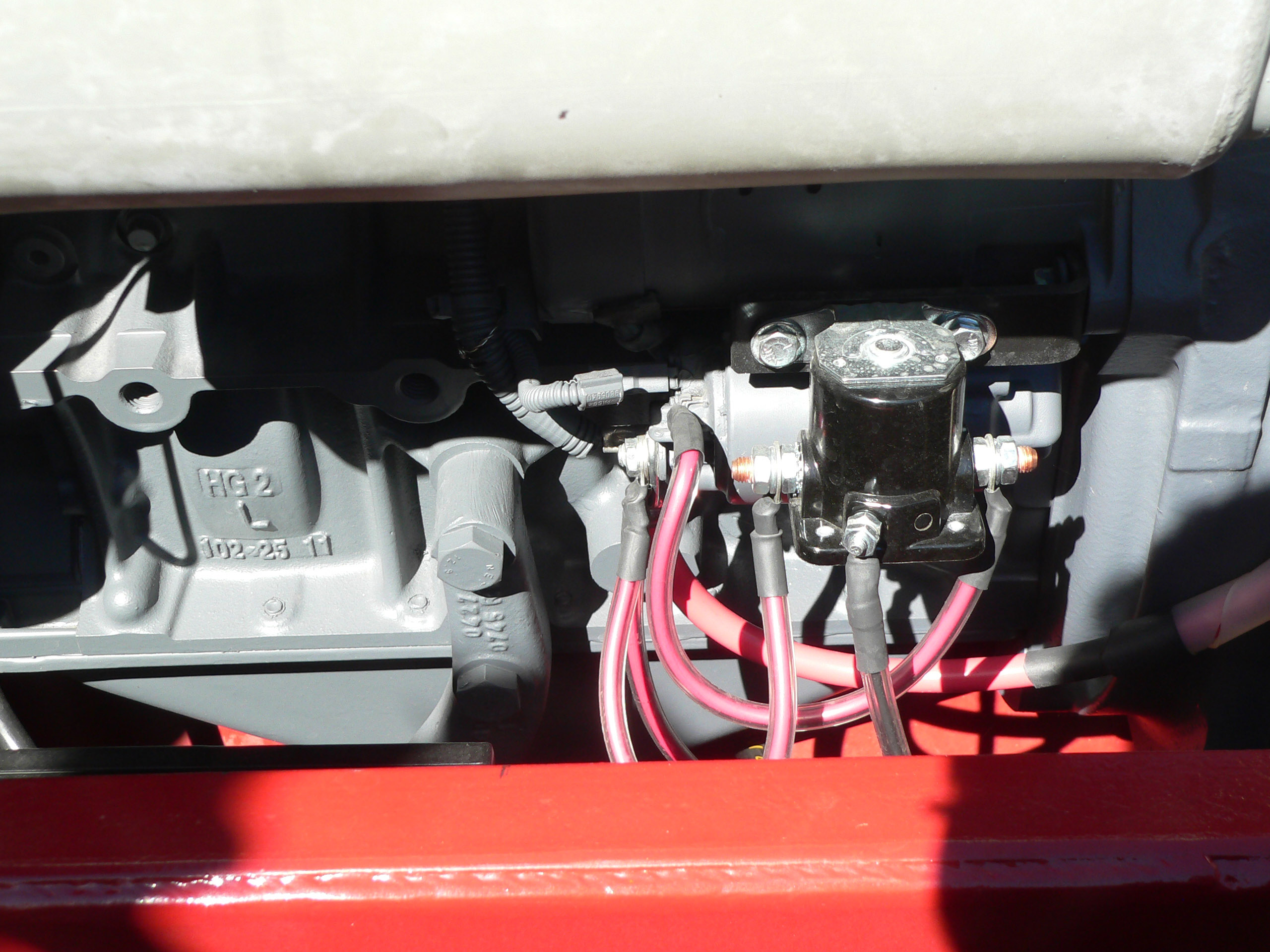

Cannot find a Ford solenoid anywhere. Battery cable goes directly to starter solenoid. Check all connections. All good .I do not get a click from starter solenoid... kind of like a thud when key is turned on. Getting 12 v to starter solenoid good also. Where is Ford solenoid located on 1430?

On my 1445, there is a second solenoid, to the outside of the Deutz starter.
As you can see, the main (+) cable goes to the Deutz, but the control wire (black in the photo) switches the Ford solenoid and the Ford solenoid then applies power to the Deutz solenoid to get it to switch.
Terry told me that the Deutz solenoid is very voltage sensitive, and the Ford relay was needed to get it to switch reliably.
If you don't have the Ford solenoid, I would carefully clean both ends of the (+) cable and see if that helps. If not, I would install one. It is cheap. There is a PT specific "L" bracket to mount the Ford solenoid that shouldn't be too hard to make.
