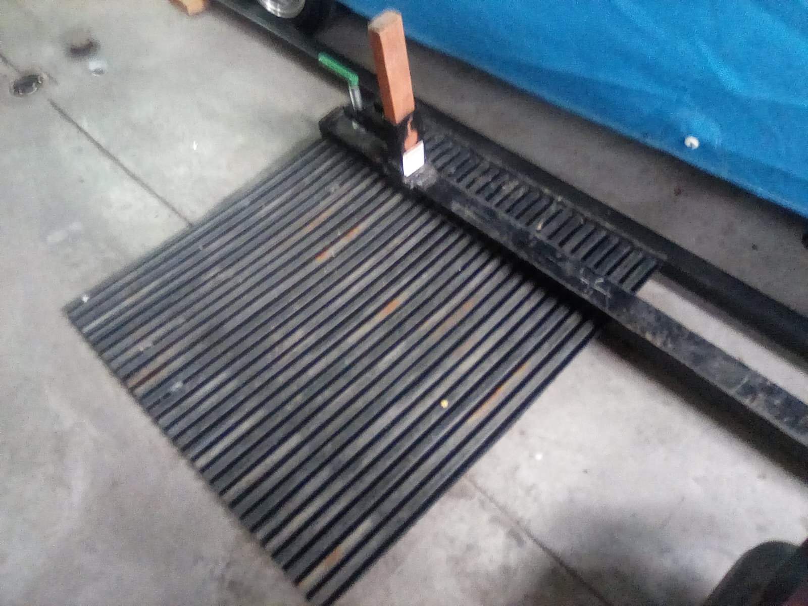

Disclaimer: This was not built to be a ROP in any way shape or form...

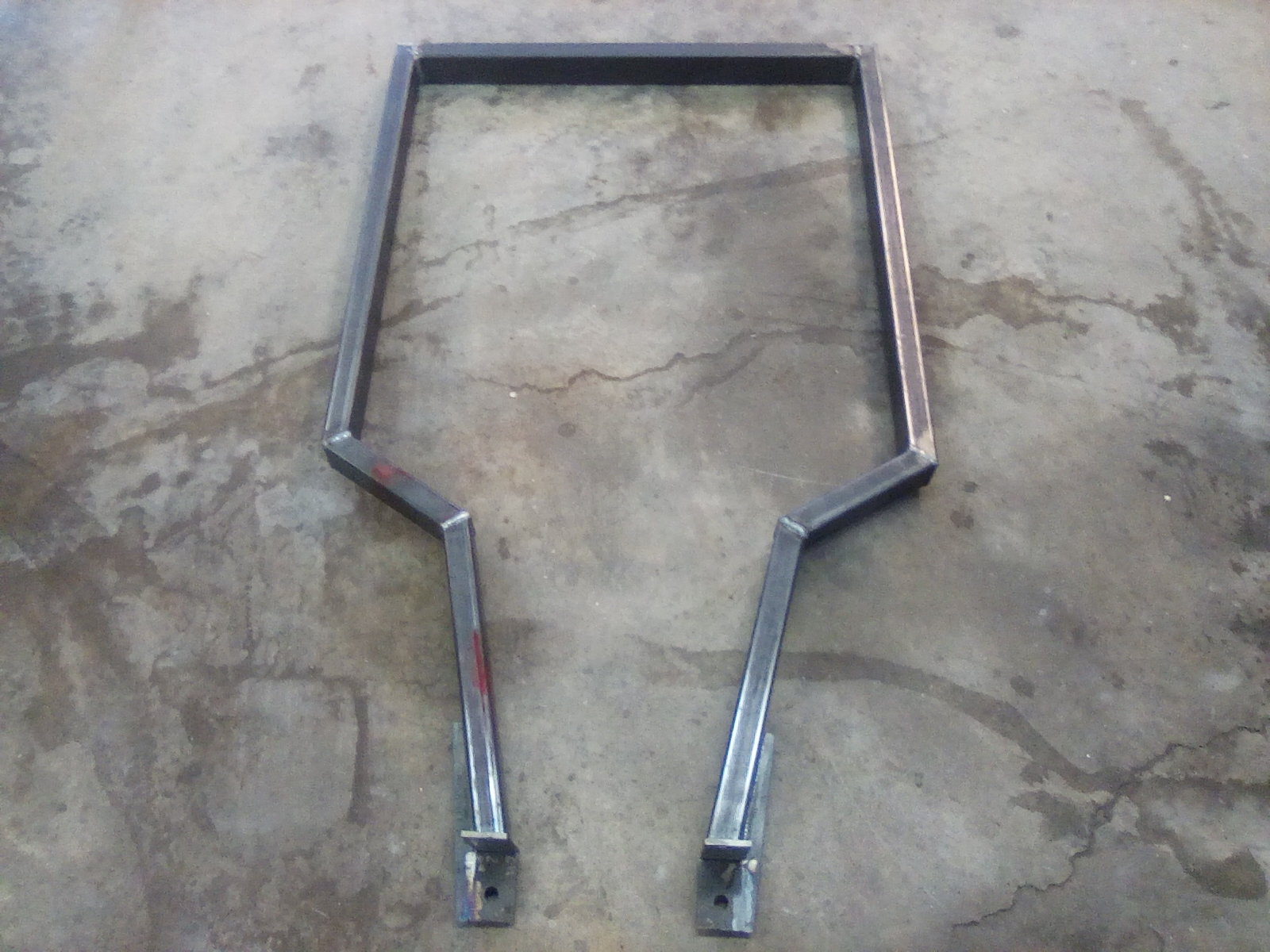

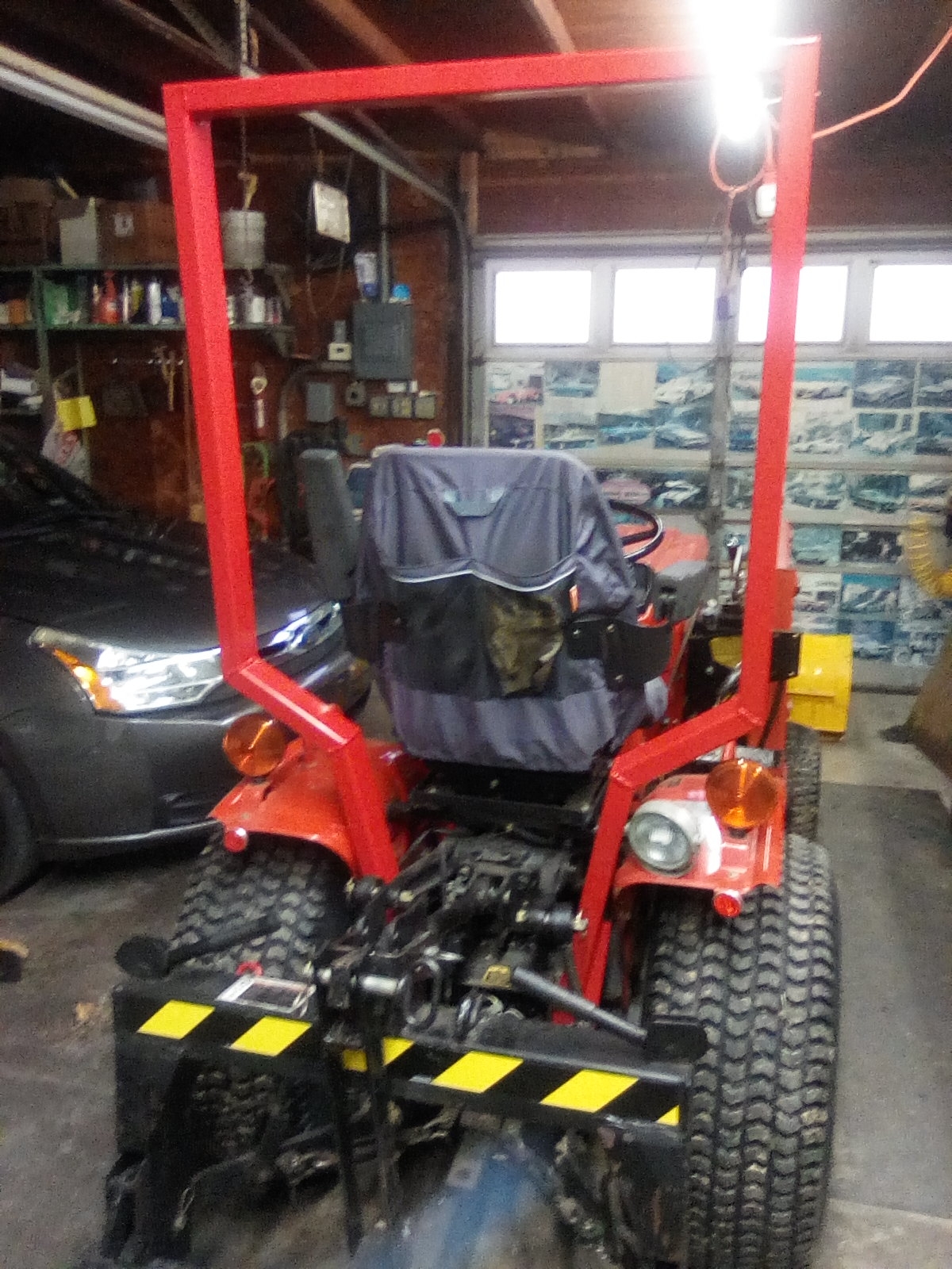

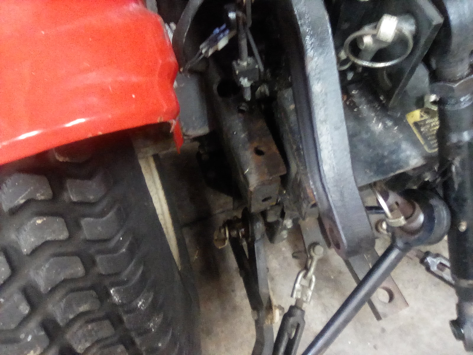

Want to get a canopy for sun and rain protection but had nothing to attach anything to. So went to work to make something up so I'd have somewhere to start. The tractor had mounting holes for the factory ROP.
Used 1 1/2x 2 1/2 x 11ga. tubing. Only size I could comfortably fit up thru and around fenders. Still haven't decided what I'm going to do for canopy but at least this much is done. Photos below..

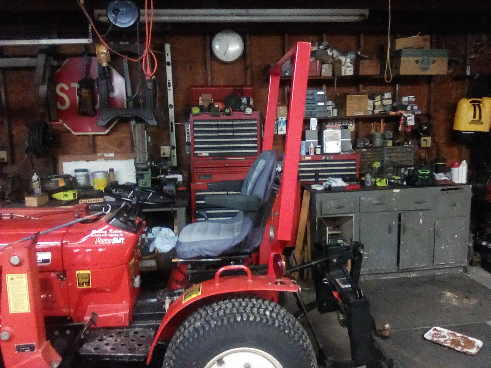

Side view..

That looks nice!! I like the idea of the canopy, I have wanted to make a canopy to fit my ROPS, and make one for my 155d, so I am interested on your next steps. Nice job and thanks for the pictures

I'm probably going to start making my own. Been looking at a few on line and at $250+ it make my decision a little easier. Biggest thing was what I was going to use for the top. I found a bottom out of an old bed liner I think will work. Trying to make this that it looks somewhat presentable.
Got the fork on top of it to take a little bow out of it.. ;)

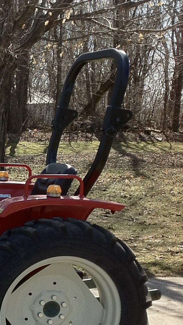

As for the folding down ROPS that is how my 2210d is set up from Fredricks. See attached picture, it is up right now, but can fold down. In the picture you can see where the hinges are at. I could make something work for this. As for my 155d I would have to do something similar to 4get gto did, except make the hinges too for the option to fold down.

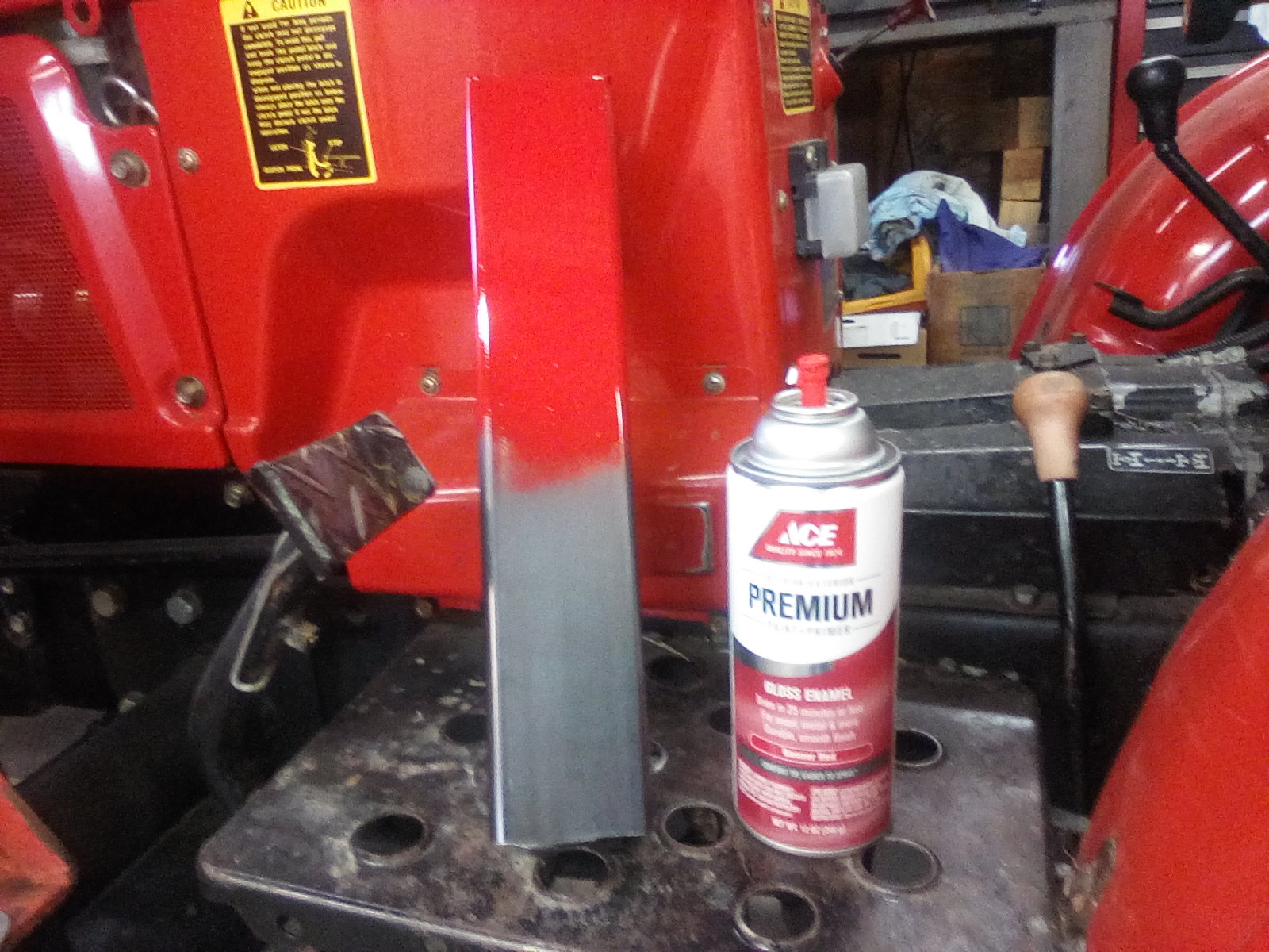

Got some side brackets made up to attach to ROP uprights. Next think is to figure what to go up and out to hold top in place.

No plasma cutter..
I have dimensional steel I'm using so I just got to cut to length.
Have them made up. I'll get some pictures in a bit ..:D
Nothing will be attached to the top horizontal bar..

These are the brackets that are pictures above with angles welded to them to extend out over the seat/steering wheel..Hope to have everything put together soon to get a better picture..

Now that I am looking at your other brackets I understand what you are going to do. Well paint those things red and find something to cover them with

Yep...waiting for paint to dry takes longer than making the darn thing..

Got the top on yesterday. The bedliner I used for the top turned out ok. I did have to add 3 /4" aluminum angle to the front and back edge as it wanted to bow in the middle a little. Everything seems like it should be good.
BUT... No sooner than I monkey'ed around for a 1/2 hour installing it and making all adjustments I thought boy what a pain in the butt that's going be if I want to take it on and off.
I'm not changing it right now but I think I'm going to cut the angles off that rise up to tubing that will slide into one another. Might make it more floppy but if the fit is right it shouldn't be bad if at all...
